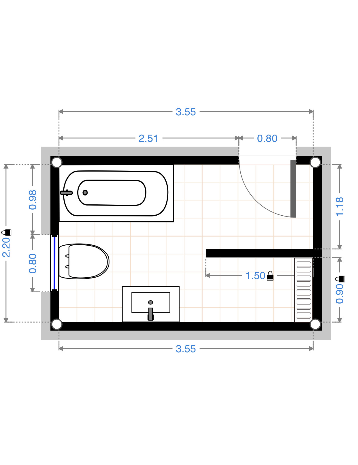

Olli-KaHello everyone,
our house planning is gradually taking a more concrete shape.
We’re still having some trouble figuring out the layout of the main bathroom.
Since all the main rooms will be on the ground floor, the bathroom is quite small (3.55 m x 2.20 m (11 ft 8 in x 7 ft 3 in)).
The following elements should be included:
The door should remain where it is currently marked.
The window could be shifted to the left or right or resized.
The interior partition walls are ideally made of glass and approximately 2 m (6 ft 7 in) high.
What do you think of this design?
Maybe you have some ideas or suggestions?
Oh, and it’s just the two of us, and there is also a small guest bathroom with a shower.
I have attached a draft for reference.
Thanks in advance and best regards,
Olli
- Walk-in shower
- Sink unit about 80 cm (31 inches) wide
- Bathtub
- Toilet
- Towel radiator
Olli

Osnabruecker18 Nov 2020 06:28With the small floor plan, you have made the most of it.
Definitely stick with glass walls, or the recently suggested option of a 1m (3 ft) wall with glass on top.
What is the purpose of the wall by the bathtub? I don’t see any reason for it.

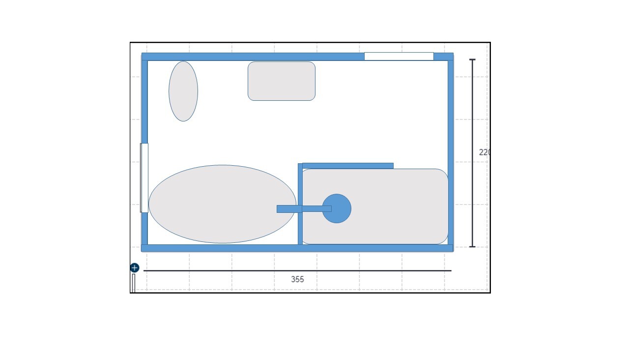

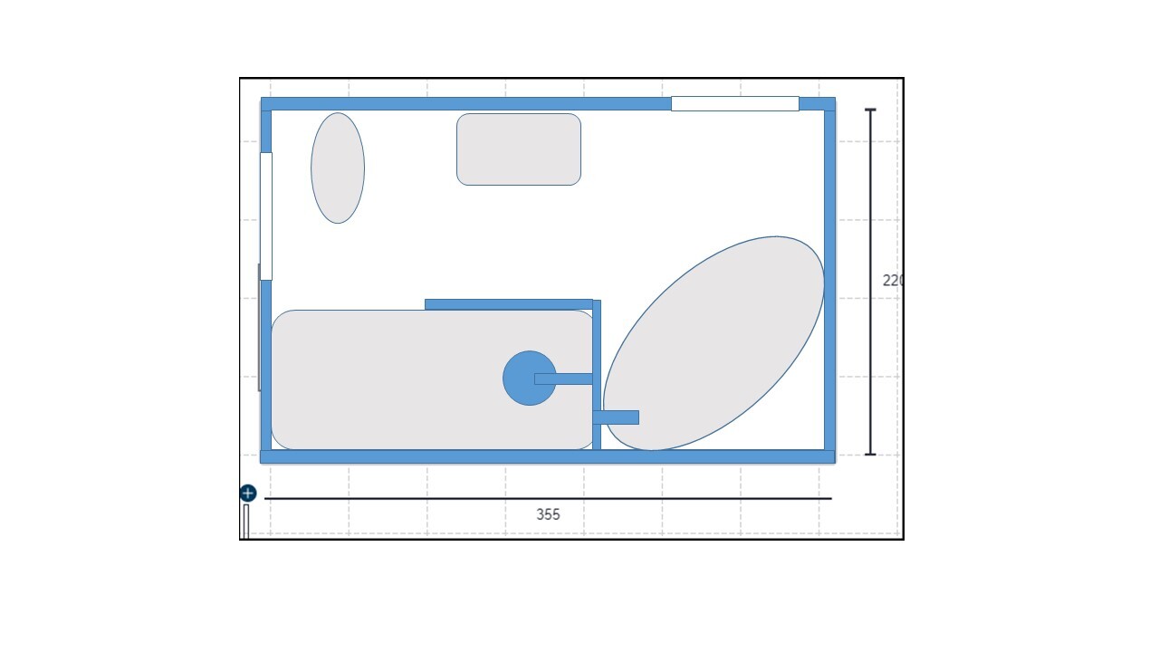

goalkeeper18 Nov 2020 11:29This could theoretically be another option. In this case, you could completely avoid using glass in the walk-in shower since you get direct daylight from the window behind it.
I would also avoid a corner bathtub. You have much less space inside compared to a regular one. This one here measures 1.80 x 0.80m (5 ft 11 in x 2 ft 7 in).
