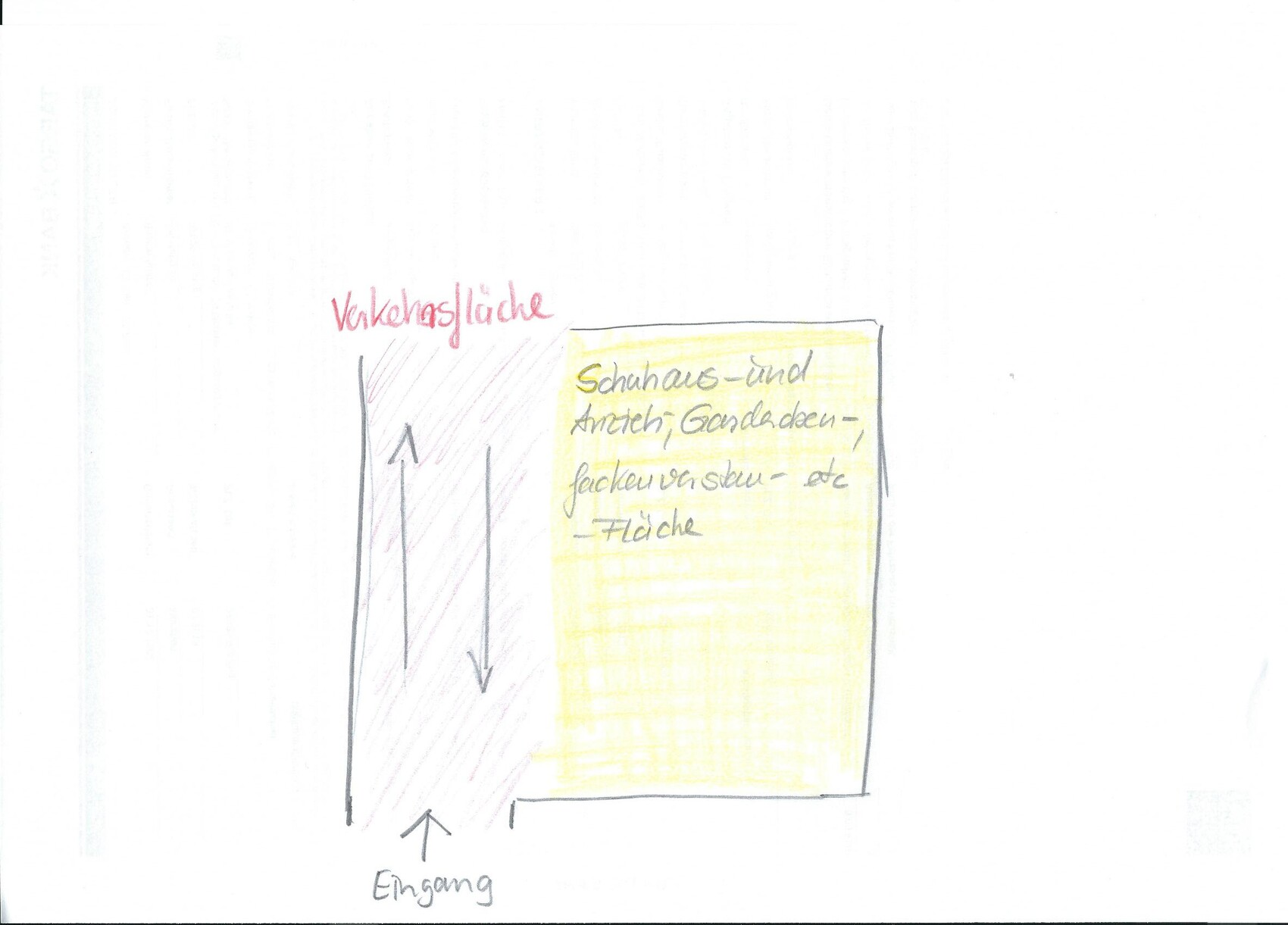

I’ll make a quick sketch of what I consider an ideal entrance area. Just a moment!

Here: for the ideal entrance area, there is a circulation space where two people can comfortably pass each other, and a separate area outside the circulation space where the wardrobe, shoe cabinet, and enough room are located to put on or take off shoes, jackets, hats, and coats without being disturbed by those passing by.
Grundriss-Skizze: linke Verkehrsfläche mit Pfeilen, rechts gelber Bereich, Eingang unten links.
Ideally, the entrance leads directly into the circulation space, while the “transition zone” remains quiet.
This is not always feasible, but this layout should be kept in mind.

If it’s just space next to the closet, that’s sufficient. As a hallway width, where everyone walks through and there’s a closet on the side, I find that too narrow. One person is just hanging something in the closet, another is kneeling down to take off shoes, and a third wants to pass through but can’t...
I’ll quickly sketch what I consider an ideal entrance area. Just a moment!
Yes, the wardrobe on our floor plan is a separate room. A 60cm (24 inches) wide closet should fit in there, leaving about 1 meter (39 inches) of space next to it for moving around, hanging jackets, putting away shoes, etc.
