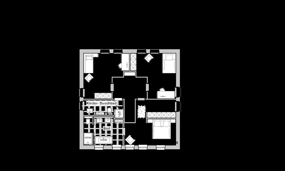

The awkward corner in the upper hallway is not very appealing (bedroom / office).
Furthermore, the hallway window was initially placed in the child’s bedroom, but that will be changed so there is natural light in the upper floor hallway.

- ideally no hallway obstruction on the upper floor

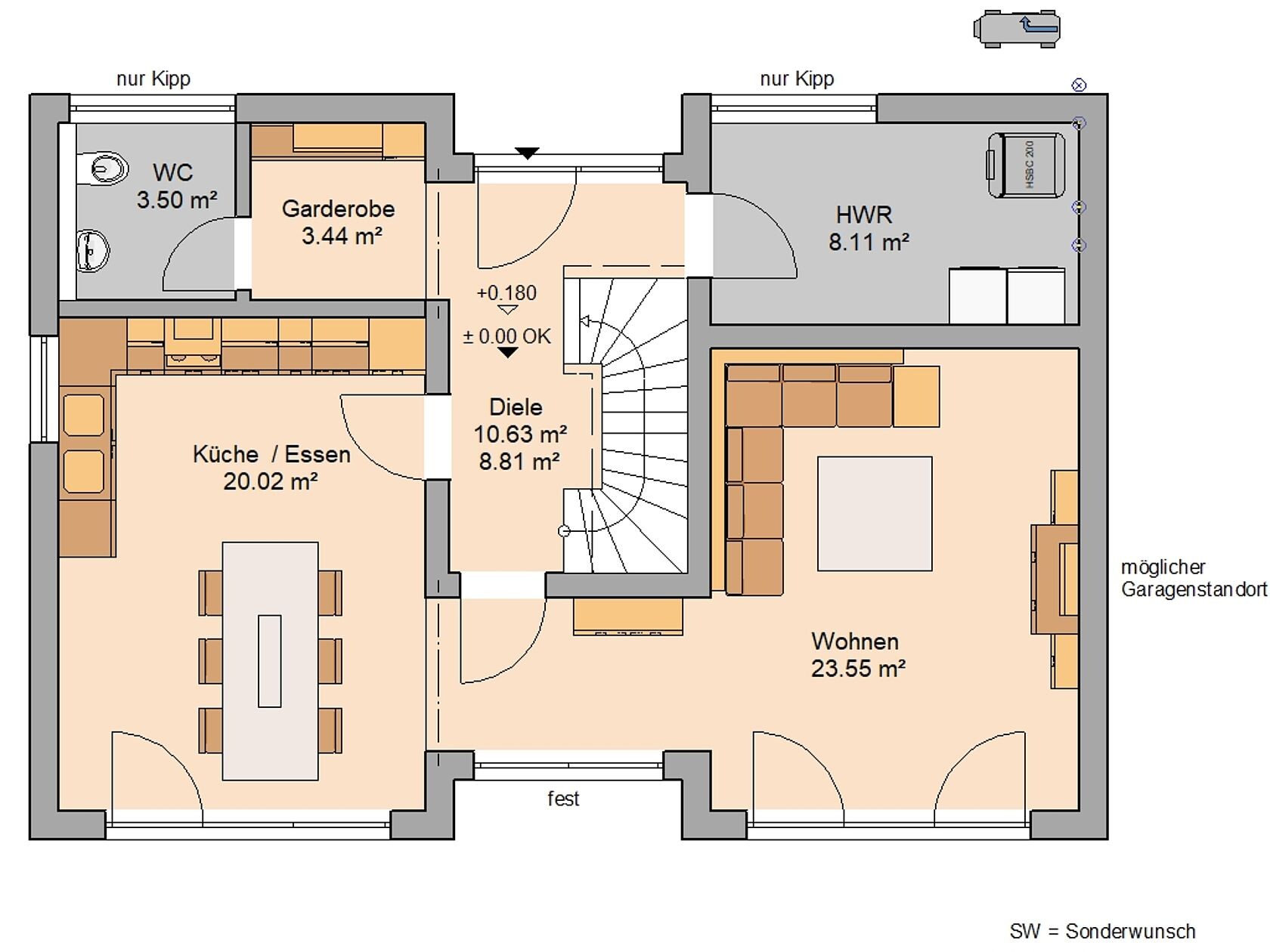

pagoni202014 Jul 2020 13:15ECE-2021 schrieb:
What do you think about these hallway areas?
This is a floor plan from a construction company.
It looks quite small. If I were the designer, I would have extended the hallway a bit so that you step directly onto the terrace as soon as you come through the door. Apparently, it was already built this way, but I definitely wouldn't have wanted that.
Looking at the hallway on its own, it’s passable. But based on your headline (a generous 200sqm (2,153 sq ft)), I would see it more as a bottleneck.
I don’t understand these recessed bay windows in this example either. However, the hallway works better than yours. When you enter the door, there is enough space to let others in. I would reverse the swing of the front door – when I come in, I’d prefer to enter the wardrobe area rather than the utility room.
Having the hallway straight ahead could work without a door, but I will never understand why the living area is artificially narrowed by this recessed bay window.

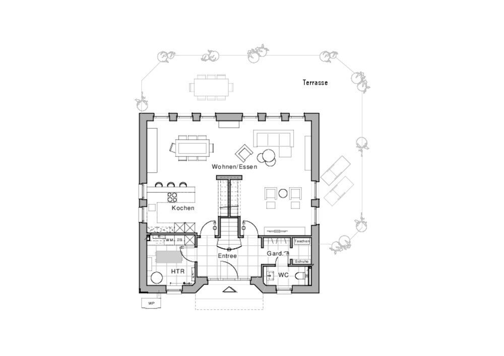

Scout schrieb:
How to design a straight staircase in almost your entire exterior dimensions (here 10.6 x 10.6 meters (35 x 35 feet)) is demonstrated by Viebrockhaus. It’s definitely worth experimenting with...Yes, it looks good, but isn’t that impossible with a basement staircase, or did I miss something?Similar topics
