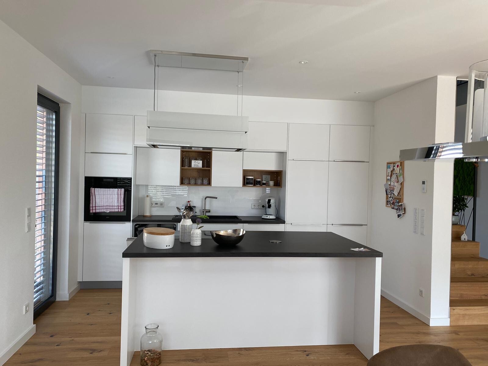

Alessandro14 Jul 2020 10:07haydee schrieb:
Please don’t criticize my luxury. I stand by my IKEA cabinet and tube TV.By the way, the kitchen in the photo is from our current rental apartment and it’s an IKEA kitchen (except for some appliances). I don’t think you can tell just by looking at it. So, nothing against IKEA.
But of course it’s true that the kitchen in the house will be a high-quality one.
