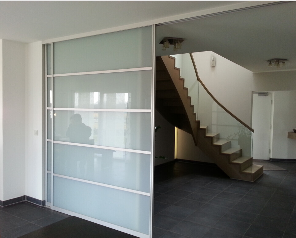

Yes, we also have some concerns, but there will be a roof window measuring 78x160cm (31x63 inches) in the stairwell, next to the door is a 40cm (16 inches) wide glass element, and the kitchen door should let in the southern sunlight because it has a lot of glass area.
Another idea was to have a narrow floor-to-ceiling fixed glass panel between the living room and hallway, but can we just plan a door there instead?

I was thinking of a solution more as a room divider with both sliding panels movable; the same can be done with three panels, where two can slide behind a third, creating an even wider opening:
