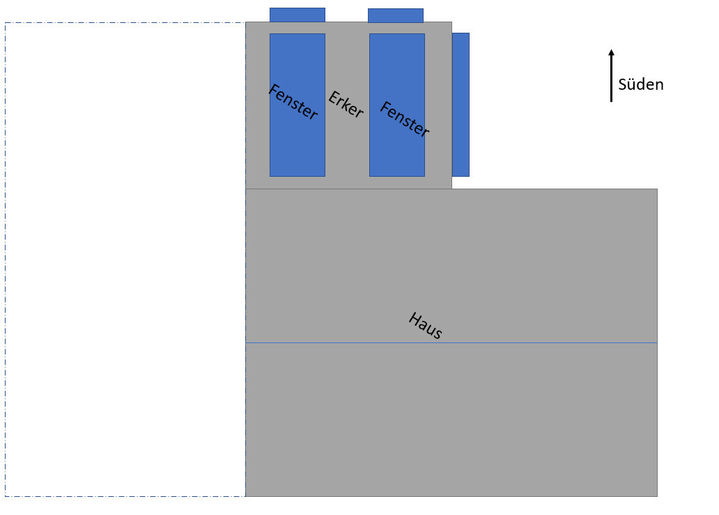

We have planned a "bay window" in the living room with two large roof windows measuring 220cm (87 inches) wide by 100cm (39 inches) high, So, two roof windows, each 220cm (87 inches) wide and 100cm (39 inches) high, installed on the ground floor in a roof recess – and below that, facade windows in the knee wall?
(The more I misunderstand this, the more it seems useful to illustrate it with a drawing.)
All right, here is the drawing attached.
Does this help?
- The bay window faces south towards the garden
- To the east (left) is the other (identical) half of the house
- On top of the bay window are the two discussed windows, directly below on the south wall are 2 windows, and to the west there is a patio door (all of which are shaded with roller shutters)
Does this help?
