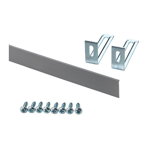

Strahlemann-691 May 2016 00:05Hello, use the installation manual for an IKEA oven as a guide for the installation.I just noticed that I don't have the strip shown in the PDF...
However, I have to admit that I am reinstalling a NEFF oven that was already built in on the upper floor into the ground floor. Maybe it comes with such a strip.

IKEA-Experte3 May 2016 14:00To avoid misunderstandings, the two linked articles are only covers for cut edges to close off shortened drawer fronts (used as filler panels).
Of course, the oven can also be installed at a height of 50 cm (20 inches), but then a 10 cm (4 inches) drawer panel must be used both below and above it.
