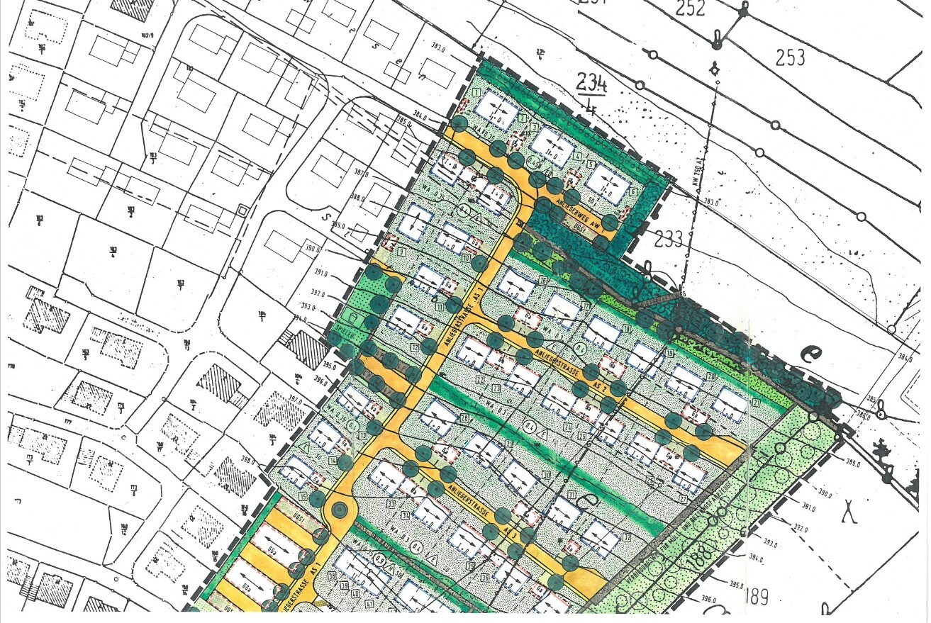

modderDevelopment Plan / Restrictions
Plot size: 606m² (6519 sq ft)
Slope: slight north-facing slope (3m (10 ft) over 34m (112 ft) length)

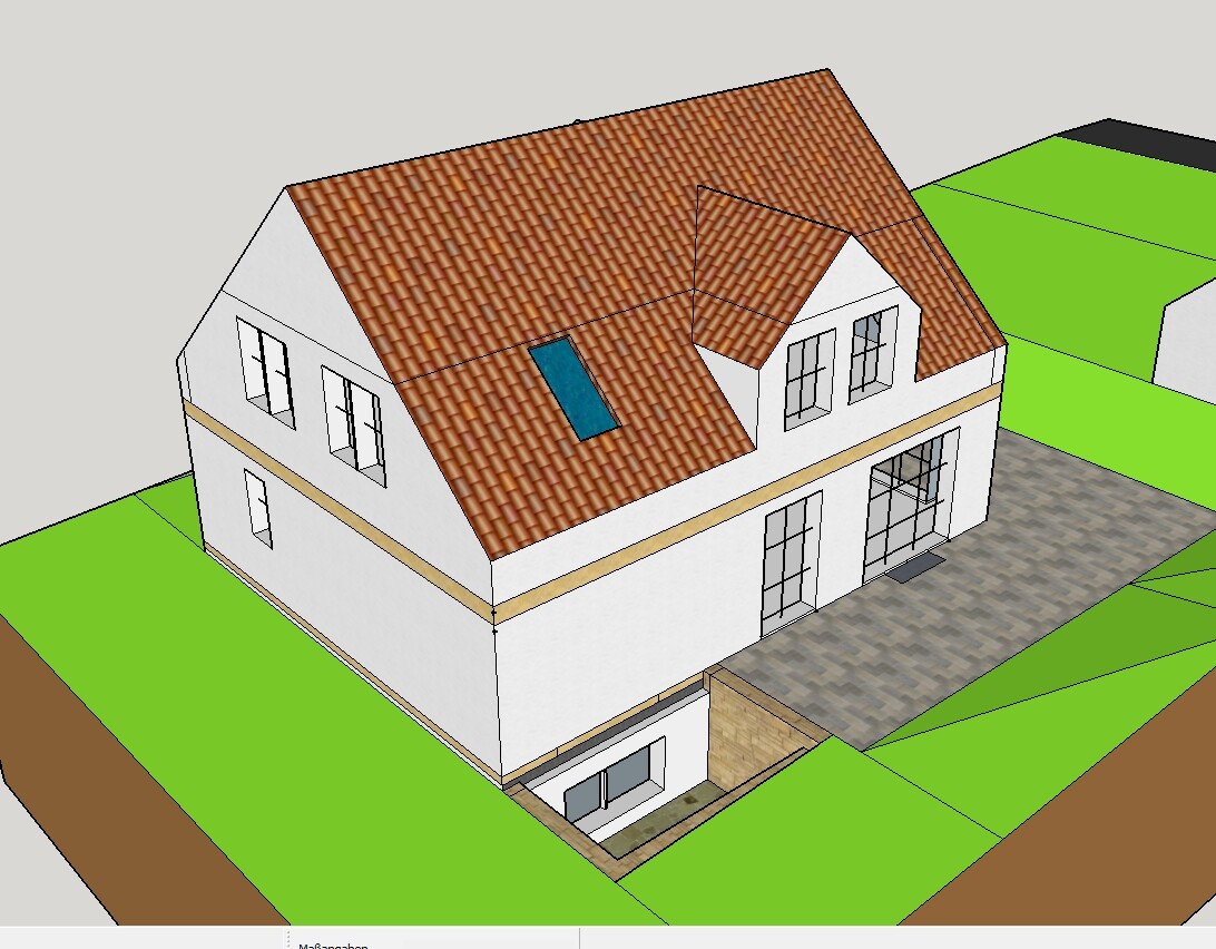

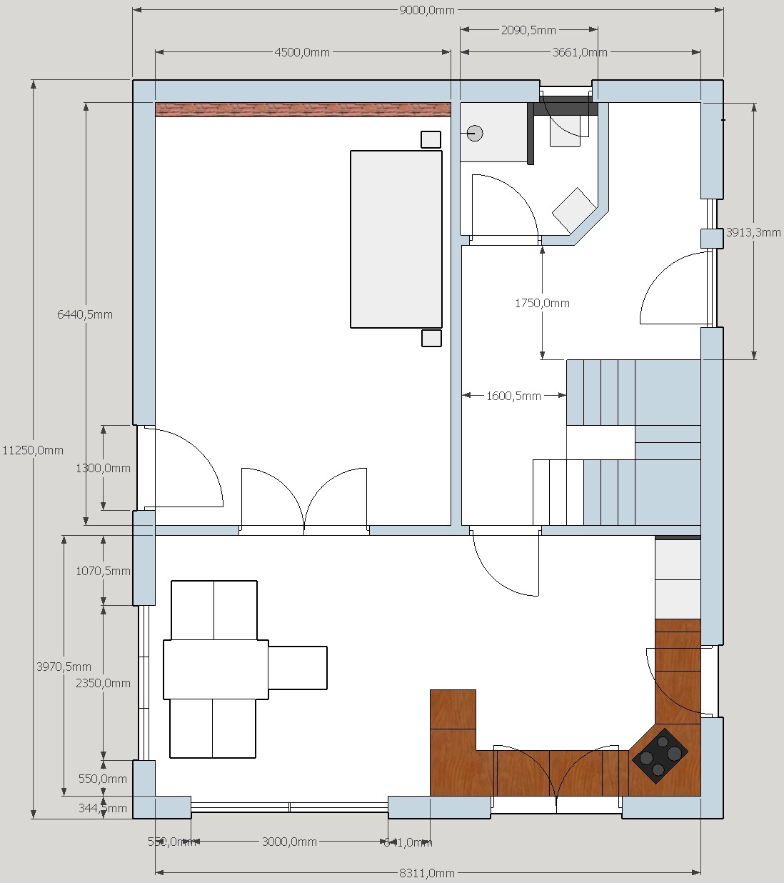

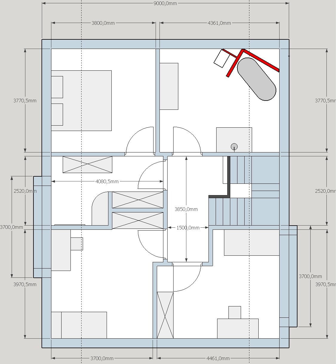

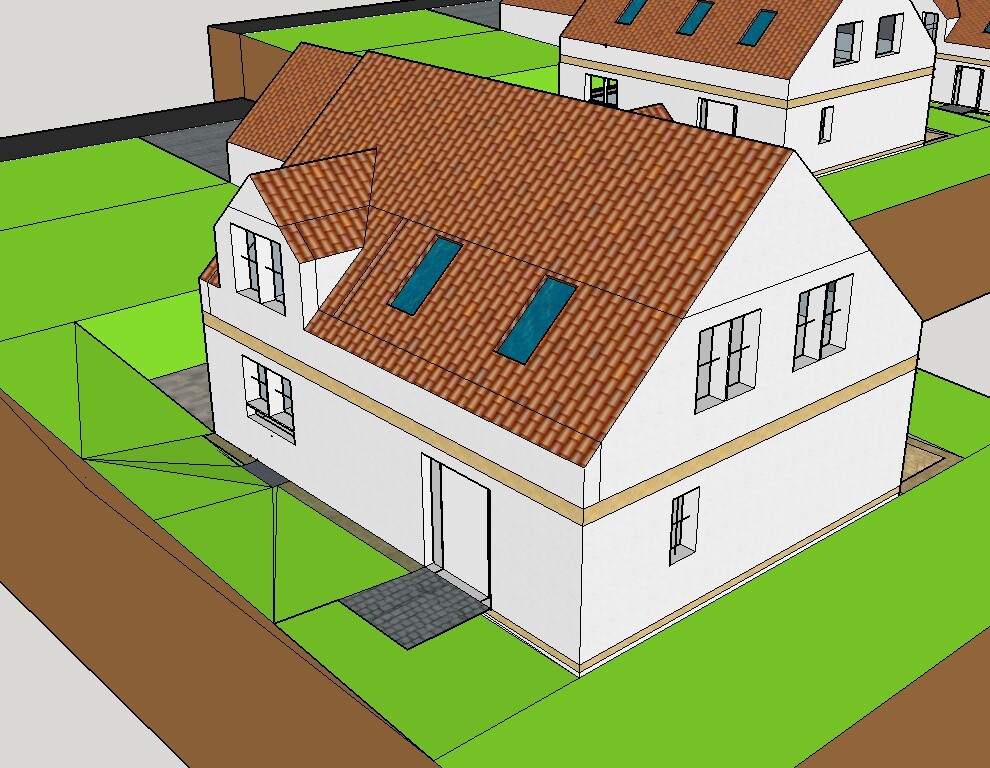

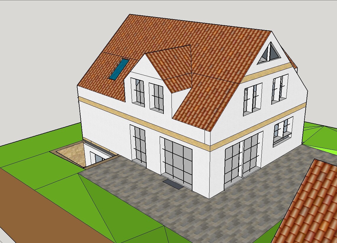

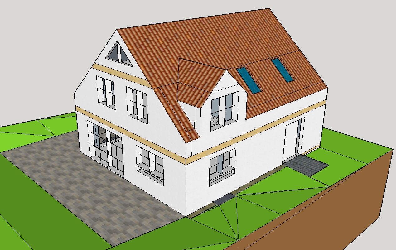

Attached are our own drawings from SketchUp / site plan from the development plan
Our plot is number [9]
Note: Unfortunately, windows are missing on the upper floor. There are planned windows on the gable ends sized 150 x 138cm (59 x 54 in), dormer windows each approx. 200 x 138cm (79 x 54 in), and in the stairwell, master bedroom, and bathroom an additional double casement window sized 78 x 160cm (31 x 63 in)

A few spontaneous thoughts:
Only a small window in the living room?
Once you have a child, you’ll probably do more there than just watch TV.
The 3D light well doesn’t match the plan, or am I misunderstanding something?
The asymmetry of the gables seems very unusual to me. Hmm. But it doesn’t really matter. Unsure.
Hi, you are completely right! We are still very unsure about the basement.
The window situation in the living room isn’t ideal, but the options are basically just: a window behind the TV or a window on the north side :/
The double door to the dining area is 2110 x 1960 mm (83 x 77 inches) and mostly made of glass. The window is supposed to be a 1300 x 2300 mm (51 x 91 inches) patio door, where the late afternoon/evening sun shines in.
We initially planned a symmetrical gable, but then the staircase goes over 4 m (13 feet) high with a window that is unreachable.
