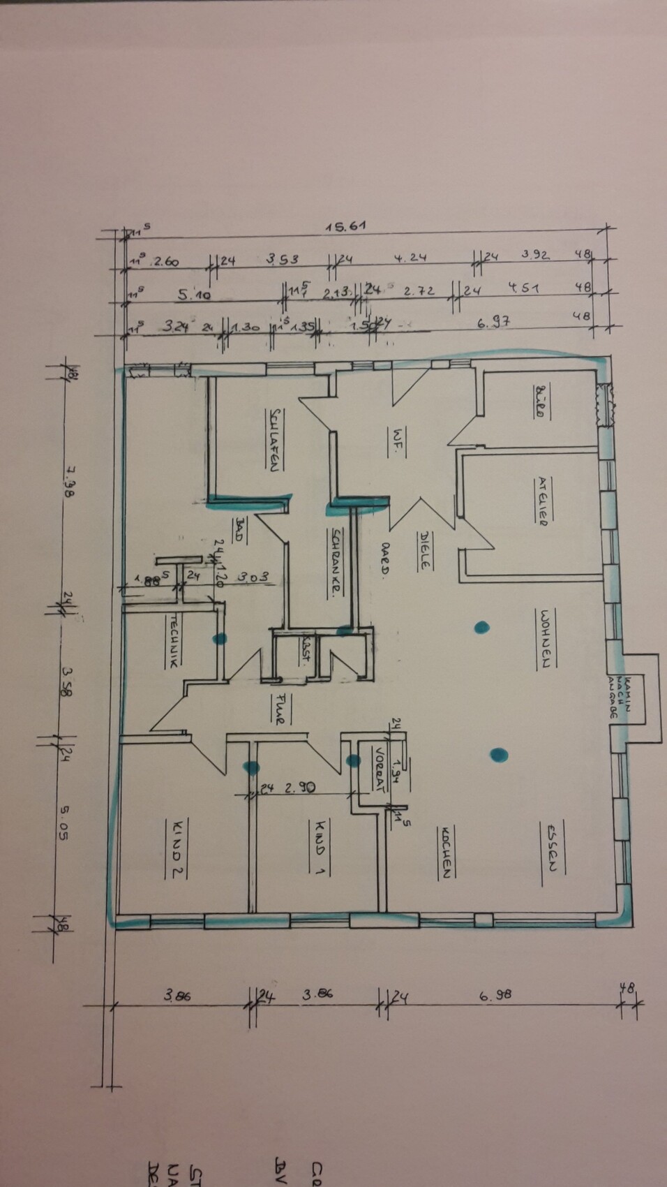

Hello, we have finished the planning phase. However, the problem is the bathroom and the entire corner area. To get natural light into the bathroom, we now have a large bathroom. Maybe someone has a good idea to remodel it and still have natural light. The bathroom should also be accessible from both the master bedroom and the children's bedroom.

Here is the questionnaire:
Development Plan / Restrictions: No windows can be installed on the lower side of the plan, as the building is directly attached to another structure there. Blue lines represent load-bearing walls, and the 6 columns (blue) cannot be moved.

Due to the blue walls being load-bearing (two of them plus the exterior walls) and because of the lower plan. No windows are possible there, as the building is attached to another one.
The bathroom should be accessible from both sides (children’s and parents’ bedroom).

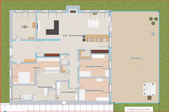

Another plan is missing the small home officeFurther below are the two floor plans again. The location and arrangement do not matter... The main thing is that the two load-bearing walls stay where they are. We wanted to combine the studio and office.
I would actually rearrange all the rooms.
Just a spontaneous idea.
Small storage room, small pantry to be removed.
Entrance hall = bedroom
Office = walk-in closet
Studio = bathroom
Living and dining = Child 1, Child 2, studio
Kitchen, Child 1 and Child 2 rooms, as well as the hallway, become cooking, dining, and living area.
Bedroom, bathroom, technical room, toilet, storage room = entrance, technical room, proper toilet without climbing.
No matter how you change it, always furnish the floor plan properly. You can’t fit a freezer in your pantry, the toilet requires climbing, etc.
Living rooms belong next to the terrace, not the children’s rooms.
