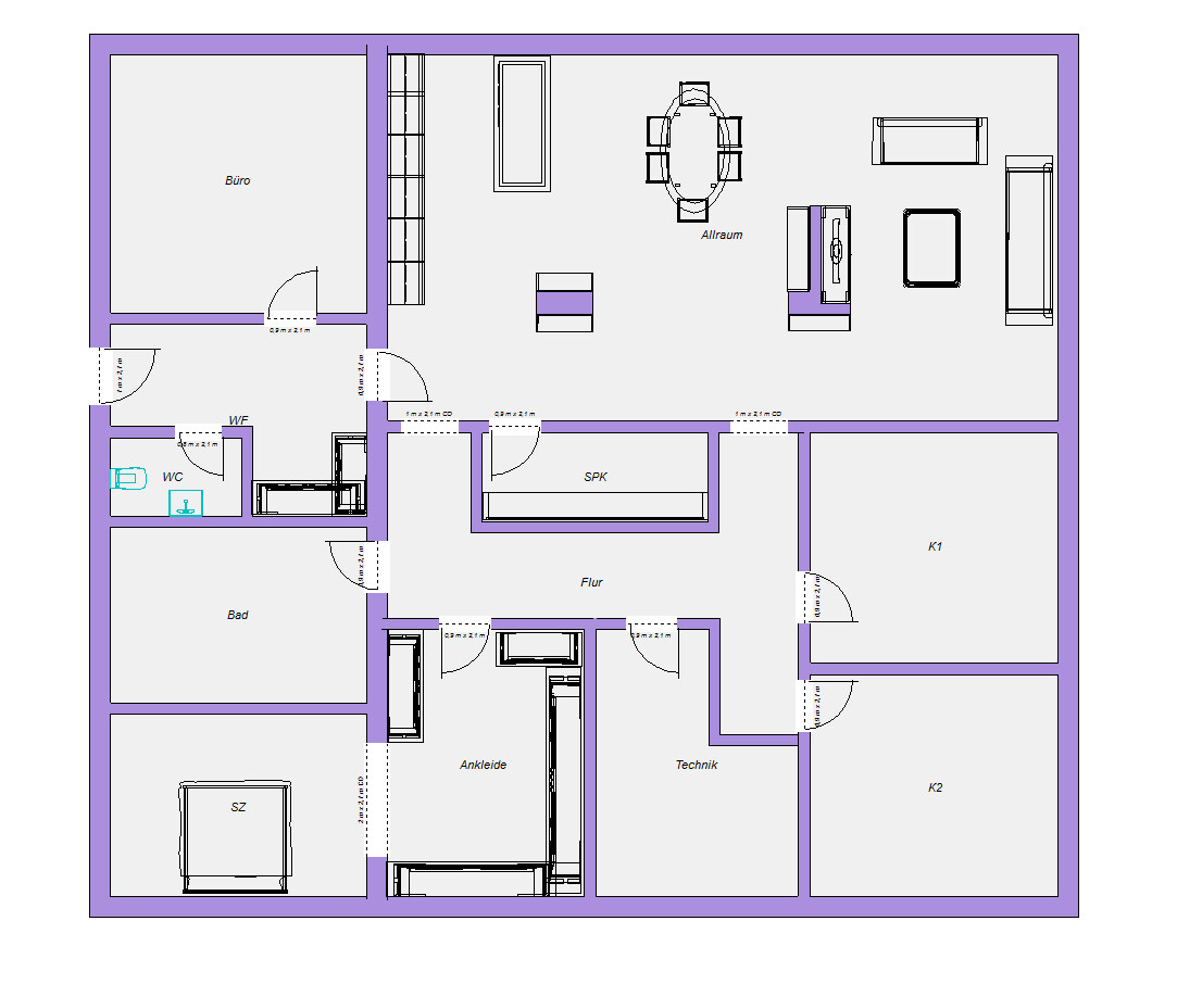

Hello, we have finished the planning phase. However, the problem is the bathroom and the entire corner area. To get natural light into the bathroom, we now have a large bathroom. Maybe someone has a good idea to remodel it and still have natural light. The bathroom should also be accessible from both the master bedroom and the children's bedroom.
Floor plan of a residential house with rooms (sleeping, living, dining, kitchen) and measurements.

kaho67424 May 2018 14:11
A quick sketch:
The dimensions are a bit confusing at first. So the space is really large. The layout could possibly be used more efficiently – I have quite a lot of hallway in there. Still, I like it better than your angled bathroom. Let’s see what other ideas come up.
Grundriss eines Hauses mit Büro, Allraum, Flur, Bad, WC, SZ, Ankleide, Technik, K1, K2, SPK
Windows omitted out of laziness.
