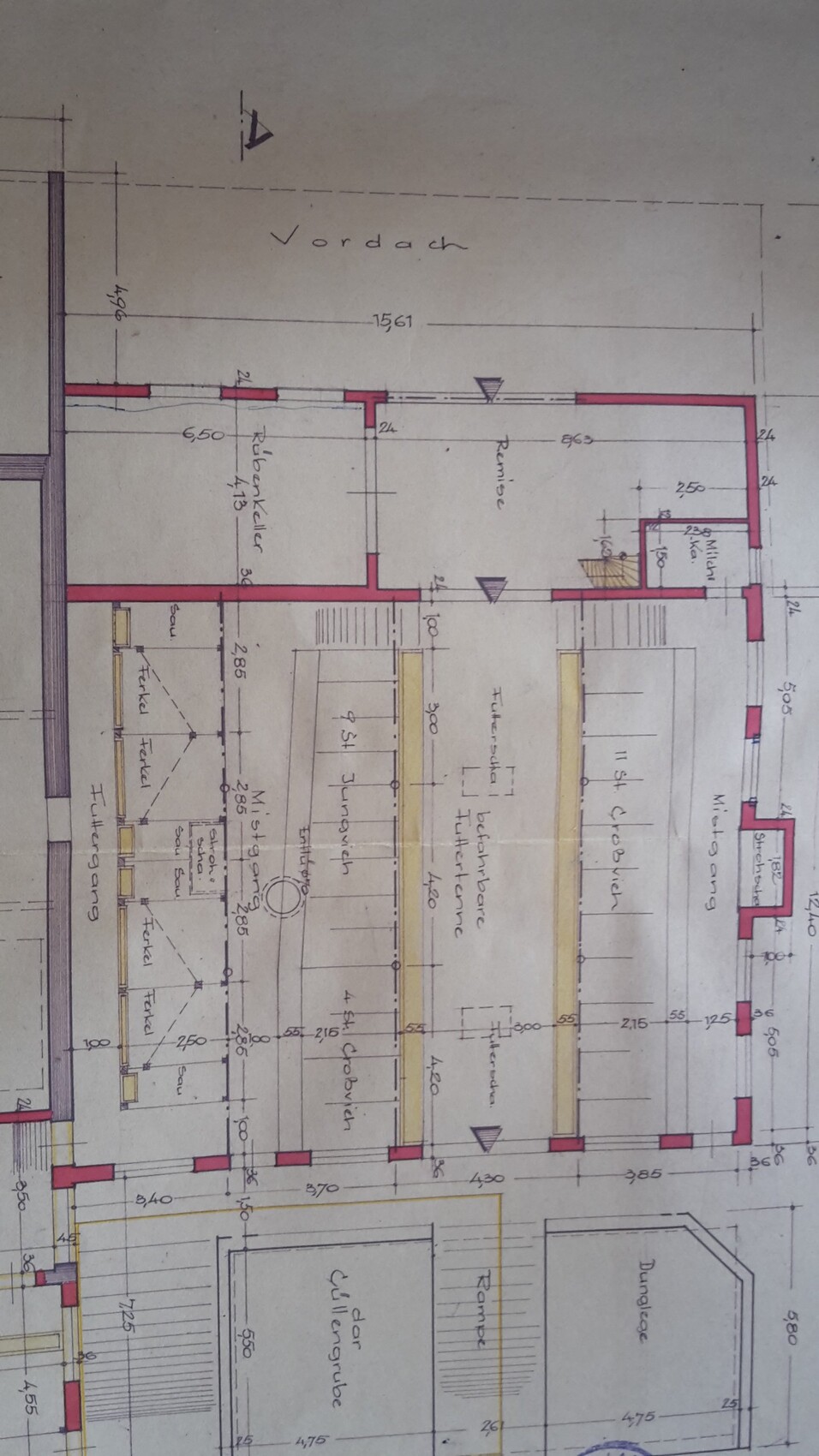

Hello, we have finished the planning phase. However, the problem is the bathroom and the entire corner area. To get natural light into the bathroom, we now have a large bathroom. Maybe someone has a good idea to remodel it and still have natural light. The bathroom should also be accessible from both the master bedroom and the children's bedroom.

If you want, please upload the current “as-is” plan with a north arrow. We already have the planned drawing. Maybe a few good ideas will come up. It’s also important to include information about any existing sewage connections and water pipes—if there’s anything already in place, please mark it on the plan.

If you want, please share the current “as-is” plan with a north arrow. We already have the target plan. Maybe some more inspiring ideas will come up. It’s also important to mark any existing sewage connections and water pipes – is there anything already there? Please draw it in if so. Unfortunately, it can’t be done otherwise....
The floor has to be removed... after that, about 2.50 meters (8 ft 2 in) ceiling height. Yes, we’re trying to integrate the supports into the walls... unfortunately, two remain in the living area. But I think they can be integrated nicely as well.
We still have the plan... nothing else. Was that what you meant? All water connections will be newly installed.

Sorry, can you quickly remind me where north is – by the pigsty, the cattle barn, or maybe the sugar beet cellar? (...wonderful... )North is where there are no windows... so at the "Füttgergang"
kaho674 schrieb:
Children’s rooms on the south side would be great. Why isn’t that desired?Because they heat up a lot and they can’t sleep at night in summer.
