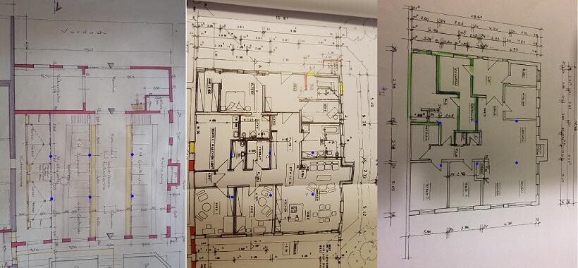

11ant26 May 2018 18:54
I have created a synapse (existing condition – architect’s plan – technical execution plan) with approximate column locations marked. It is clear that in the architect’s plan, many more areas should have been shown in yellow (demolition) or red (new). The load-bearing wall (the wall to the stable room, essentially the zero-th column line) is no longer continuous, but there are no visible beams or other structural replacements.
