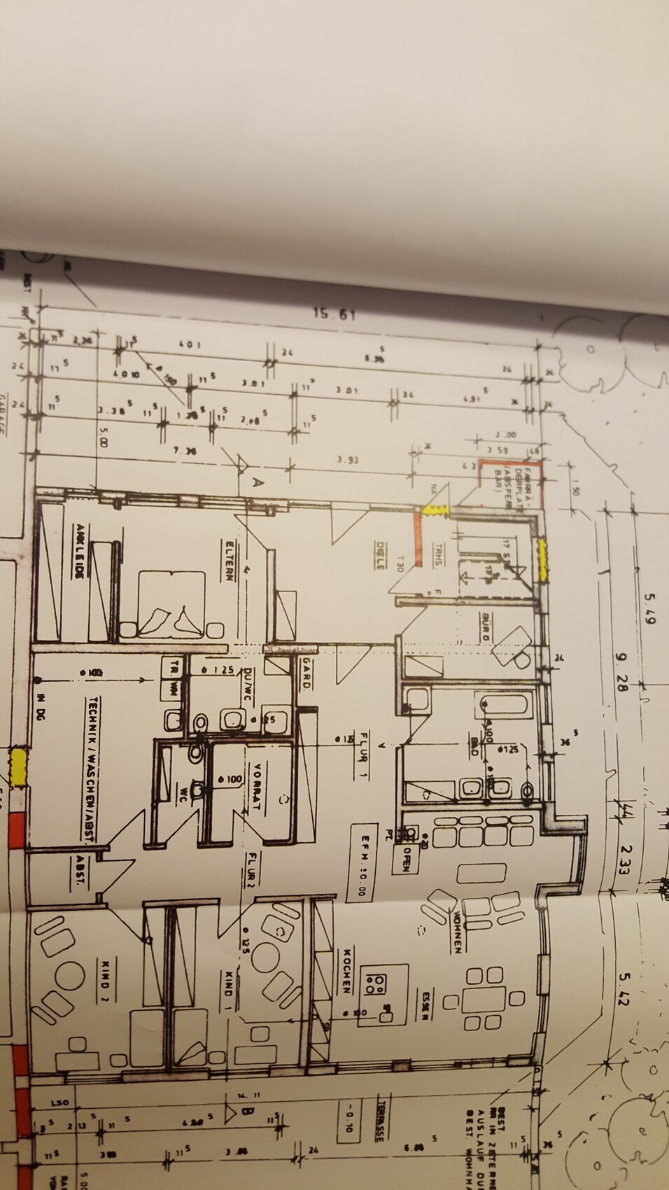

Hello, we have finished the planning phase. However, the problem is the bathroom and the entire corner area. To get natural light into the bathroom, we now have a large bathroom. Maybe someone has a good idea to remodel it and still have natural light. The bathroom should also be accessible from both the master bedroom and the children's bedroom.

Kaho came up with a quite usable floor plan "out of the blue." It's unfortunate that an architect couldn't make more progress...
I think I read somewhere about the bedroom being too small. The room should be about 3.5 by 3.5 meters (approximately 11.5 by 11.5 feet). That’s not small. The bathroom, as I recall, is 6 or 7 meters long (20 to 23 feet), which is really large! Theoretically, you could even enlarge the hallway at the expense of the bathroom and access the bedroom from the dressing room/hallway side (instead of the vestibule) without the shorter bathroom length being very noticeable.
Could it be that you don’t have a clear sense of the sizes yet? If you drew furniture to scale, you’d discover many points that need further consideration.
And that’s just the floor plan. Family situations (e.g., ownership issues) and whether you can really house a tenant above the still-occupied older part of the house would add even more concerns on top of mine.
Don’t get me wrong: such a remodel can work. Doing it yourself can work. But all the effort for a project where you’d go from the vestibule straight into the bedroom...?
