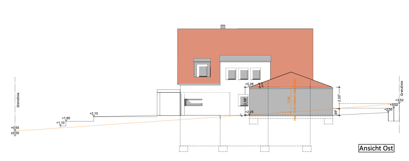

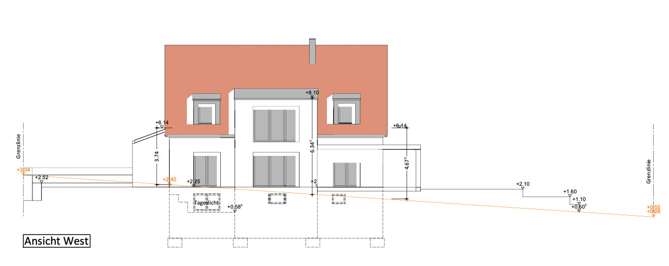

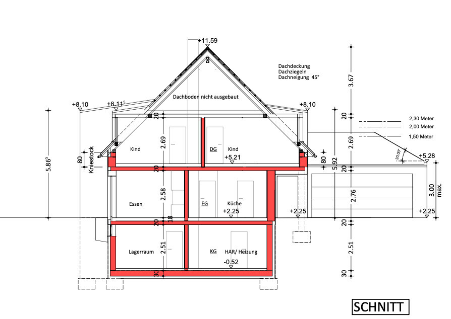

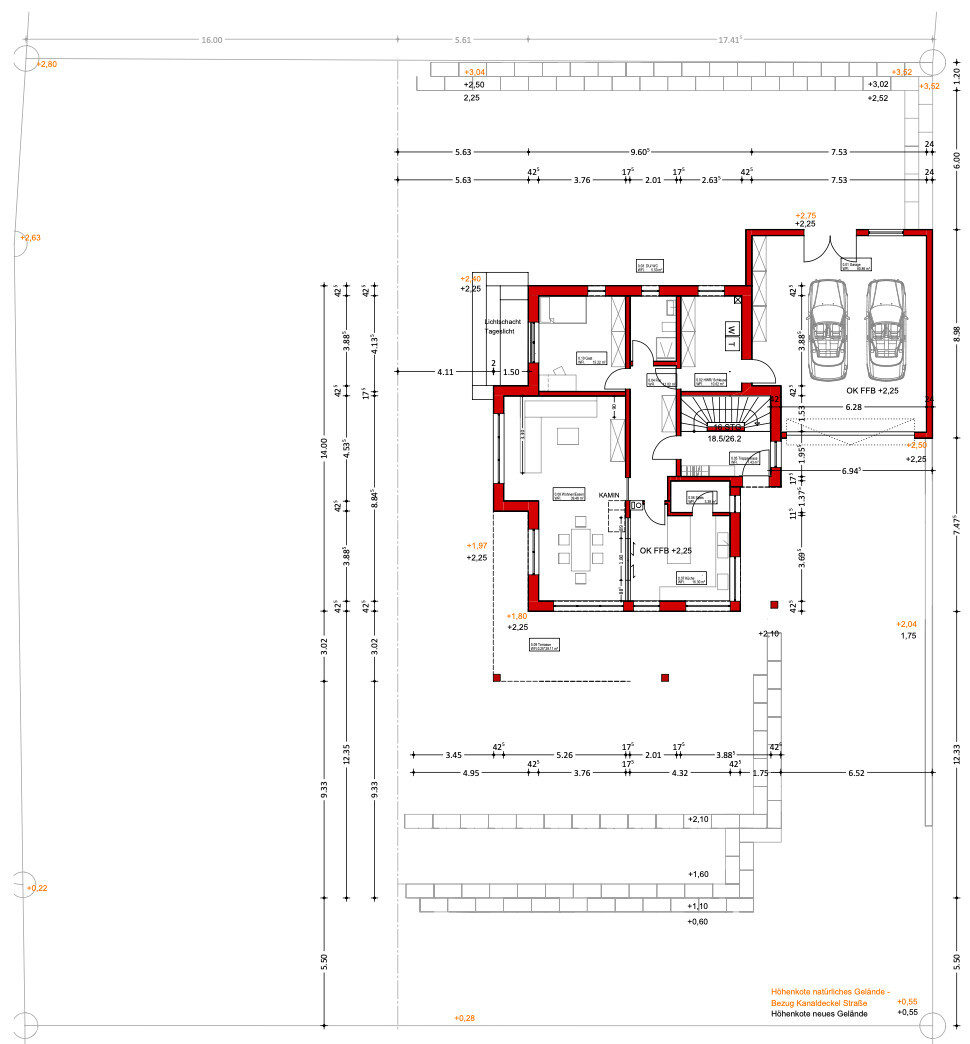

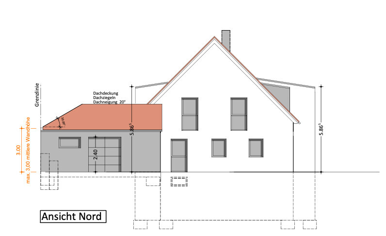

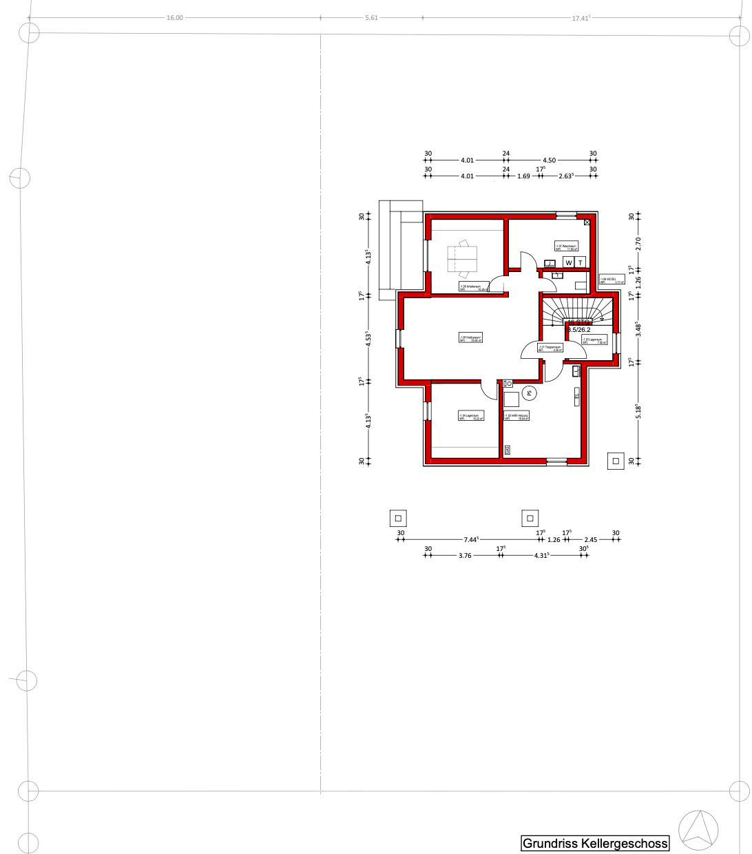

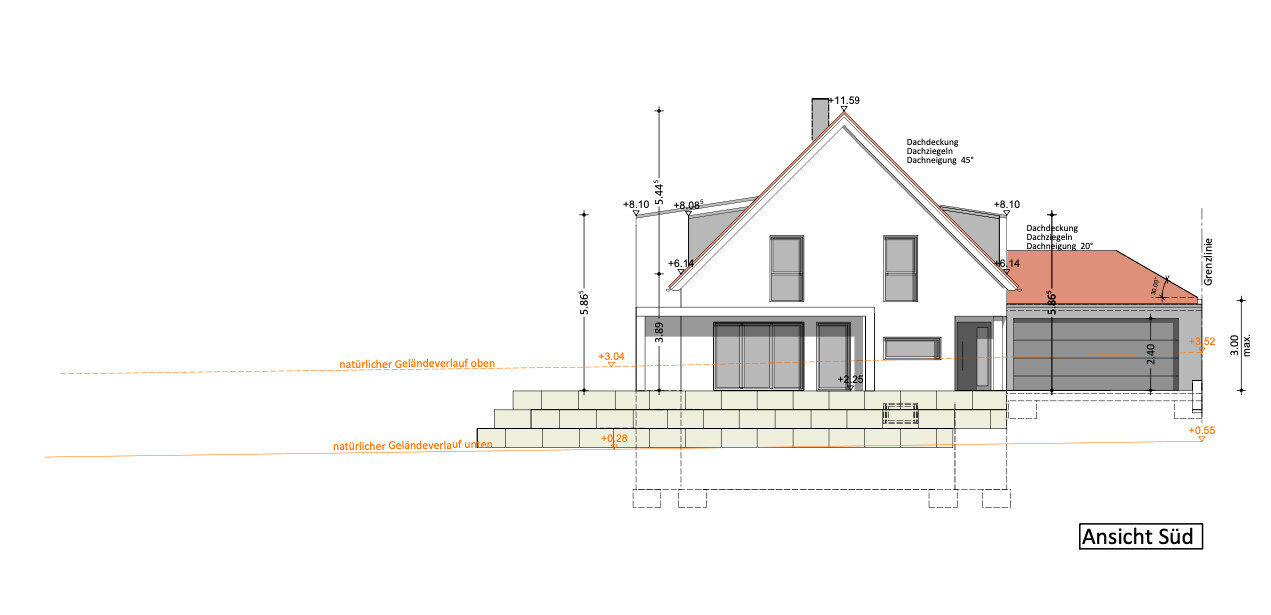

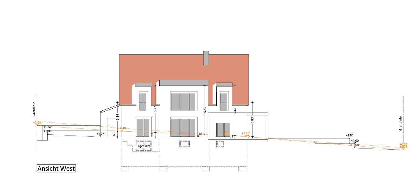

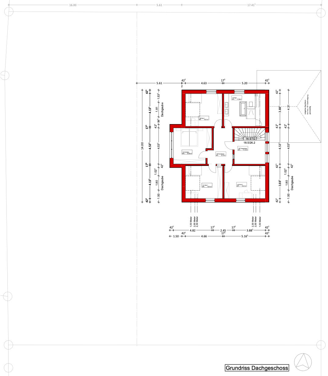

jonashartf5 Jul 2020 01:03Hello everyone,
After consulting with the local authorities, we are allowed to build an 80cm (31.5 inch) knee wall. Attached are the updated plans. The window openings are not yet finalized, and for the dormers, we currently have two options (see West elevation). We’re not usually big fans of floor-to-ceiling windows, but visually they certainly look good. We welcome your feedback!
Thanks in advance and best regards
Your budget and the planned house do not match. A six-figure amount is missing to make it ready for move-in.
The hallway is a dark cave.
What is the utility room on the ground floor for if there is a basement?
The guest room and bathroom on the ground floor are not suitable for seniors.
What is the basement supposed to be used for? These are just empty rooms, and there is space upstairs for the study. Do you have a free room in the attic?
All previously mentioned comments still apply.
I also don’t see the budget here.
The basement, the brick-built double garage with a roof, and the dormer windows with the extensions make the house more expensive than 2000€/sqm (approximately $180/sqft). Then there’s the large sliding door, fireplace?, big garage door... For a basement, you usually budget a bit less than 1000€/sqm (about $90/sqft), but I see the double garage here costing three (or even four) times that, and lots of dormers are complex and costly.
I’m revising the basement estimate upwards now that I realize it’s intended as a livable basement.
If you’re planning close to 300sqm (about 3200 sqft), you need to be able to afford it. How do you arrive at your stated budget???
Regarding the floor plan: I assume the plan is to divide the living space into two separate units later?
Try furnishing the guest room on the ground floor. Barrier-free... hmm, it might work.
For a single-family home (with children), I personally don’t like external staircases. They tend to reduce the single-family house feel. Here, the hallway on the ground floor is quite prominent, looks a bit old-fashioned, and will be dark.
What fundamentally doesn’t work here is that when entering the ground floor (after the staircase), you immediately face a wall. That’s not inviting. I would swap the kitchen area and the living room, then place an inviting double door with a view opposite the hallway door.
I think this is a dream house plan with three offices/guest rooms plus basement rooms—so everything is doubled up and has to work for all eventualities, all in a higher-end option.
My advice: leave out the basement, make the utility room a bit larger, and choose a prefabricated kit for the double garage.
Also, consider whether you really need the dormers upstairs, since for a self-contained unit you’ll need a balcony and parking spaces again—do you want to implement that in 20 years? I don’t think so.
“Fireplace yes, with bench” – what does that mean? A stove? That takes up additional floor space and costs five figures!
