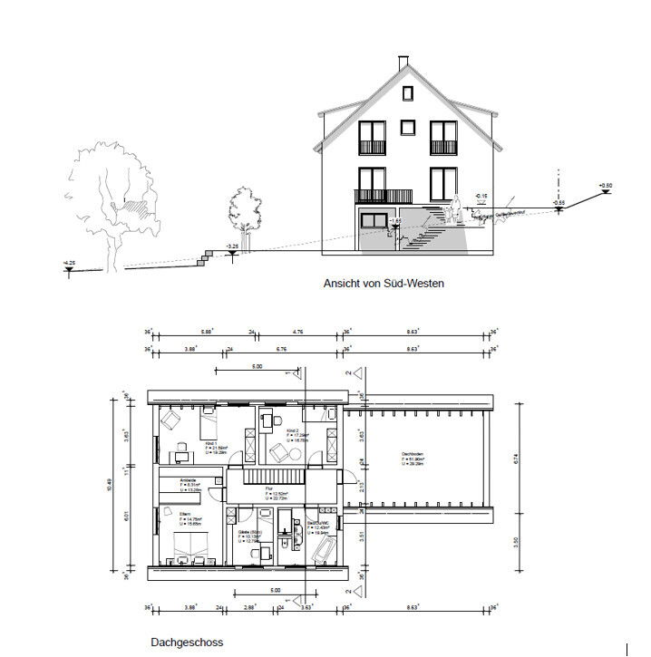

We received the first draft of our single-family house over the weekend and are initially very pleased 🙂
We would like to share the first sketches here to get feedback from experienced homebuilders.
A few notes:

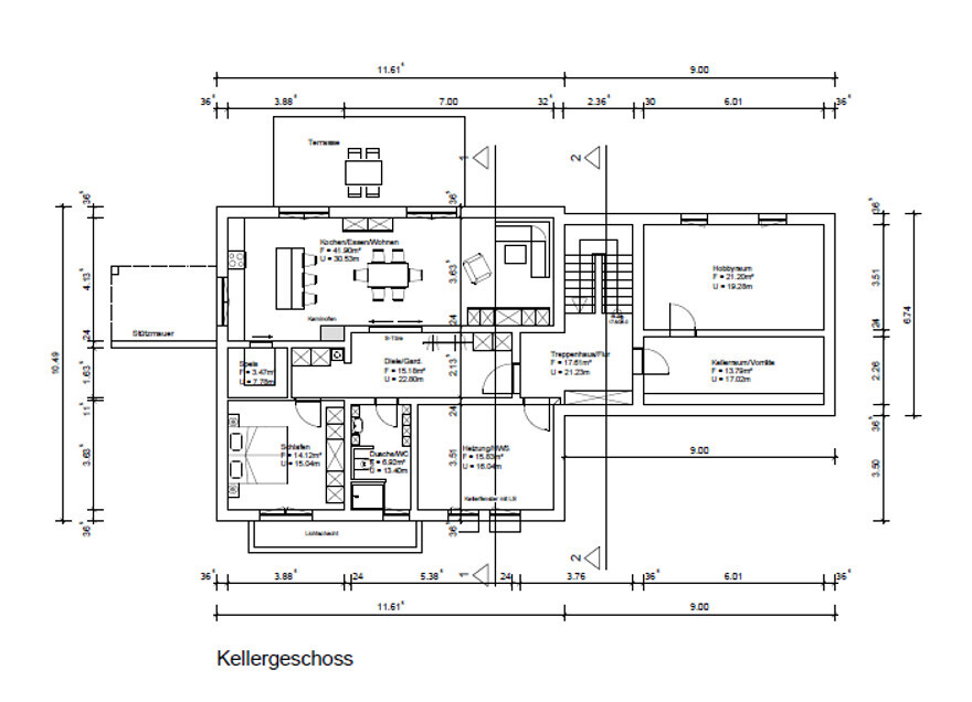

Due to the slope of the plot, we will build with a basement. It will house a separate apartment / my wife’s naturopathic practice.
A home office on the ground floor or attic is essential as I regularly work from home (even before the pandemic).
We are currently planning a house for 3 children. Additional space could be created by expanding over the garage.
The heating system will be a ground-source heat pump. Our plot measures approximately 1200 m² (0.3 acres).
Regarding the cost calculation, I want to provide some information. We received the following estimates from the planner:
KfW 55 house
Residential building: 1,145.917 m³ (40,462 ft³) x €350/m³ = €401,070.95
Garage: 511.66 m³ (18,060 ft³) x €175/m³ = €89,541.55
Additional construction costs: €30,000
The calculated costs for the residential building do not include expenses for interior fittings. Owner’s contributions are also not included.
I look forward to your feedback on the floor plans.
Critical comments are explicitly welcome 🙂

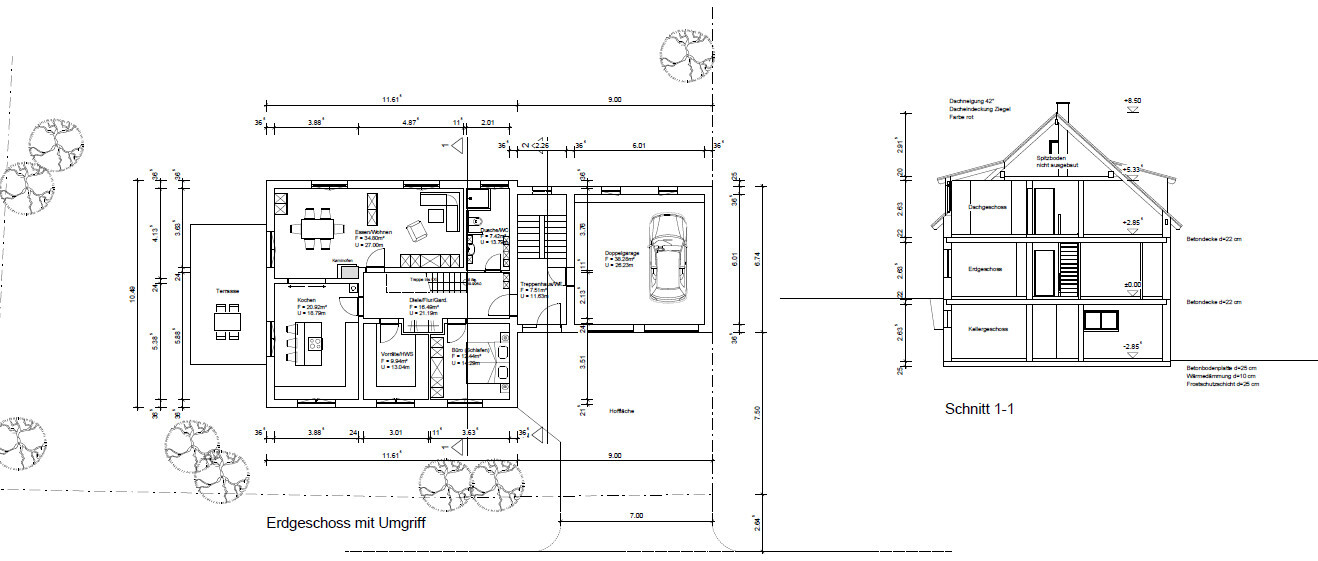

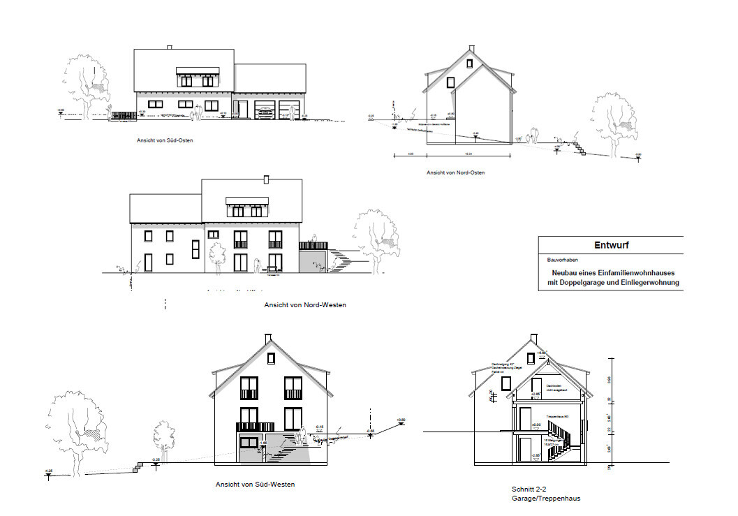

From the outside, it looks like a small rental building. At least from the garden side... the question you need to ask yourselves is: do you want to sit on the terrace next to such a high outer wall and enjoy life? It wouldn’t be for me!
However, I am looking for the terrace but only find a small roof terrace on the side? What is that standing on? (Site/plot plan is missing to assess this properly.)
But life doesn’t take place on a paved terrace, rather on the lawn area (1200sqm (12917 sqft)?) How will the kids be supervised there?
Are you really building a single-family house without direct access to the garden, or will this be assigned to the practice?
Regarding the practice: the feeling in a long but very narrow room is not what you want—not even for a practice. Especially as a naturopath, you should have considered external factors that negatively affect people.

The garden access from the practice is almost impossible to arrange differently due to the slope.
The garden should also be accessible from the terrace. (Small path or similar).

However, I am looking for the terrace and only find a small roof terrace on the side? What is it supported on? (Site plan is missing to assess this)
Budget: 260 sqm (2800 sq ft) are estimated at €520,000 plus garage, quite a straightforward calculation. The terrace is supported on soil, a retaining wall, and a column. See the basement floor plan.
Part of the site plan is shown in the ground floor plan. The street frontage should be 34 m (112 ft). Garage on the boundary? However, the dashed-dotted line could also be the building envelope/planning boundary?

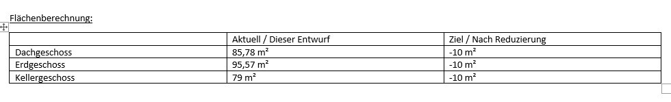

Budget: I think the living area is supposed to be reduced by 30 sqm (320 sq ft). Still, €520,000 is quite tight depending on the district in Bavaria.

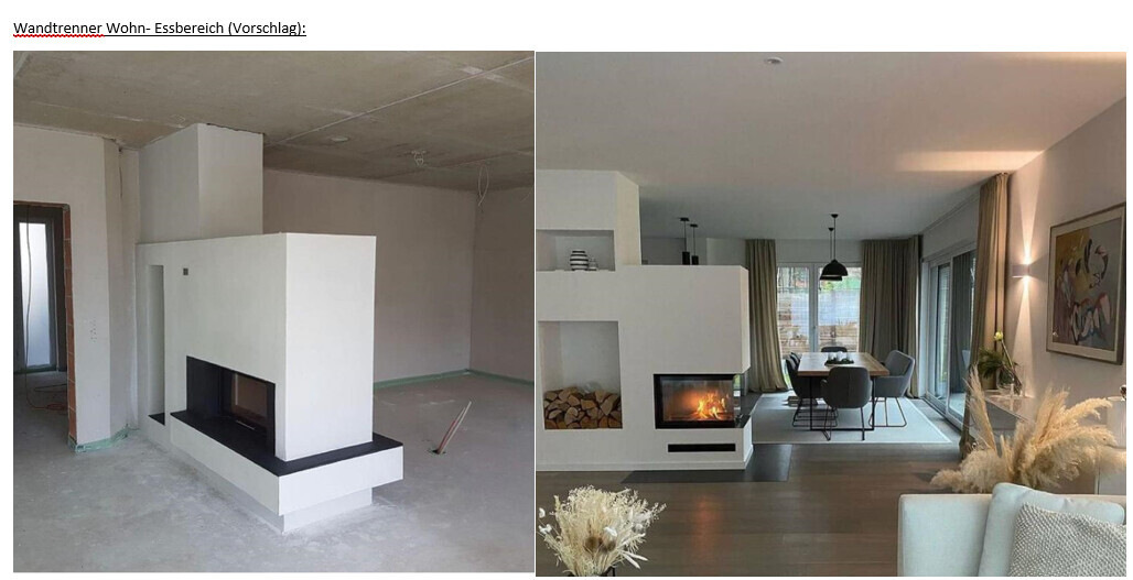

Open or closed layout – living and dining area open, separated by a room divider
Conservative or modern construction – simple and practical
Open kitchen with island – closed kitchen with island
Number of dining seats – 6 to 10
Fireplace – yes, as room divider between living and dining area?
