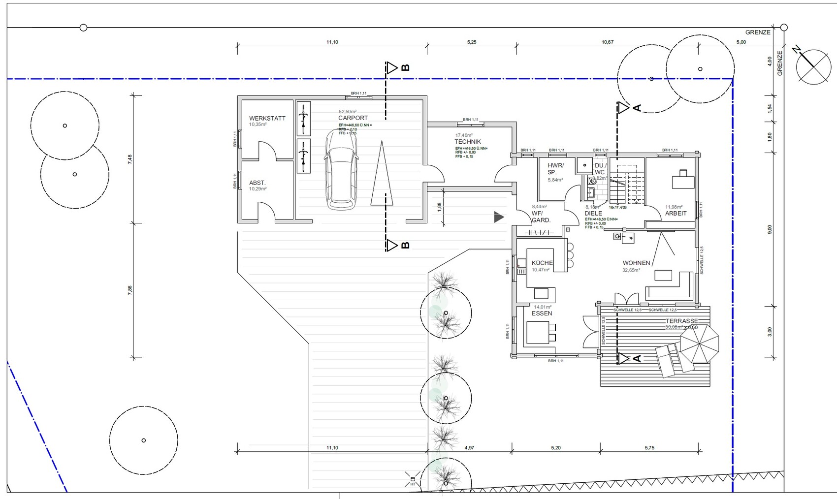

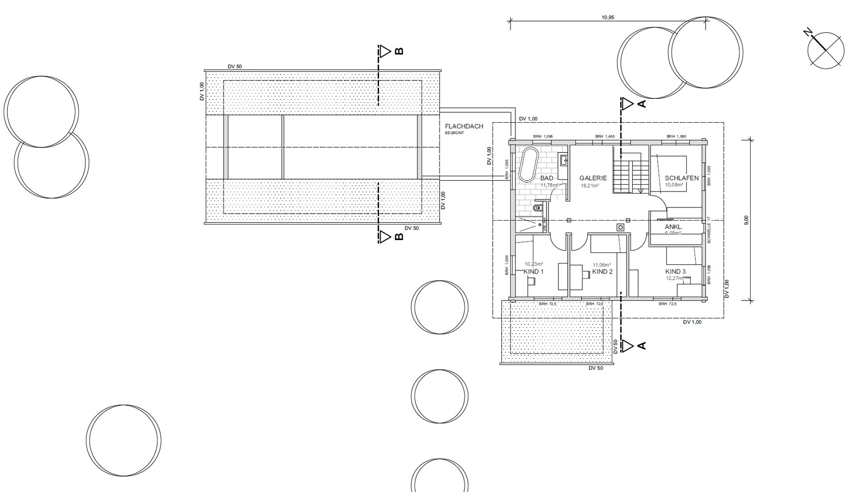

Hello everyone!
Attached is our preliminary plan. What concerns us the most at the moment is the size of the two children's rooms upstairs, each under 12 sqm (130 sq ft). The layout of the bathroom is also something we are considering carefully since it is related to this.
Otherwise, we would of course appreciate objective feedback!
Grundriss eines Hauses: Schlafzimmer, Galerie, Bad, Kinderräume, Ankleide, Dachterrasse, Bäume außen.
Grundriss eines Hauses mit Garage, Carport, Werkstatt, Küche, Wohnzimmer, Terrasse und Garten.

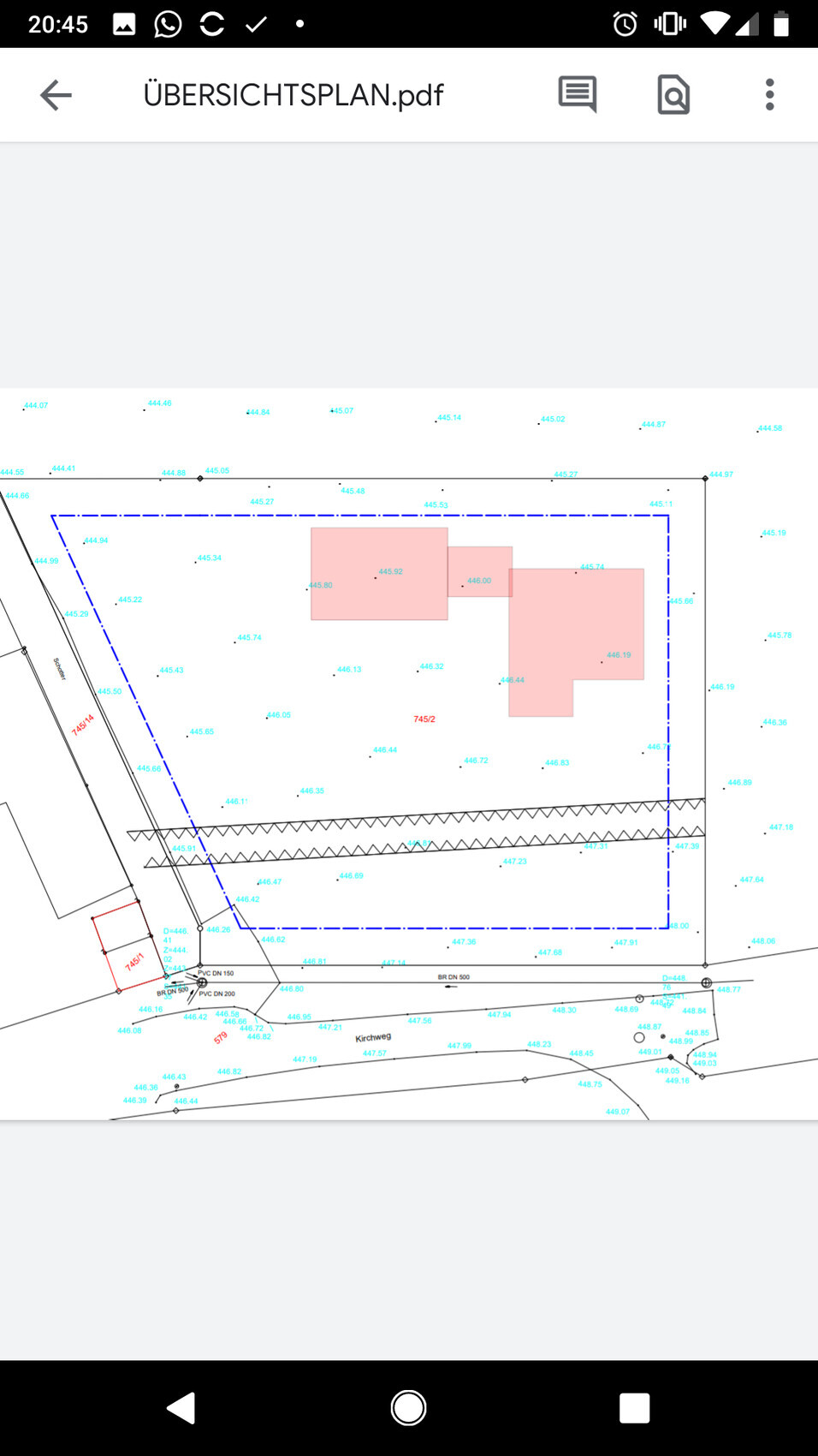

Lageplan: Grundstück mit blauer Umrandung, pinke Gebäude, Kirchweg unten, blaue Höhenwerte.

Have you also read https://www.hausbau-forum.de/threads/grundrissplanung-unbedingt-vor-Beitrag-Erstellung-lesen.11714/?
Is all of that your property?
Site plan: blue dashed boundary, pink building blocks and streets.
Is the street on the left and at the bottom of the plan?
What do the wavy lines represent?
Why the long driveway from the south and the terrace squeezed into the corner?

The house has potential for improvement
Please fill out the questionnaire
Is all of this your property?
36616
What do the wavy lines mean?
Why is there a long driveway from the south and a terrace squeezed into the corner?
That’s exactly what I wanted to ask as well
kaho67420 Jul 2019 21:42
Do I understand correctly that the driveway runs across the entire property?
With three children’s bedrooms, I consider the gallery on the upper floor a waste of valuable square meters. But such details can be addressed once the layout is finalized.

Sorry, I completely forgot …
Plot size: approx. 2000 m² (0.5 acres)
Slope: none
Site coverage ratio: 0.4
Floor area ratio: 0.7
Building window, building line, and boundary: see overview plan

- Architect: yes
What is especially liked: staircase with gallery; living-dining area, because the corner bench and terrace finally work out
What is not liked? Bathroom and layout of children’s rooms, one bedroom is too small. The room layout is not optimal yet
Why was the design developed as it is now?
For example, the design was developed together with the architect.
