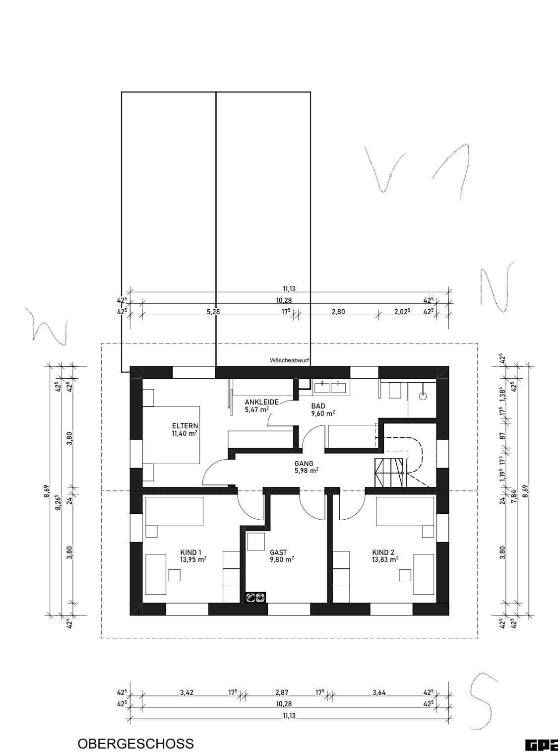

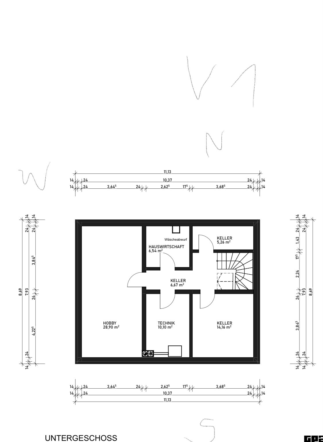

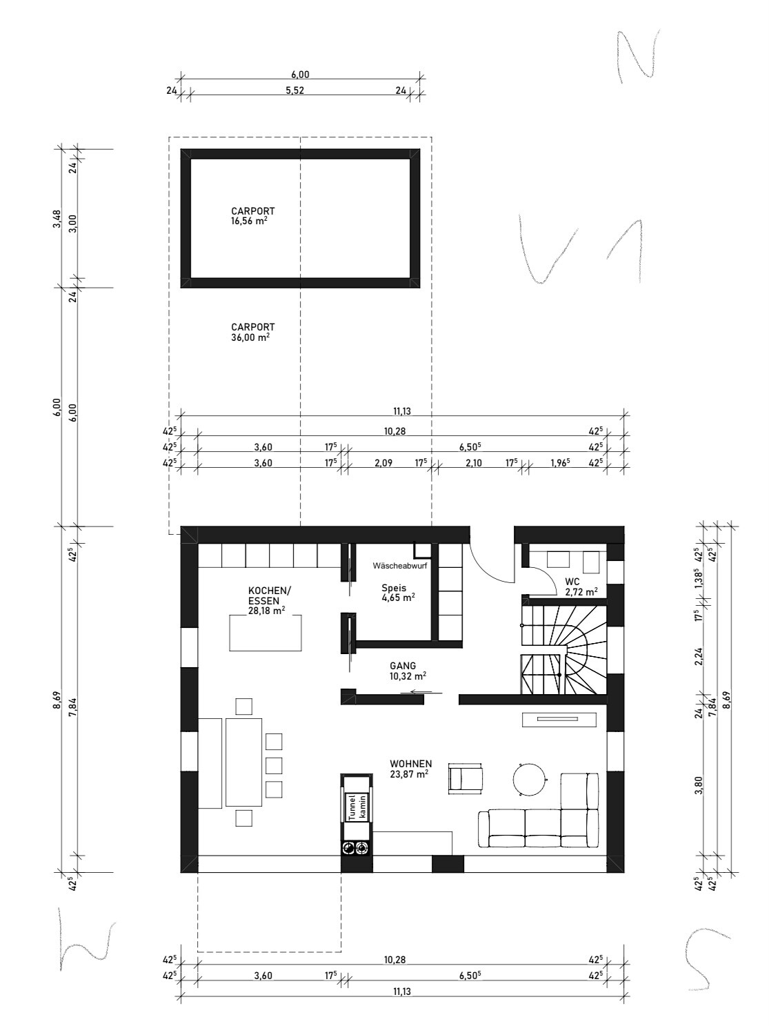

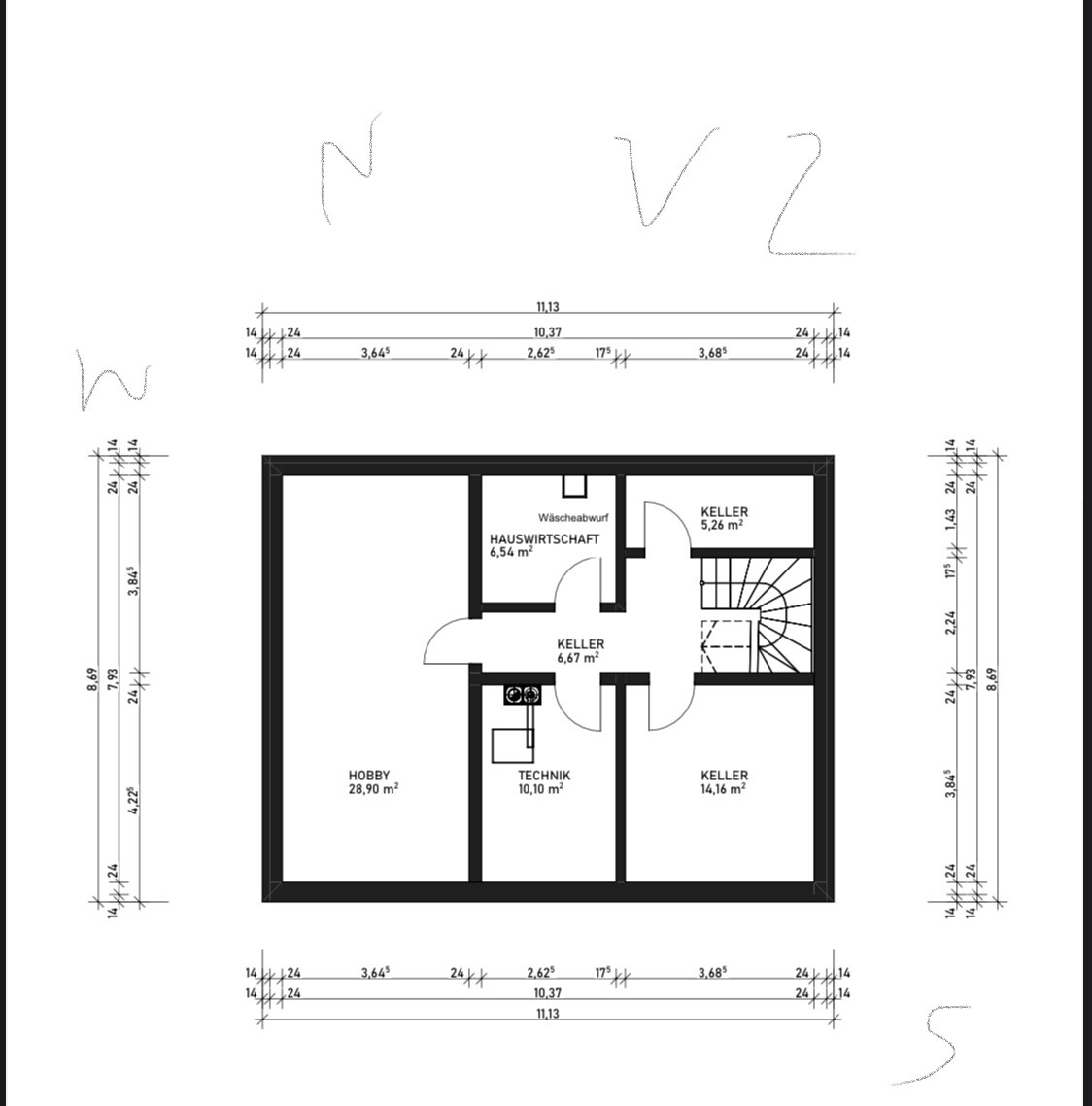

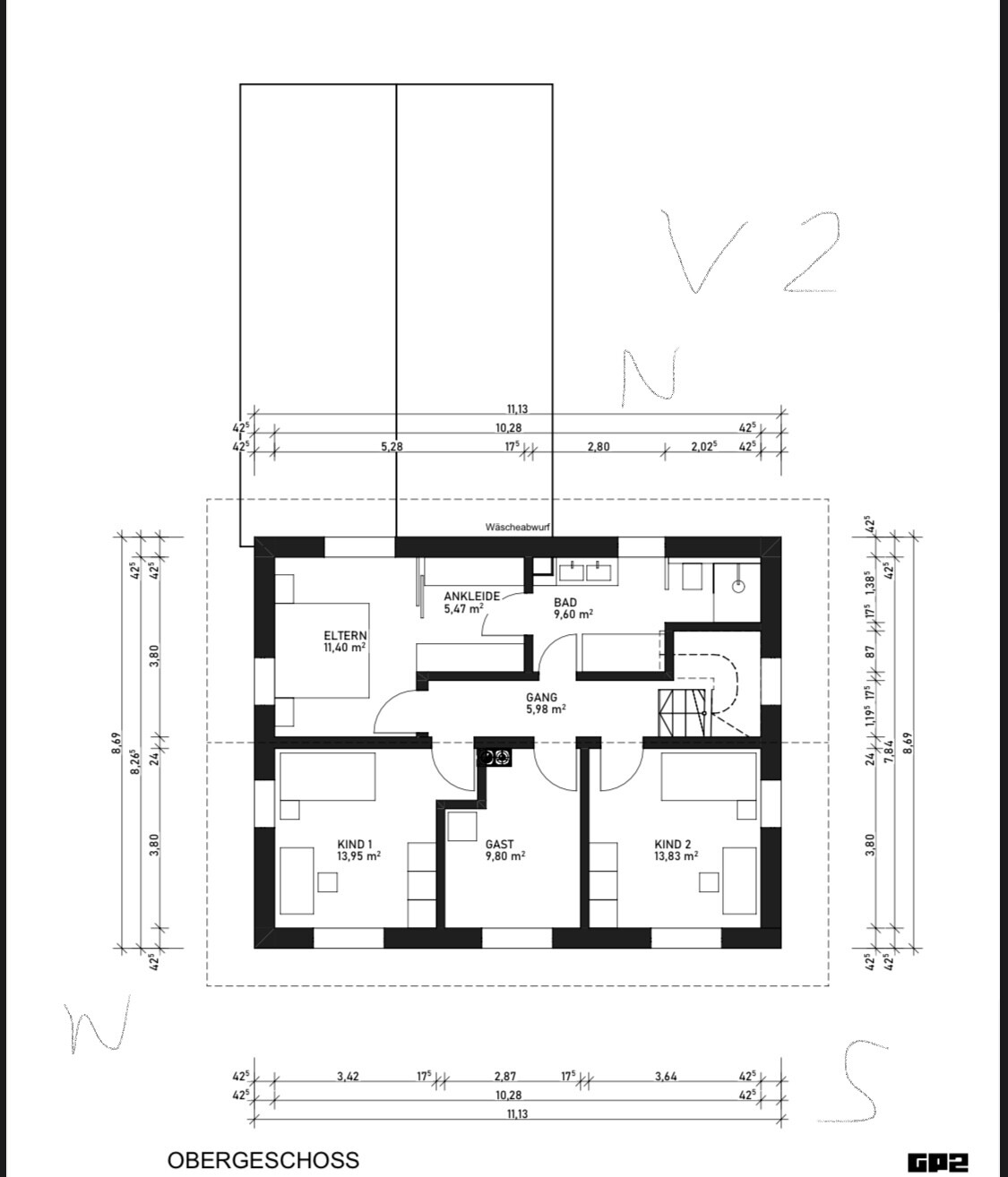

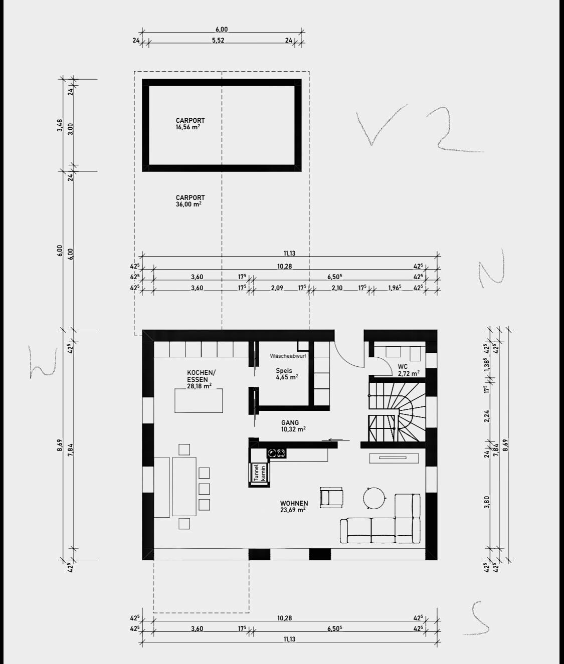

Hello everyone. We worked on two versions with our architect and aren’t sure which we prefer. There is a stove bench next to the stove in both.
The windows throughout the house are not final yet; we still need to discuss them.
We plan to build a carport between the house and garage. Do you think the kitchen window makes sense even though it basically faces the carport? We think at least you can see the children playing and who is arriving.
To the east is a single-family house, to the south a large meadow, and to the west the street, which is very quiet since it is a rural area.
This is my first post; I hope I’ve done everything correctly—if not, please forgive me in advance.
Looking forward to your suggestions. Best regards
House floor plan: Carport above, living area below with kitchen, hallway, pantry, laundry chute, and WC.
Upper floor plan: Master bedroom, dressing room, bathroom, corridor, guest room, 2 children's rooms.
Basement: hobby, technical, cellar rooms, utility, laundry, stairs
House floor plan with carport, cooking/dining, living, hallway, pantry, laundry chute, and WC.
Upper floor plan: corridor connects master bedroom, child 1, child 2, guest room, bathroom, and dressing room.

Not exactly wrong, but it was a bit unnecessary to illustrate the second version as well. To get straight to the point, the question would also have been clear if presented as "text only": "We are considering building essentially the same floor plan, either with the chimney at the ridge or at the eaves." The answer is quite simple: the flatter the roof, the more a matter of personal preference; otherwise, the chimney at the eaves is technically less favorable and more visually prominent. In that case, I would make it stand out deliberately, for example on the outside and differentiated by material and/or color.
5 Feb 2021 00:56
In short, to put it simply and directly: what is the roof pitch?
11ant5 Feb 2021 01:04
P.S.: If you are going to have two different living room doors, I would make the one aligned with the front door a standard hinged door. Furthermore, I forgot one of my mantras: building to imaginary dimensions is inefficient and typically leads to sloppy workmanship.

Thanks for the suggestion. I'm curious. Of course, I’m also interested in your general opinion about the floor plan, and since there are changes to the upper floor in both versions, I thought this would be helpful. I will ask about the roof pitch; we haven’t discussed it yet, as we are still at the very beginning.
Kathianni
5 Feb 2021 03:40
P.S.: If you’re going to have two different living room doors, I would make the one aligned with the front door a standard hinged door. Also, I forgot one of my mantras: building with non-standard dimensions is inefficient and usually leads to sloppy workmanship.
Would you leave out the second door? Which two living room doors are you referring to? And where do you see non-standard dimensions? What is your overall impression of the floor plan?
