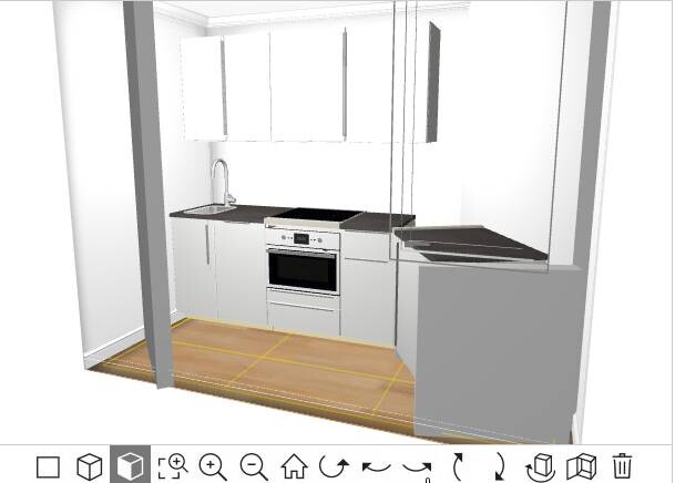

After many issues with kitchen studios (missed appointments, no further contact, outrageous prices, etc.), I have now decided to go with IKEA for my kitchen.
Today, a technician came with his advanced laser measuring device and measured the kitchen for me (unfortunately, it’s relatively small at about 4m² (43 sq ft) and quite awkwardly shaped).
I already have a rough sketch in mind of how I want it to look, but I still have to wait for the exact measurements for more detailed planning.
In short: an L-shaped layout with a compact oven and a 45cm (18 inch) dishwasher. This is where my actual questions begin.

I took a closer look at the sink. It is 37 cm (15 inches) wide, and the cutout is supposed to be 1.6 cm (0.6 inches) less, so 35.8 cm (14 inches) wide. The cabinet has a clear internal width of 36.6 cm (14.4 inches). This leaves very little room. The mounting clips are about one centimeter (0.4 inches) wide, so they fall within the cabinet walls. For the countertop to sit properly, it must be routed out at the clip locations, and the sink has to be installed into the countertop before it is placed. This setup is bound to cause problems if the planner simply approves the installation as it is.
MuenchnerKindl1 Sep 2016 22:53Okay, that sounds "interesting" – I had seen the numbers too but found them difficult to interpret.
The issue with the panel has now been "resolved," which apparently relates to the installation depth of the induction cooktop.
Now I should be able to make better use of the datasheets :-/ – In other words, I am also looking for induction cooktops that work with 28mm (1.1 inch) thick panels.
Oh dear, it’s not that simple after all 🙂

IKEA-Experte2 Sep 2016 11:17The problem is not the 28 mm (1.1 inches) thickness itself, but that you have an oven underneath and the clearance becomes too small. If you find a cooktop with a shallower installation depth, it might be so expensive that you would prefer to choose a 38 mm (1.5 inches) thick countertop instead.
However, first check the manufacturer’s specifications for the selected appliances to see if a 28 mm (1.1 inches) thick countertop might still be sufficient; the planner is assuming IKEA appliances.
