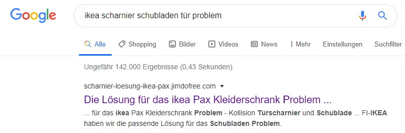

Appel200025 Apr 2021 16:40Müllerin schrieb:
Nice but really expensive. Hettich also offers suitable ones - I don’t have the article number right now though.Hi!
We are currently facing the same problem....
Has the Hettich article number come up in the meantime?
Regards
Appel200027 Apr 2021 21:54Thanks a lot! We'll give it a try with this!
