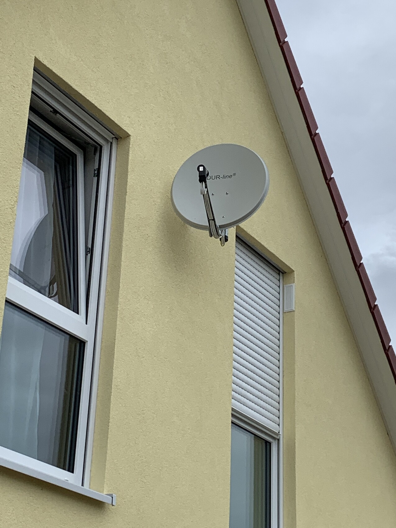

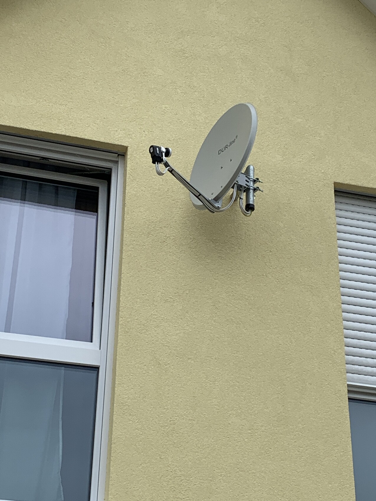

Strahleman23 Aug 2020 09:39We will definitely install a satellite system somewhere on the house. Currently, the telecom provider only offers an 18 Mbit woodline on our street. An upgrade is planned at an unspecified future date. Since we will also handle the satellite distribution in the server cabinet, it will be easy to switch later on (removing the coax cables and adding additional network cables).
At the moment, I am undecided about the location of the satellite system. The electrician charges €760 net for the system plus €70 net for the satellite tile. Installation would be on the roof. Alternatively, I could install the satellite system myself on the east side of the house. However, this would require running cables through the wall. The cheapest option is a Selfsat on the French balcony on the first floor (1st floor). I haven’t settled on a favorite yet, but I currently lean toward the house wall since it allows maintenance access through the attic window.

Satellite dishes on the roof must be grounded. For existing buildings, it’s always a challenge to connect the cable to the equipotential bonding system. No grounding is required on the wall if the cable run is less than 1 meter (3 feet). However, if the dish is planned to be installed via a conservatory or sunroom, accessing the grounding point can be quite tricky (I’ve experienced this before).
I would definitely recommend installing a satellite system, but not buying one from a big-box store or online retailer like Amazon. Most of the time, these end up looking awkward after installation.
