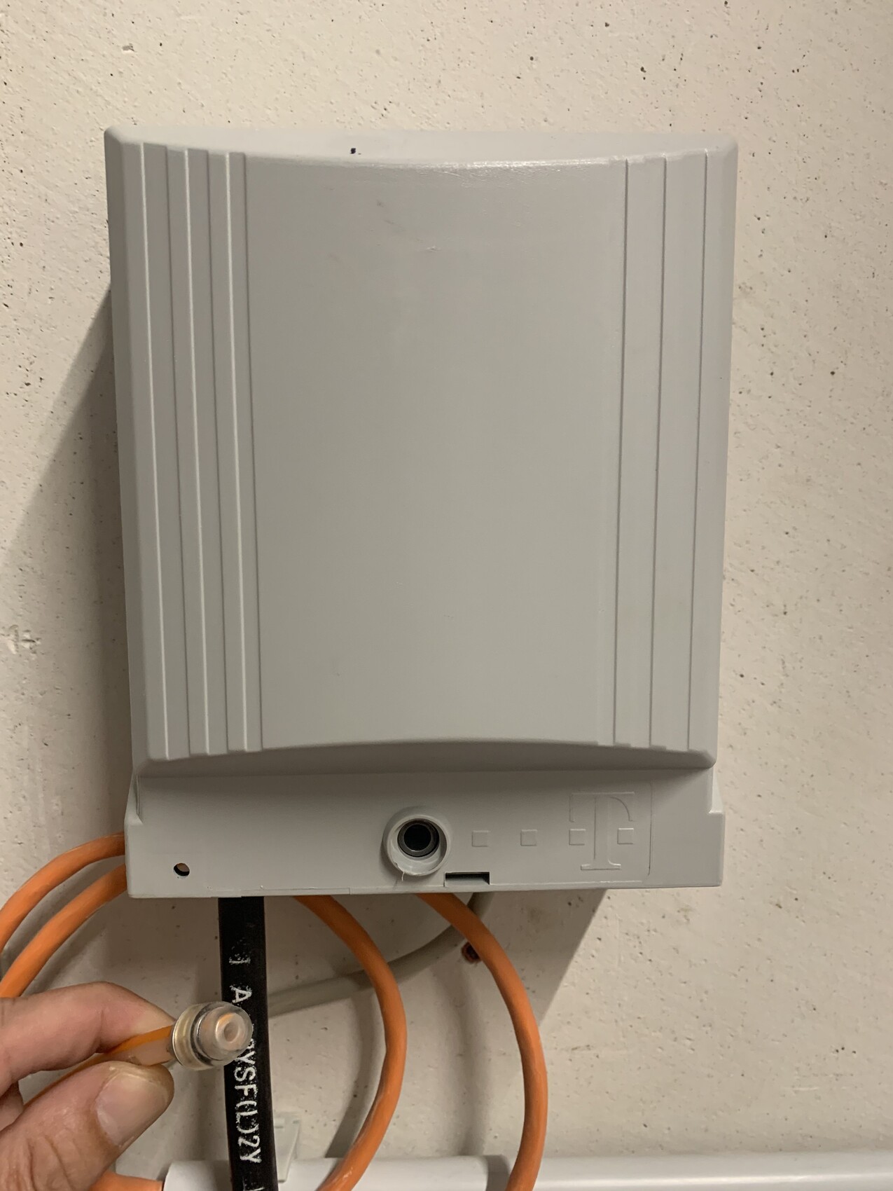

That was poorly phrased. The cable has already been blown in from the street into the house and is now unused. We didn’t actually order it that way, but since it didn’t incur any extra cost, as it turned out, it will just stay there. So if the street is ever connected to fiber optic, it seems we can connect directly.

To be honest, I can’t give you a precise answer. It was only a brief part of my training, and I have no professional experience in this area. This is what it looks like:
