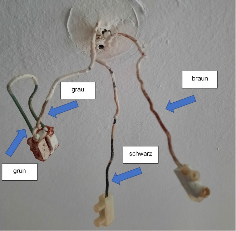

The building was constructed in 1963. Several cables are hanging from the ceiling. 😳 I don’t know which ones need to be connected to the fixture.

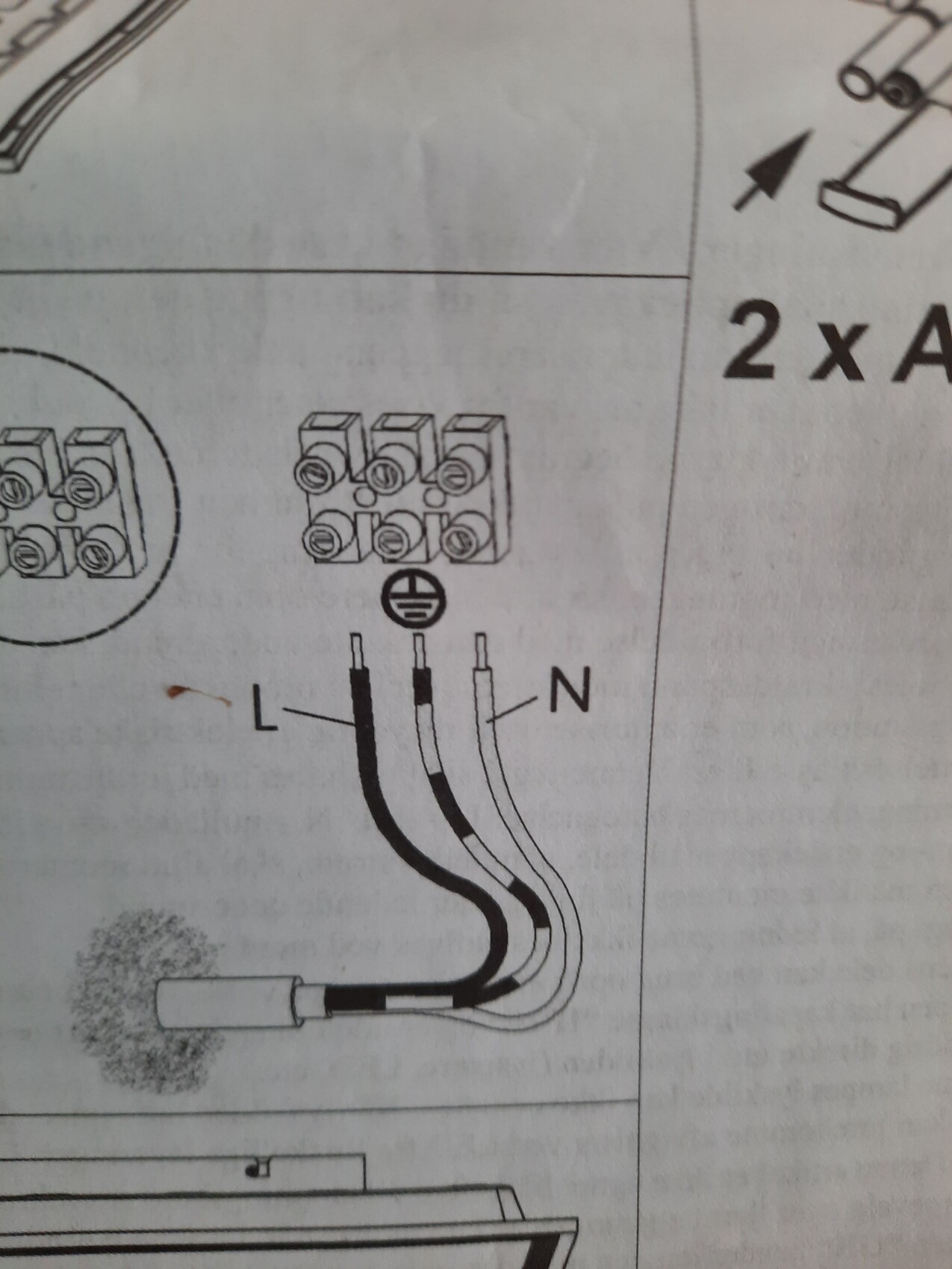

I’m attaching two photos for clarification.

You have 3 cables. One of them is the live wire. You can easily identify it with a voltage tester, also known as a neon tester. It should be the black conductor.
The other two cables are the neutral conductor and probably the earth (ground).
Is an RCD (residual-current device) installed in the distribution board? If yes, you will quickly notice which one is the earth if you connect it instead of the neutral and turn on the lamp. Then the RCD will trip.
If you don’t have an RCD, it doesn’t matter whether you connect the neutral or the earth.
Does the lamp even have a replaceable bulb? From what I read, no.
Are there any metal parts accessible from the outside?
I guess in your case, brown is neutral and gray is earth. Someone might have fiddled with a green cable to mark this.
If it’s actually red and not brown, then @nordanney might be right, and it would be the other way around.
