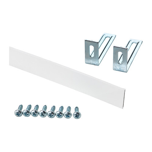

IKEA-Experte13 Jul 2015 00:54Hello,
No, even then the door wouldn’t fully open without the baseboard.
Apply edge banding or
Förbättra
Cover strip and fitting, white
Would it have been smarter to cut the front panel to the length of the other cabinets and then adjust the baseboard so the door can swing under the dishwasher?
How do you seal the cut edge?
Förbättra
hansibansi13 Jul 2015 08:53Thank you very much for the help! I have now bought edge banding.
