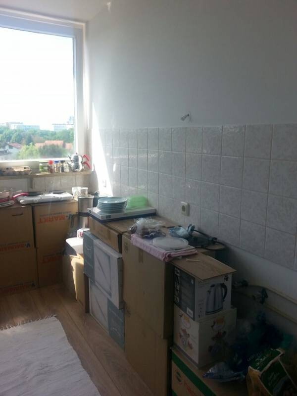

Because the power outlets in my kitchen are at the same height as the standard countertops, my kitchen would need to be installed deeper according to the kitchen planner. For this, we would need plinth legs no taller than 5cm (2 inches).

I would much prefer if an electrician could install the outlets higher. Is a 2.8 cm (1.1 inch) thick countertop planned instead of 3.8 cm (1.5 inches)? Base cabinet feet with 5 cm (2 inches) height won’t adjust any lower than that.

Is it common that you have to handle individual components yourself? Even with a full design plan? Even when you choose the full design option because you want experts to solve technical or craftsmanship-related difficulties...If the product range doesn’t cover the items you need, unfortunately yes. There are quite a few suppliers who accommodate every "special case," but in such cases the furniture is often custom-made, which is reflected in the price.
Just because there is a full design plan doesn’t mean there has to be a solution for you. However, in my opinion, this important information should have been communicated right from the start.
I would definitely prefer if an electrician could install the sockets a bit higher.
Is the countertop planned to be 2.8 cm (1.1 inches) thick instead of 3.8 cm (1.5 inches)?
Toe kicks with 5 cm (2 inches), but they can’t be adjusted any lower than that.Raising the sockets would really be the best solution... unfortunately, the sockets are installed within the wall tiles, so I believe that could significantly increase the kitchen costs.
I heard from a neighbor that their wall tiles are different, and their sockets are installed higher than the ones in my kitchen. That’s why I contacted my landlord... Maybe something can still be arranged.
But the idea about the countertop is brilliant... We actually planned with a 3.8 cm (1.5 inches) countertop, so I would have an extra 1 cm (0.4 inches) available, then the feet you recommended would definitely fit.

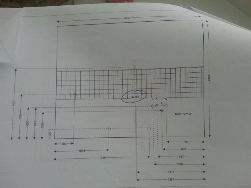

IKEA-Experte11 May 2015 10:14Please provide the exact measurements and upload a photo of the electrical outlets. There might be another possible solution.
