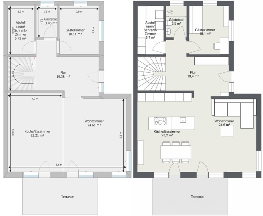

Do you see a way to create a guest bathroom with a shower and a larger work/guest room? Are there fundamental flaws in the floor plan?
Floor plan: ground floor/upper floor, terrace, roof terrace, outbuilding, dimensions and north arrow.
Ground floor plan with living/dining area, kitchen, terrace, hallway, bathroom, and storage rooms.
Upper floor plan with rooms 2–4, hallway, bathroom upper floor, and roof terrace.
Two-story floor plan of a house: ground floor/upper floor with rooms, kitchen, bathroom, hallway, and terrace.

I’ve measured the floor plan a bit more precisely and made a first attempt at furnishing it. Looking at what @K a t j a has already done again makes my effort feel a bit amateurish, but at least you should be able to see that we are putting in effort. The versions with the bathroom in the top left corner and Katja’s original version (sketched by herself, I’m not just forwarding your designs) were sent to the architect today for inspiration. Let’s see what he thinks.
Two house floor plans: kitchen, living room, hall, terrace, guest room, and storage room.
Two-story house floor plan with bedroom, two children’s rooms, bathroom, walk-in closet, and roof terrace.
