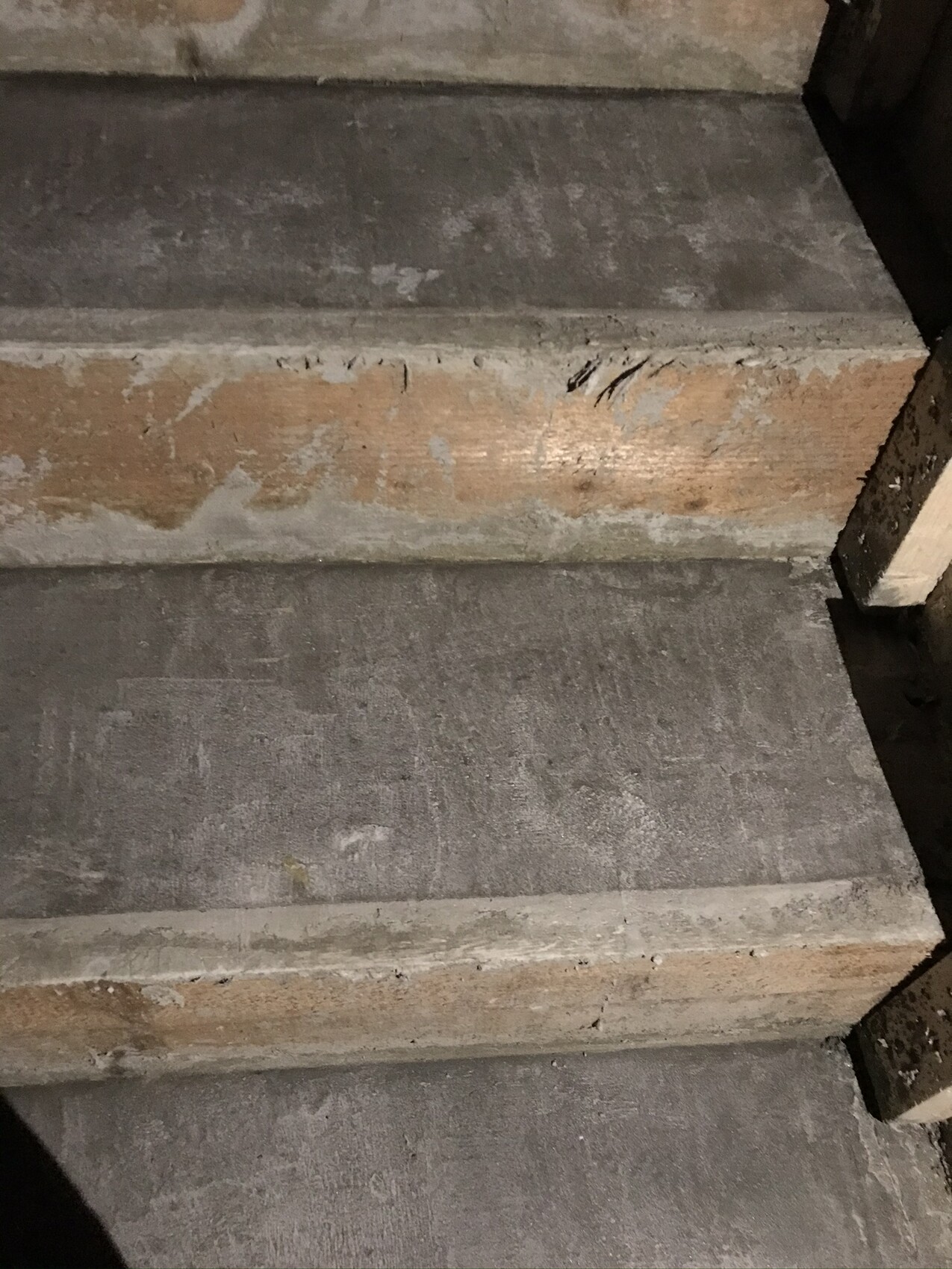

Pfadfinder8720 Mar 2020 09:50A quick update on our staircase: it was poured this week. The formwork hasn’t been removed yet, but you can already make out the treads. I’m not quite sure how I feel about it and will definitely need to see it again in daylight.
For the risers, a smooth, fine, thin board was used for the formwork...
At first glance, it looks quite rough, but it can be refined. The surface is nicely sealed and there are no voids, which is a good start. However, I would have had a chamfer applied to the step edges. With such sharp edges, if someone falls, a bone would definitely be broken. Additionally, sharp edges tend to chip over time and then don’t look good anymore. I would also have it sanded to create a slight chamfer. This needs to be done by someone with a steady hand and enough time to do it properly.
