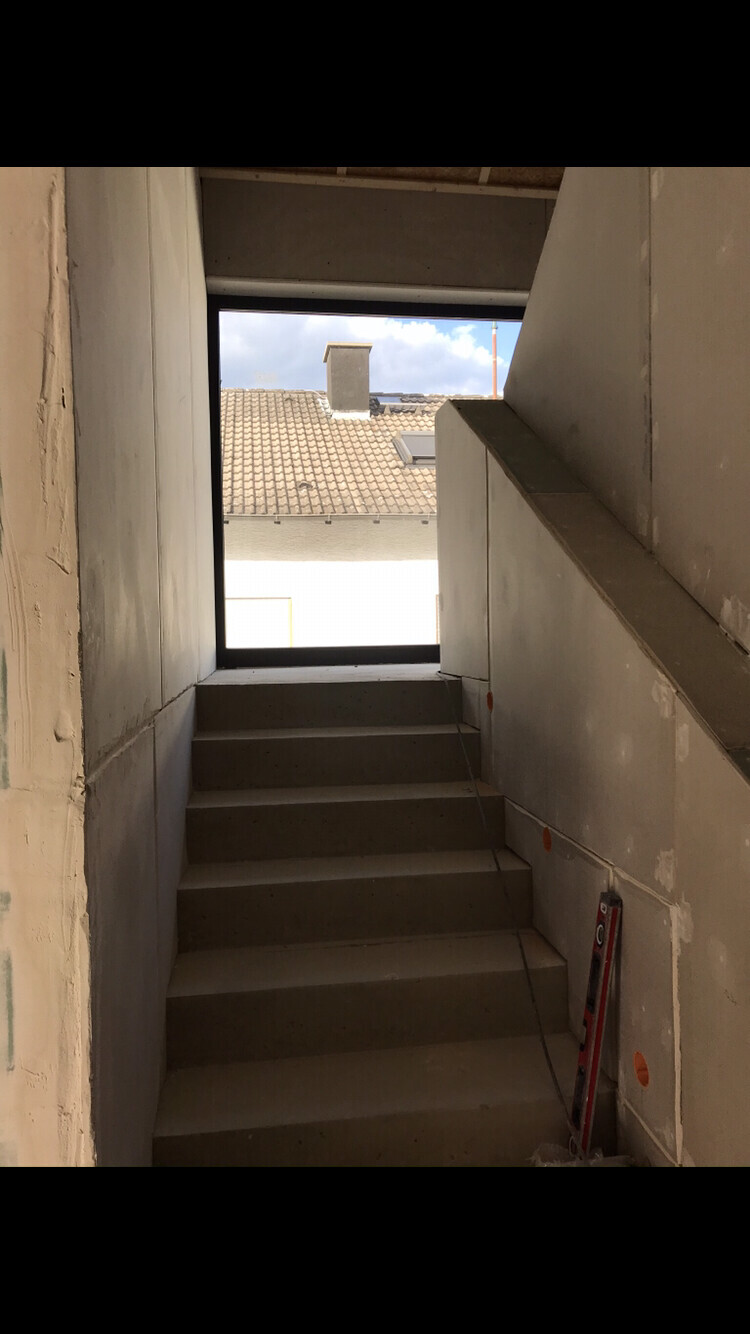

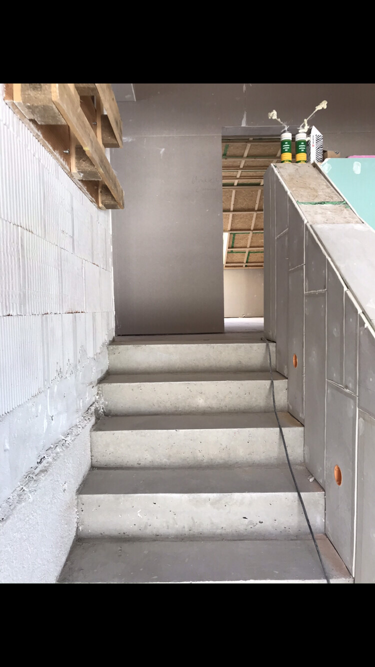

Pfadfinder8713 Oct 2020 22:34Hey,
I should be able to show you some results in about 3-4 weeks. Concrete Ciré will be applied and then sealed. I’m curious myself and a bit worried that it might not meet our expectations.
If you still have enough time, get a quote from a concrete plant for a built-in staircase. Our risers or vertical steps turned out really well with on-site concrete, exactly what we wanted. But unfortunately, the treads are not good at all… sometimes there’s a dip in the back fifth, sometimes a bulge. Then there’s a half footprint on the landing…
I’m attaching some photos. Unfortunately, I don’t have any detailed or recent ones; these are from August. Maybe I’ll remember to take some tomorrow.

However, I believe that FT stairs are not that great. Is your formwork negative? Otherwise, you would have a formed and a troweled surface on the top side, as shown above. I think this is where the problem with the DIY result and expectations comes from.
