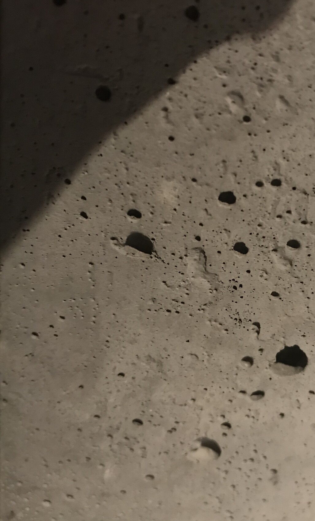

I think I will order exposed concrete from the shell builder and pay the extra €800 (around $880). We can then cover and protect the staircase with a flowing cover. If we don’t like the result in the end, it could still be reworked if necessary. I am attaching a photo of a concrete texture that appeals to us the most; maybe someone can say how well exposed concrete matches this.

Your photo shows at best "poor" fair-faced concrete. Fair-faced concrete is very fine, carefully compacted, and smoothly formed using special oil. The difference is that as few voids as possible are present. The goal is a smooth, closed surface.
If you are doing fair-faced concrete, make sure to communicate this clearly to your stair contractor and agree on a quality level (SB 1-4). Be explicit that no covering will be applied afterward, meaning the steps must be perfectly even and level. I emphasize this because no one here dared to take on this task, and that’s why we chose a precast element from the concrete plant. They can also supply precise chamfers on the step edges, which I imagine would be difficult to achieve on-site with formwork.
Additionally, the fair-faced concrete should be hydrophobized, otherwise it will absorb everything.
During construction, wrap it with boards and fleece.
If something goes wrong, it can still be sanded.
Concrete cire for a straight staircase with 16 steps would have cost about 2,500€ (around $2,600). Just for comparison. That material is very expensive and also labor-intensive to install. Staircases also require sealing to be walkable; otherwise, it’s not practical. We opted to take a simple-quality concrete staircase from the shell contractor’s bill of quantities and instead purchased a precast element for about 4,500€ (around $4,700), including hydrophobizing, packaging, and other small details.
