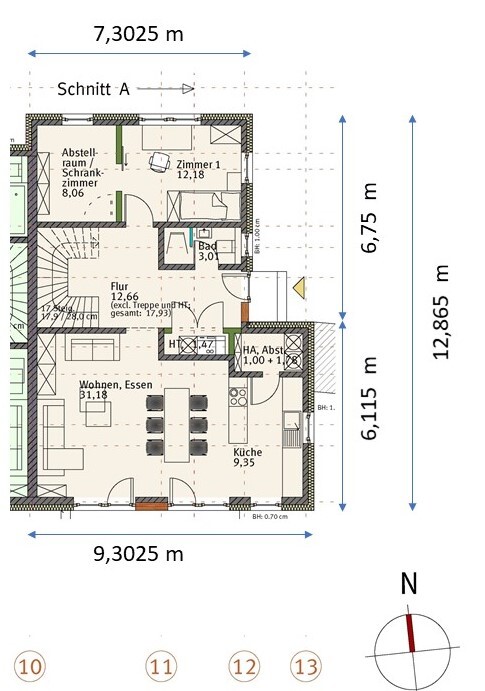

I am referring to version 2, as it addressed some previously criticized points. We are quite satisfied with this plan but still have a few issues and hope for suggestions/ideas. Positive aspects:
- two equally sized children’s rooms upstairs
- larger bathroom than in version 1
- larger living/dining area, although it might still need to be reduced due to space requirements
- practical cloakroom solution
- the southern view. Our small garden is here, with a large field beyond it. The nearest tree in this direction is at least 200-250 m (650–820 ft) away.
What do you dislike? Why?
- guest bathroom on the ground floor lacks a shower
- office/guest room is very small
- missing a clear idea where a TV could go (not very important but something we’d like to consider)
Preferred heating system: an air-to-water heat pump will be installed; the exact location is still flexible.
If you must give up, which details/extensions
-can you do without: bathtub in the upstairs bathroom, slightly smaller living/dining/kitchen area, storage room on the ground floor (the only real storage space)
-cannot do without:
Version 1 was the original design from the project planner in the sales brochure. We requested a different layout for the heating/utility room, a somewhat less spacious staircase to gain space in the second children’s room, and a larger bathroom. The storage room should also be accessible from the hallway.
This led to the creation of version 2, with which we are fairly satisfied apart from the points mentioned above.
The planning is still somewhat informal at this stage. A formal planning meeting has yet to take place. An architectural firm will be involved to handle the detailed design. I get the impression that as much planning as possible is being done now since the current planners belong to the developer, and the architectural firm to be hired afterward would be “more expensive.” Overall, I must say that both before and after the purchase, our wishes have been fairly well accommodated and much is being made possible. For example, we were granted additional land area, a neighbor’s shed was moved to allow direct garden access, etc. I am not a professional but find the changes between versions 1 and 2 quite substantial for a developer purchase.
Do you see a way to create a guest bathroom with a shower and a larger work/guest room? Are there fundamental flaws in the floor plan?

K a t j a schrieb:
I would first be interested in the floor-to-floor height. In version 1 (original?) the staircase has 20 steps. 🤨The floor-to-floor height is 3.03m (10 ft). In version 1 a staircase with 17 steps is planned (the drawing is not exact here), in version 2 there are 16 steps planned.driver55 schrieb:
Just briefly…
Version 2: Living/Dining/Kitchen area is not practically usable. How is the living area supposed to be arranged there?
The total square meters are okay, but the proportions don’t work. You can’t fit everything into 8.6 m (28 feet 3 inches), as you can see. We had put a lot of thought into this beforehand as well, visited a show home with a similar floor plan of the living area, and tried to arrange our furniture as best as possible. Our proposed layout was the kitchen on the right (two rows about 2.7 m (9 feet)) followed by the dining table, 3 m (10 feet) long (1 m (3 feet 3 inches) wide) with chairs on the sides and about 1 m (3 feet 3 inches) space for chairs, which mostly tuck under the table when not in use. That leaves just under 3 m (9 feet 10 inches) for the living room. It’s not spacious, but for us it is the compromise we accept due to the location.
Correct, the building services are located in variant 1 within the pantry, and the hallway recess is designated as a pantry or cloakroom, so these areas are not usable. A washing machine is planned for the hallway recess. Personally, I don’t find that too problematic, for example, separated by a sliding door. But a cloakroom there would, of course, be practical.
According to current knowledge, the building services include a hot water storage tank, the indoor unit of the heat pump, the utility connections (water, electricity), the media distributor, and the heating circuit distributor. I believe that is everything. The detailed planning will be done during the construction planning phase.
Attached are the exterior dimensions of the ground floor. The left wall is 30.25cm (12 inches), the bottom wall is 42.75cm (17 inches), and the remaining walls should all be 36.5cm (14 inches).
Nida35a schrieb:
When I see how full a utility room gets with all the technical equipment—water, electricity, media connections, heating, possibly controlled ventilation, water softening, photovoltaic battery—plan to use your storage room/walk-in closet as the utility room from the start.I had the same idea. However, it seems to be somewhat problematic (routing of pipes and cables, energy-related issues). Also, keep in mind that we need storage space somewhere for suitcases, decorations, and all the other things that tend to accumulate in a house. There is no attic or basement available.
