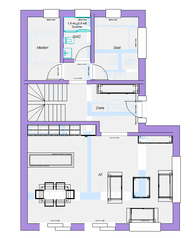

Suggestion:
Floor plan of a house with hallway, stairs, bathroom, media and guest rooms, as well as living/dining area.
Floor plan of a residential house with bedroom (SZ), kitchen (K), bathroom, walk-in closet, and staircase.
Important: Ensure good lighting in the kitchen, as relocating it would make furnishing difficult. The children's rooms have different shapes, but their square meter area is the same. It might be necessary to swap the guest and media rooms depending on their main access. Although this would be unfortunate because of the second window, it is manageable.

Thank you @K a t j a for the great design. I would basically approve the upper floor as it is. Less hallway space, well-sized rooms, and the bathroom is also great.
Regarding the ground floor, there are basically three points:
- I’m still not sure if I can accept placing the kitchen in the darkest corner. I was actually really looking forward to the east and south-facing windows.
- The living room area feels too emphasized. For us, it will just be a corner sofa and maybe an additional armchair, plus a coffee table. A large seating arrangement as planned is not important to us. I also don’t really like the view facing the hallway instead of the garden.
- I think there is not enough space in the storage room. It is the only place for boxes, suitcases, some camping gear, seasonal items... The media room in your design seems to be the same size as in my variant 2. That would make 6.5 sqm (70 sq ft) for storage and all the house technology.
I’ll have a bit more time later and will take another close look.
Thanks again!
Nida35a10 Mar 2022 14:24
@Pacmansh,
I really like the ground floor layout from @K a t j a.
The kitchen, dining, and living room aren’t squeezed into a straight 8.5m (28 feet) line. 🙂
The view from the kitchen (which isn’t too dark unless it’s completely black) goes through the dining area into the garden 🙂 . When you have two kids around, there’s plenty of space to play and keep an eye on them.
There’s room for any kind of sofa with a view of the garden 🙂, plus space to extend the dining table for big birthday celebrations—simply very well planned.
Regarding decoration and suitcases, I’d just say use the attic space, under the bed, etc., like in the rented apartment without a basement.
