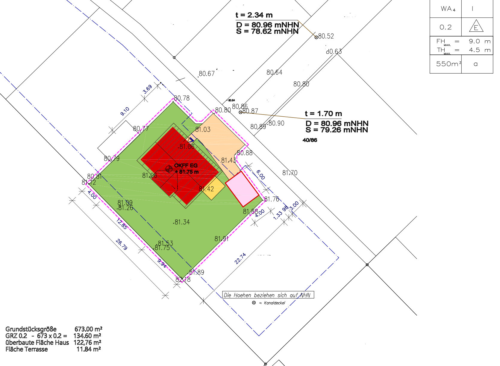

Development Plan/Restrictions
Plot size: 673 m² (7239 ft²)
Slope: 3.5% incline from one side to the other
Floor area ratio: 0.2 (Floor area ratio I: 134.6 m² (1450 ft²), Floor area ratio II: 201.9 m² (2172 ft²))
Building envelope, building line and boundary: see picture (the side lines mark the property borders)
Edge development: new residential area, detached houses
Number of parking spaces: 1
Number of stories: max 1 full story
Roof type: gable roof
Architectural style: captain’s house
Orientation: ridge runs northwest to southeast
Maximum heights/limits: eaves height 4.5 m (15 ft), ridge height 9 m (30 ft), reference point in development plan nearly 1 meter (3 ft) above plot level, brick facing required, dormers allowed on only 50% of the eaves length

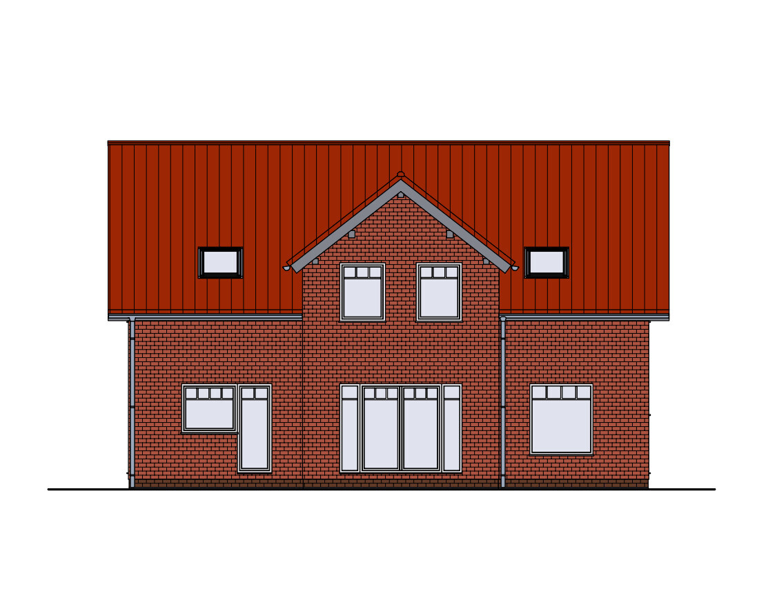

hanghaus200024 Nov 2021 13:03From the outside, it at least looks somewhat better.

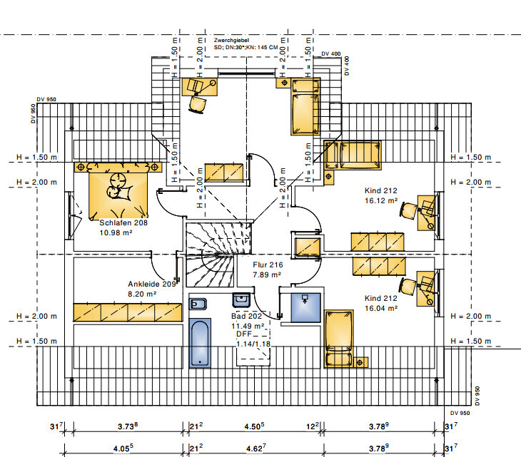

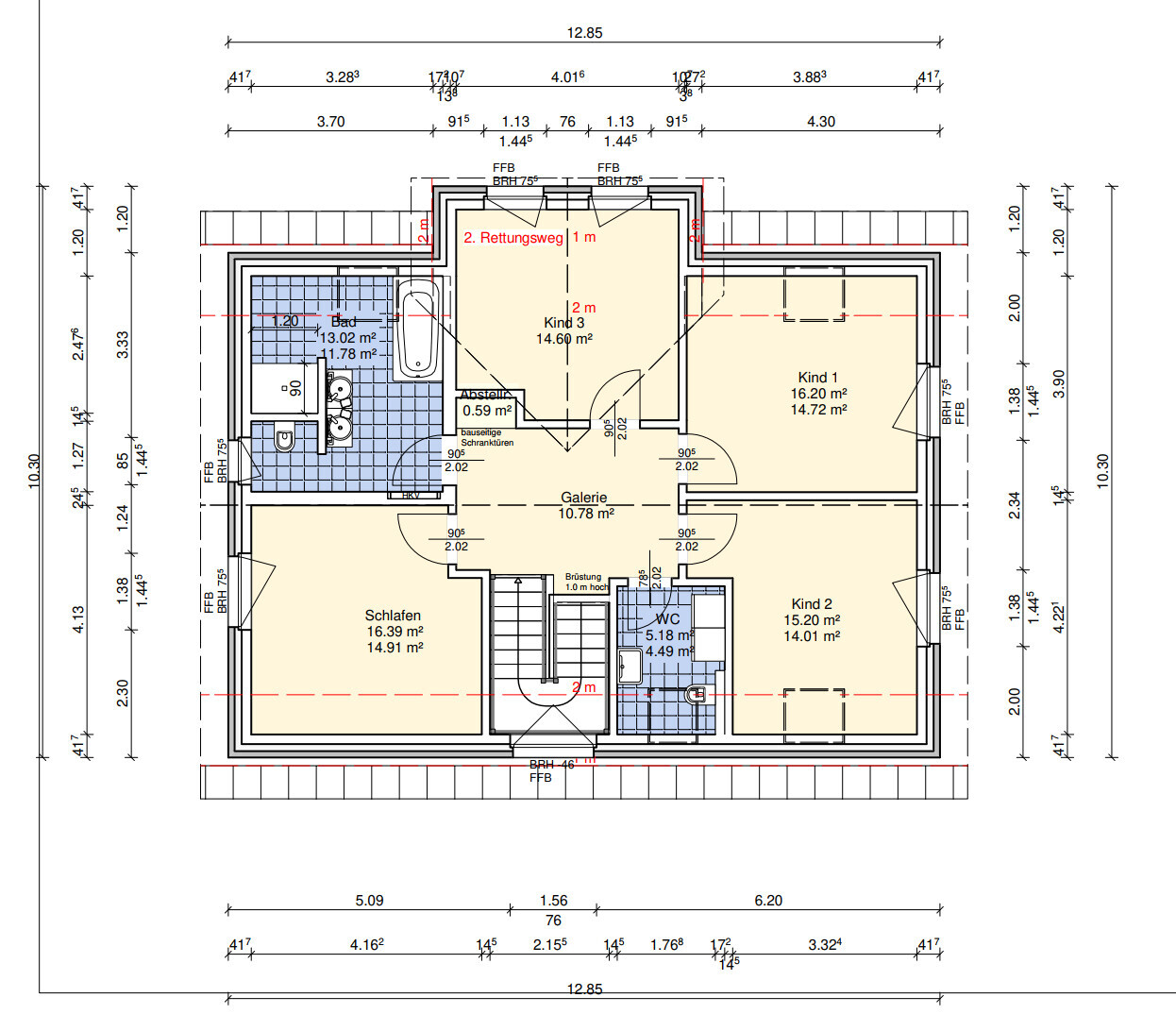

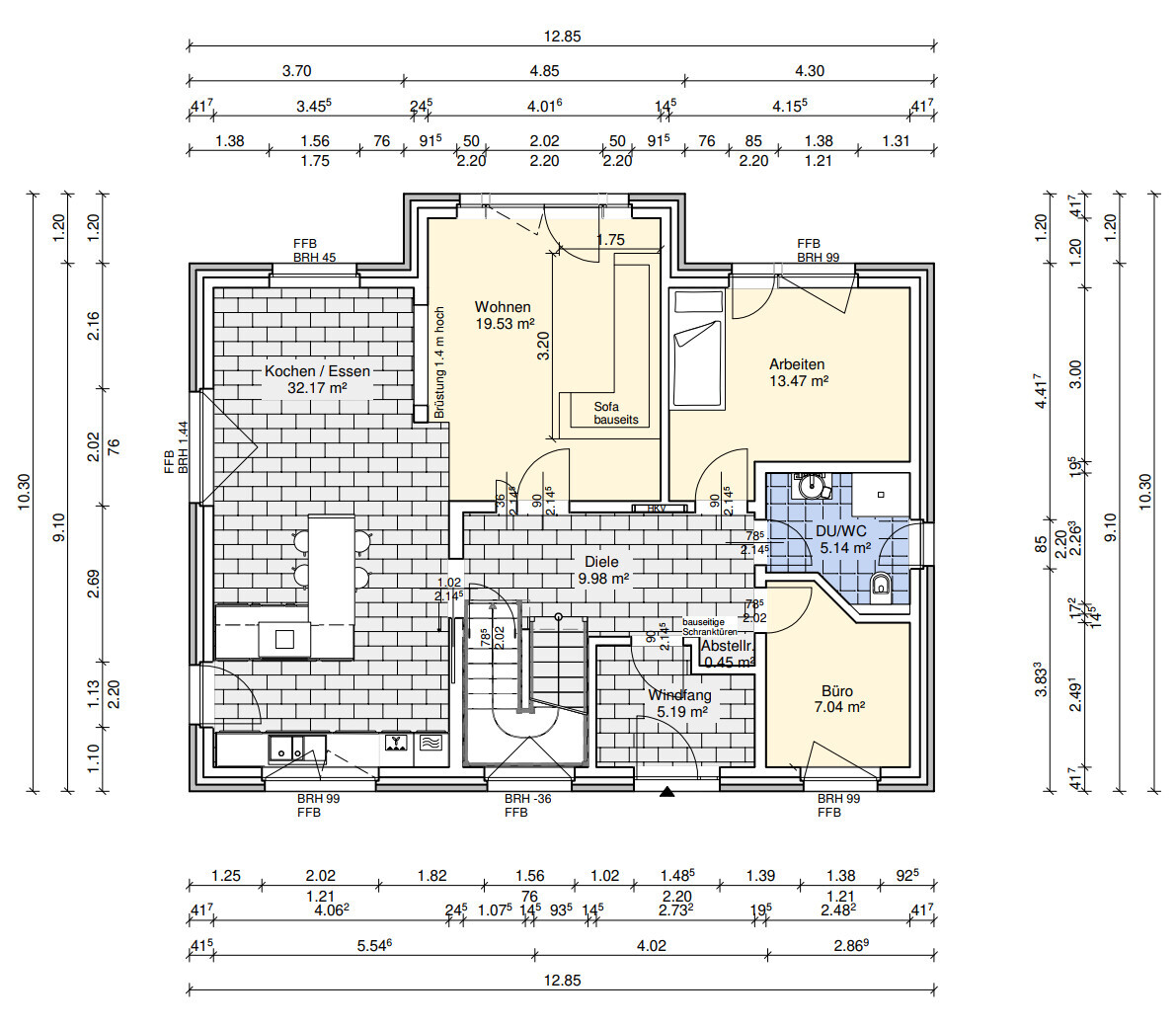

Parents’ bathroom: shower preferably 1 m (3.3 ft) wide and at least 1.2 m (4 ft) long
Kids’ bathroom? Swap the sink and washing machine/laundry tub. In my opinion, a shower should also be added there.

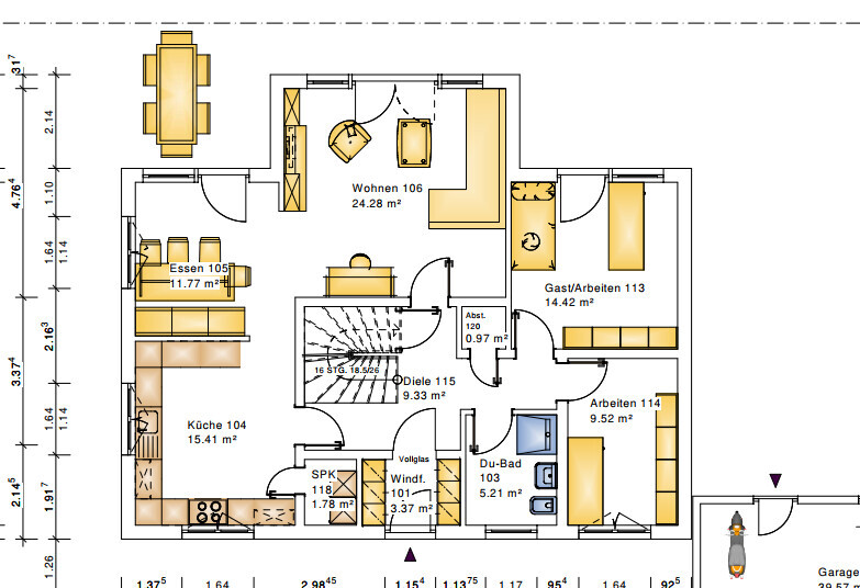

Should the TV be placed against the half-height wall?
blubbernase24 Nov 2021 13:15hanghaus2000 schrieb:
Parents’ bathroom: Shower better 1 m wide and at least 1.2 m long We currently have only a 70 x 70 cm (28 x 28 inches) shower, so everything seems large. However, the bathroom layout is not final yet, so we remain open to changes. We would also like a bigger window. hanghaus2000 schrieb:
Guest bathroom? Swap sink and washing machine/laundry tub. In my opinion, a shower should be added there too. That would mean three showers. We already have two here, and one isn’t used. Our architect has three children and said two are enough. Why swap sinks? I thought it would be more comfortable to have the sink in front of me. hanghaus2000 schrieb:
Is the TV going on the half-height wall? Yes, exactly.K1300S schrieb:

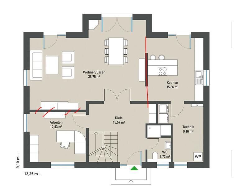

blubbernase24 Nov 2021 15:11K1300S schrieb:

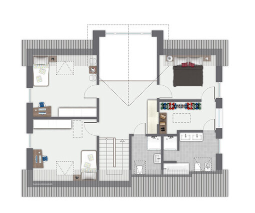

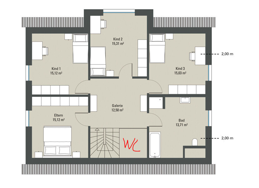

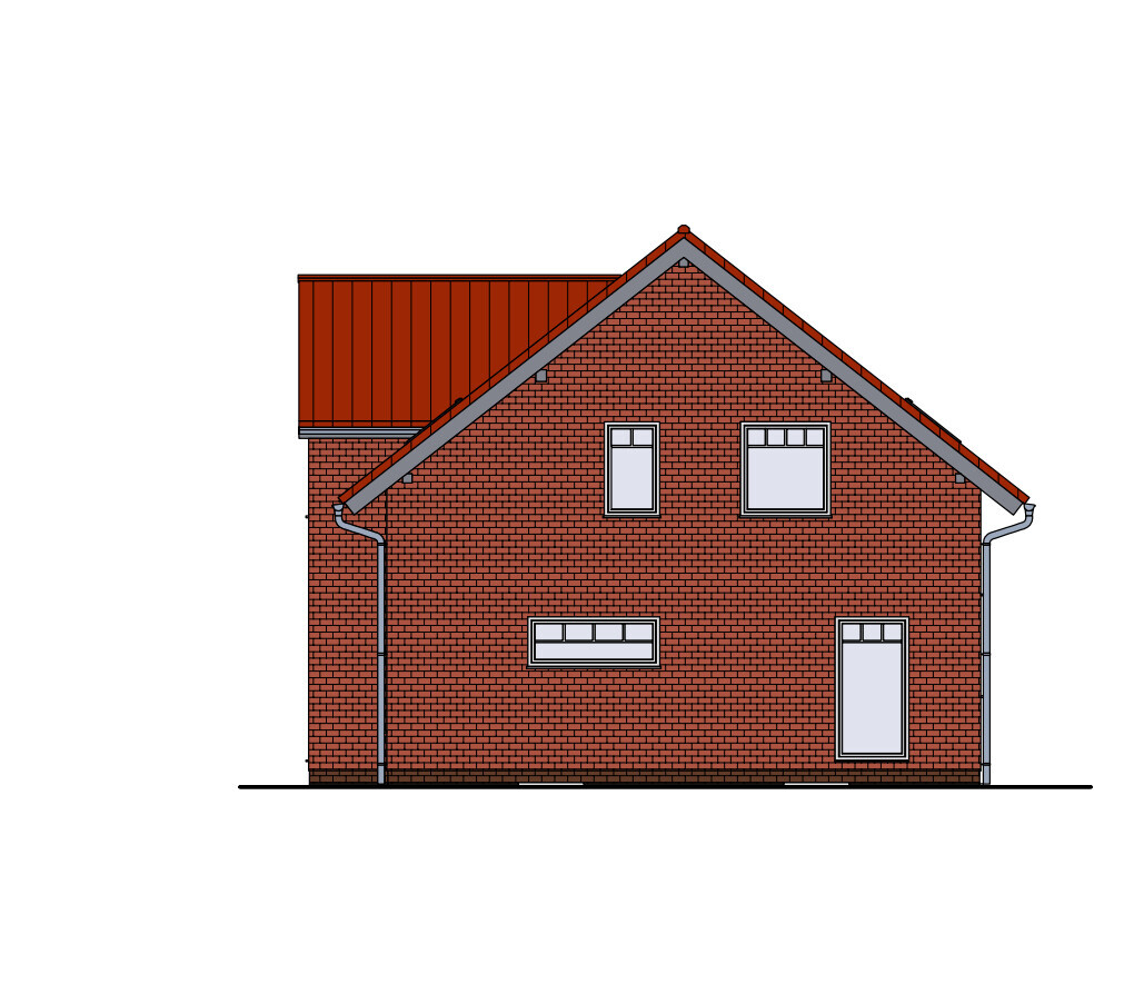

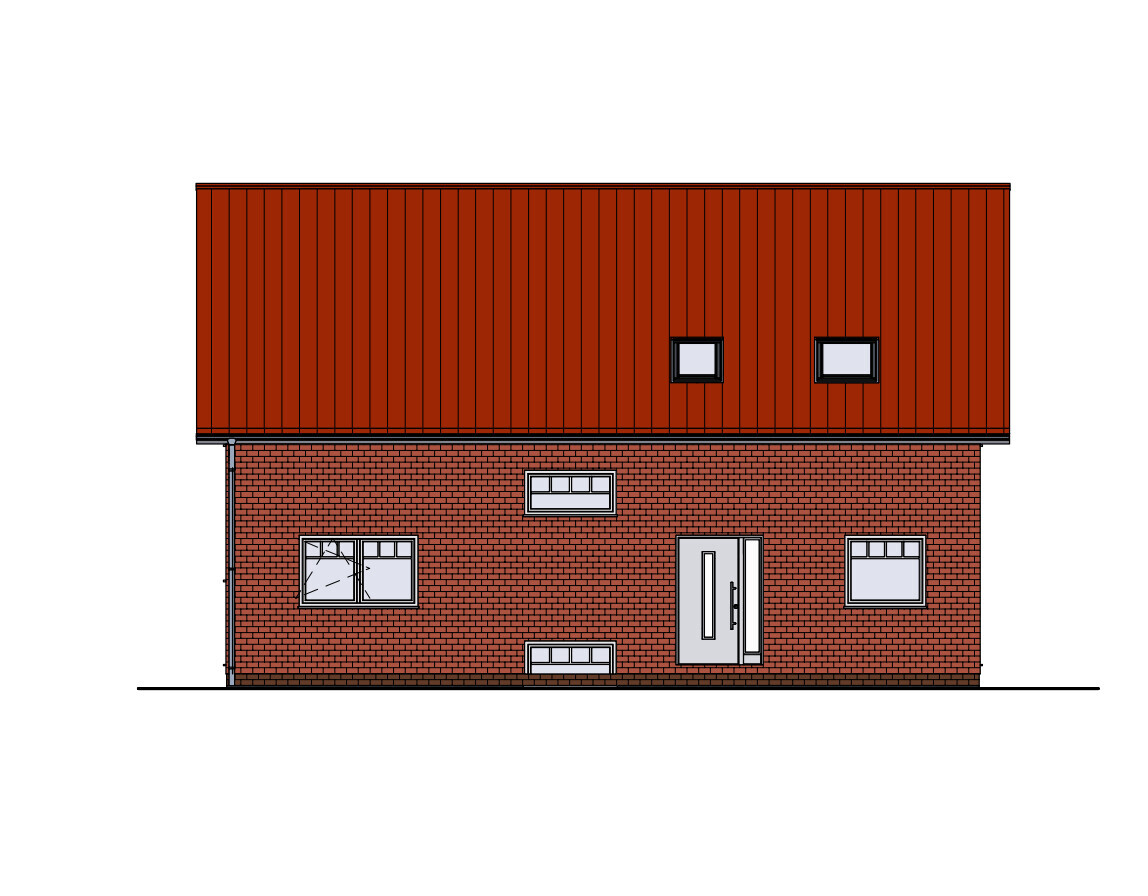

Even though we didn’t quite get along with Gussek Haus at the time, it definitely wasn’t because of the design proposals they presented to us. Both the catalog options and their variations were basically fine and very livable. Of course, if you’re fixed on your own "design" from the start, no matter how good any alternatives are, they just won’t appeal. Do you happen to have one of those designs you didn’t like to show here? Here you go:
Kiefernallee v2 + Sanderau served as the basis for the current design. The similarity to our design was coincidental; we saw that one during the preliminary selection and used it as a starting point.

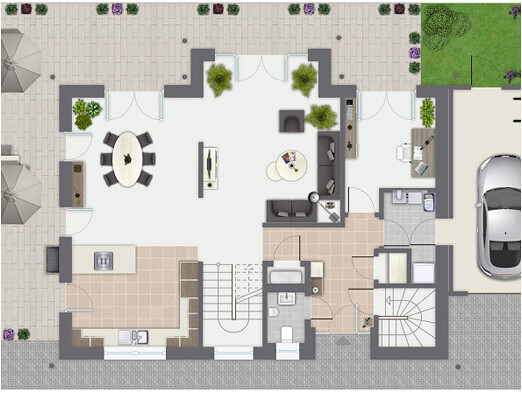

Here is a design from an architect we no longer work with – they only received a list of our priorities but unfortunately didn’t stick to everything and during the feedback meeting simply said for some things, "that’s not possible."
