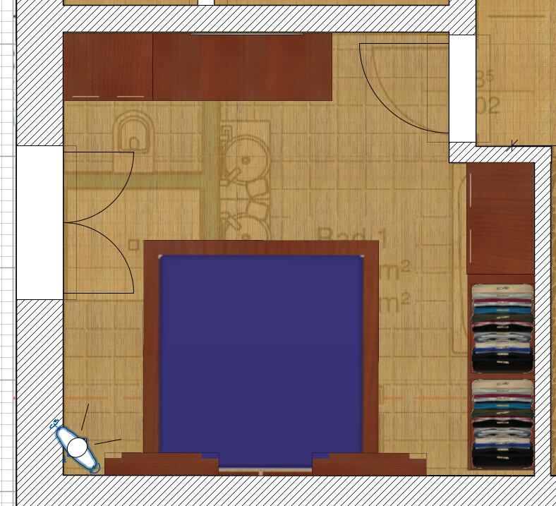

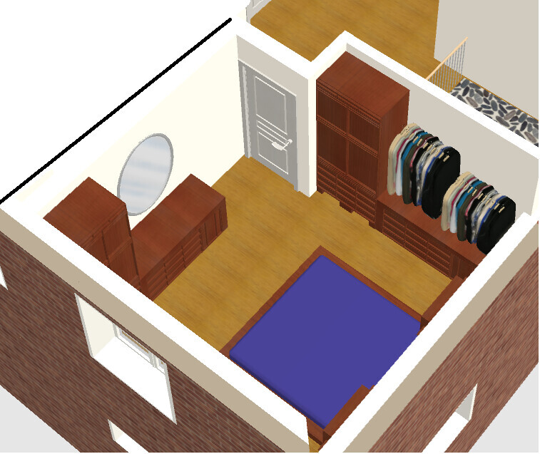

- Closet space in the bedroom? Where?
Like this?
Floor plan of a bedroom with bed and wardrobe as well as doors
3D bedroom with bed, wardrobes, mirror, and wooden floor

No offense, but if everything is already perfect—except for the "not yet final" points—what do you expect to hear from us? You asked for opinions, and the general consensus seems fairly unanimous. Either you take the opinions seriously and let go of your preconceived notions, or this makes no sense at all, neither for you nor for the readers.
blubbernase
25 Nov 2021 09:44
All good.
K1300S schrieb:
No offense, but if everything is already perfect—except for the "not yet final" points—what do you want to hear from us?
I never said it was perfect...? And of course, I want to hear criticism, preferably justified so I can understand it. Just because I don’t immediately reject everything and start over from scratch doesn’t mean I’m not considering it.
K1300S schrieb:
You asked for opinions, and the general consensus seems quite clear.
I don’t see it that way. There are some unnecessary comments that are very general, which I ignore as they are not helpful. If you look back at the longer lists of feedback, we have actually adopted quite a bit of it. The other points are still being discussed here.
K1300S schrieb:
Either you take the opinions seriously and let go of your preconceptions, or this makes no sense at all, neither for you nor for the readers.
Of course, I will not let go of my "preconceptions." The spatial requirements and needs weren’t randomly chosen—they are based on the fact that we have lived in a single-family house rental for 7 years and have thoroughly analyzed our household routines and ongoing processes over the last 2 years, including actually counting who walks which routes and when.
