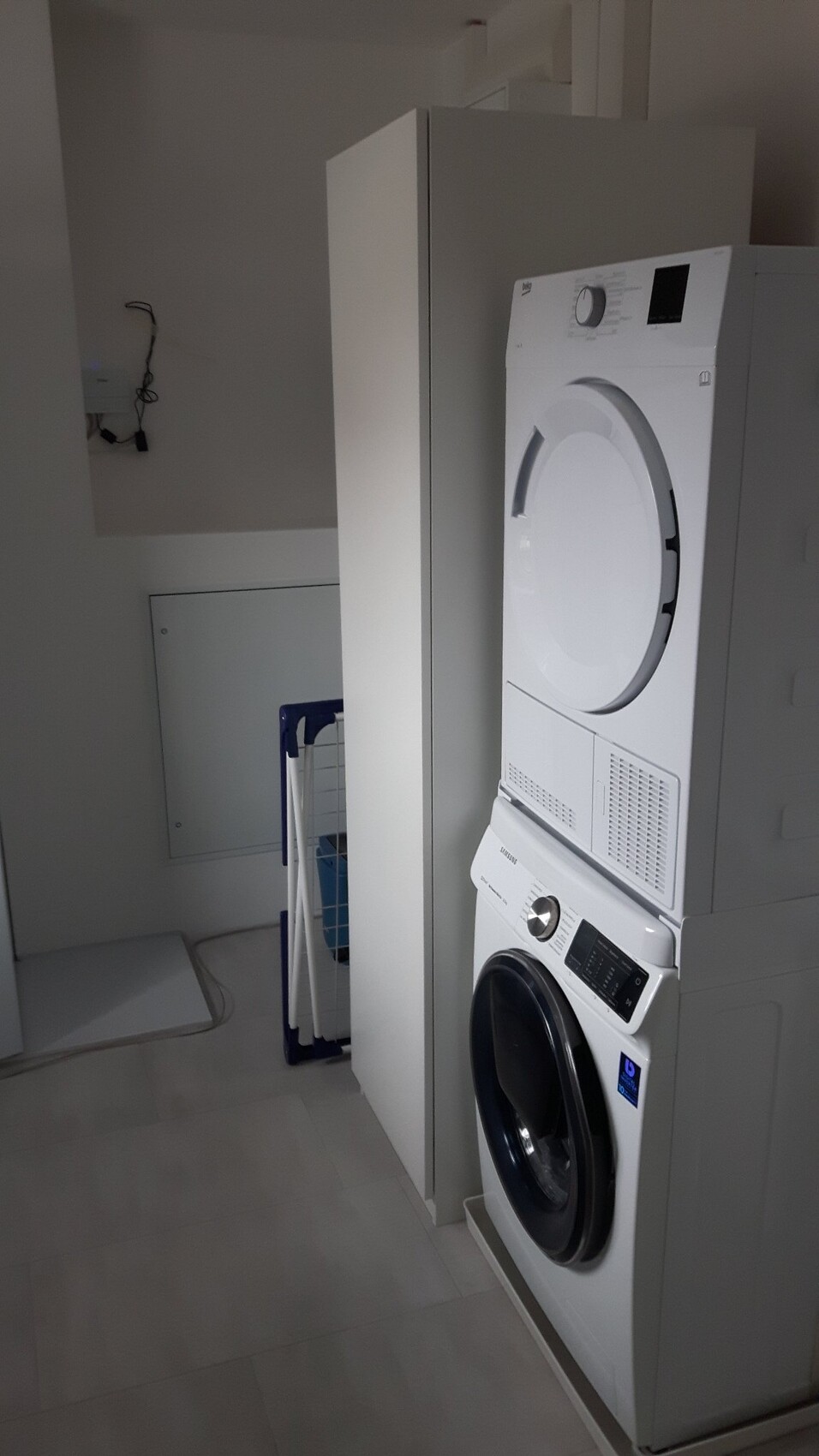

I deliberately decided against such a "tower" setup. It is quite difficult to access the connections and equipment themselves. Secondly, the appliances could move significantly inside the cabinet during washing/spinning/drying cycles. Therefore, if you are going to buy something like this, it should be a really sturdy and stable unit. I placed both appliances stacked with an intermediate drawer in between and secured them with a safety strap. There is also a tray underneath at the bottom, just in case.
