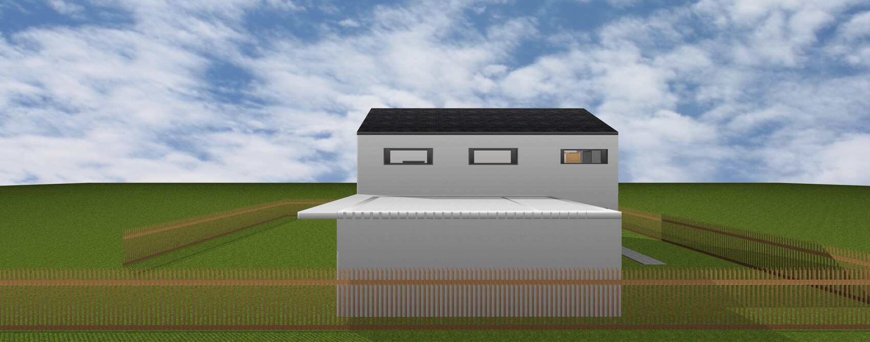

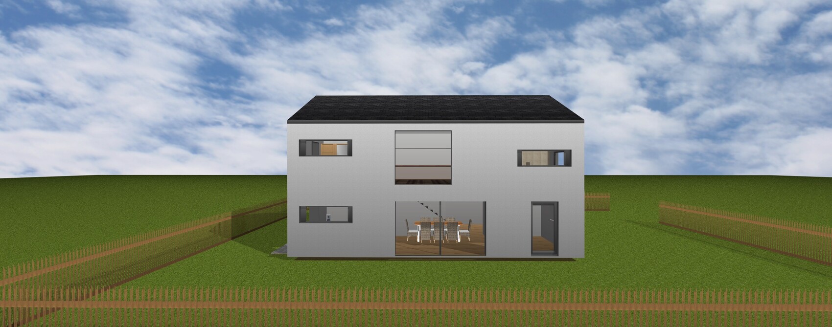

My two cents. Reconsider the window design, because style shouldn’t compromise function.

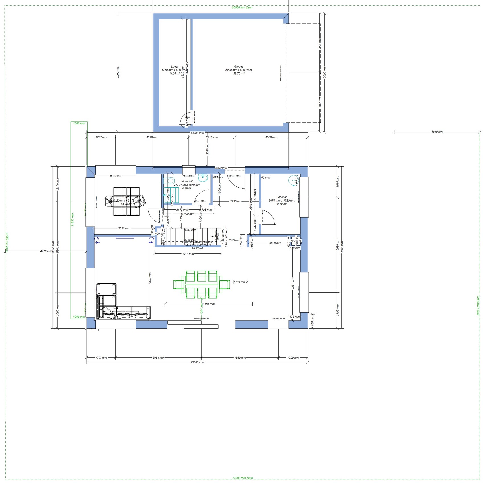

Downstairs: Kitchen to living room, consider a dividing wall with a sliding door. That way it can be open, but doesn’t have to be. Open kitchens always need to be tidy, otherwise it looks like dust bunnies under the sofa...

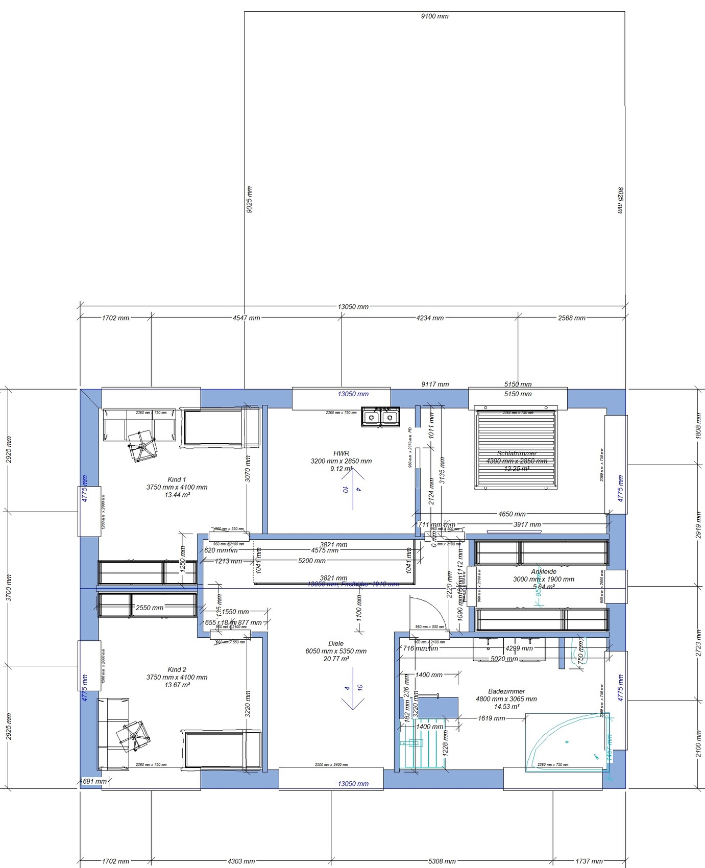

Upstairs: Exchange the bathroom with the small bedroom (Nord KZ), then you can access the utility room through the bathroom. That works. The small bedroom has enough space in what is now the bathroom.
Downstairs, there is indeed a lack of wardrobe space; it’s almost only under the stairs now. It’s doable, but could probably be solved differently with a small compromise in the office. Karsten

I am also looking forward to the new designs. My first impression was that they are quite large; they could probably be shortened by about half a meter (1.6 feet) without losing much functionality.
After reading the comments about the orientation/west-facing view, I took another look at the ground floor layout and no longer understand why you are not considering the view in the living area. It seems you want to place the sofa in front of the window, meaning you will always be sitting with your back to the beautiful view. I find that a bit unfortunate...
