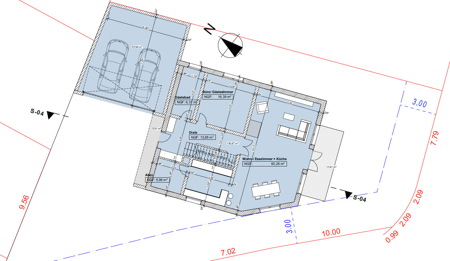

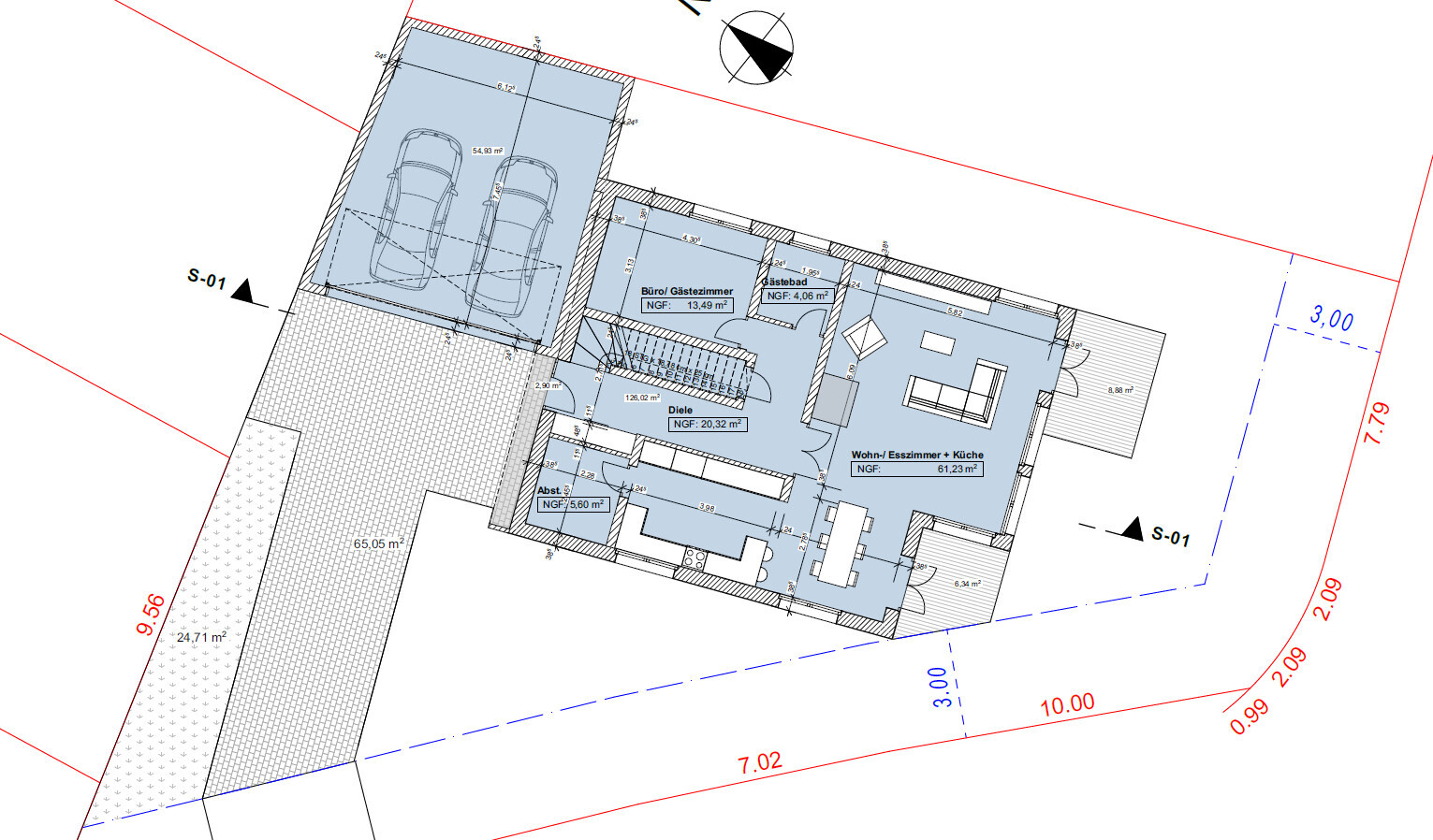

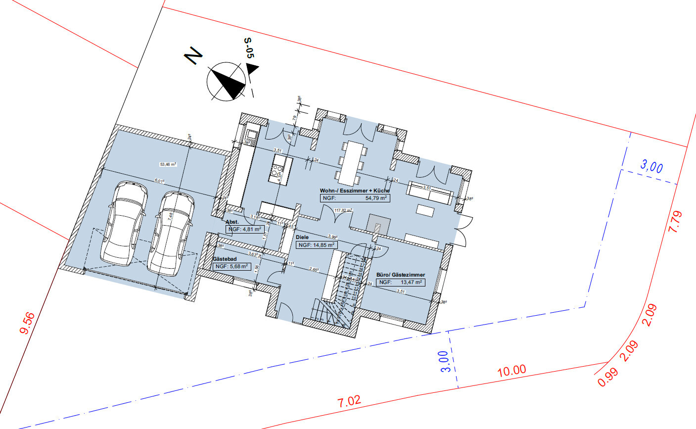

We have now received initial feedback from the architect. Based on the new information, he created example drafts—not aiming for completeness, but mainly to find out what we like. Therefore, only the ground floor is shown to illustrate orientation, layout, etc. The drafts are labeled V1 to V3.
So far, we like draft V2 best. We find the entrance to the house well designed. The living room here could be made smaller to benefit the garden. But without going into detail on each draft to avoid making the post too long and hard to read: What are your thoughts on these sample drafts?

It seems the images were deleted. The upload didn’t work for me last night, so I uploaded and linked the floor plans instead. It should hopefully work now.
Floor plan of a house with double garage, office, guest room, entrance hall, living/dining area + kitchen.
Floor plan of a house with garage, office/guest room, entrance hall, living/dining room, kitchen.
Floor plan of a house with garage, living area, kitchen, entrance hall, office and guest room.

I really like all the floor plan options. In my opinion, number three is the most practical because of the direct access to the kitchen.
