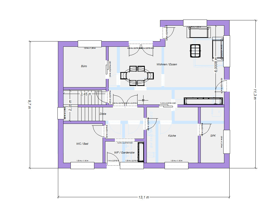

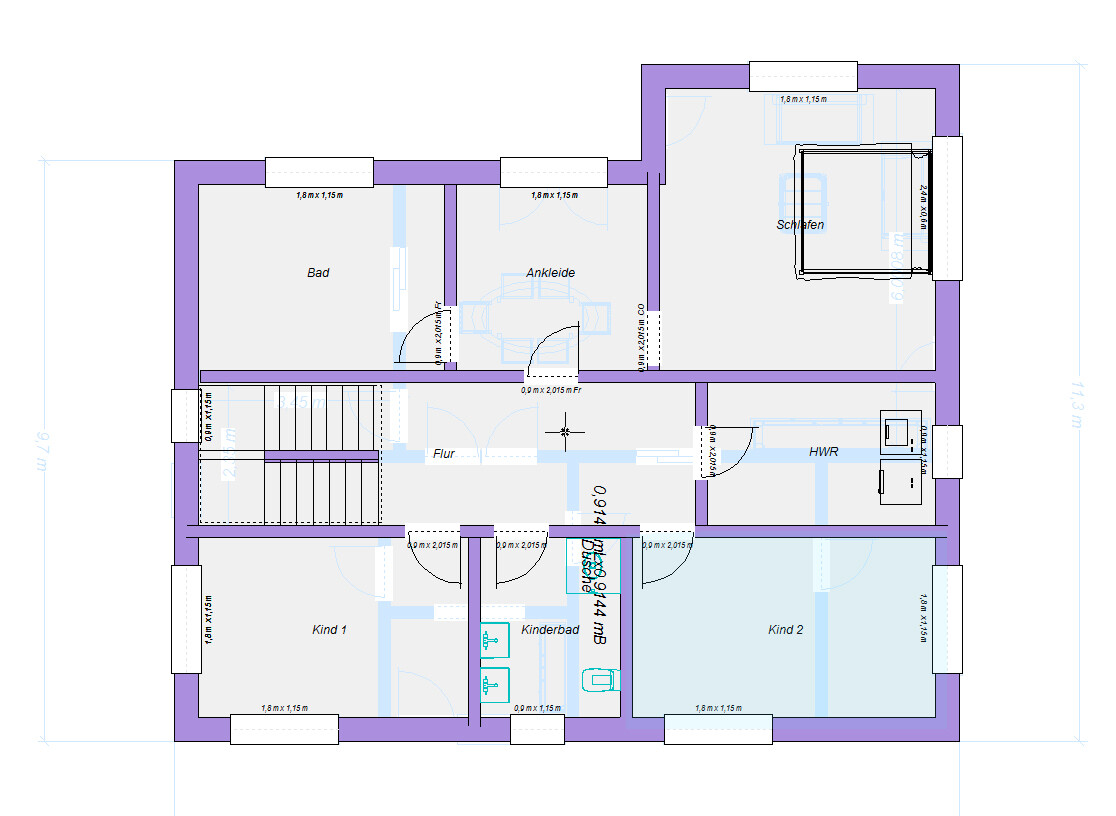

kaho67423 Jul 2017 21:44
It’s an addiction.
Here’s the stair landing again. There might be even more savings possible on the right side of the plan if the exterior wall is shifted.
However, the window situation is somewhat tricky – someone will need to think carefully about it to create an attractive appearance.

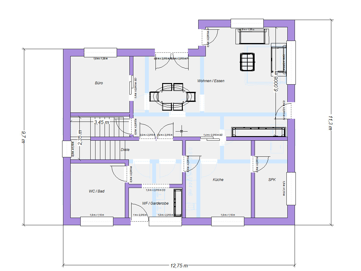

kaho67423 Jul 2017 21:59
Slightly compressed to a width of 12.75 meters (42 feet).
