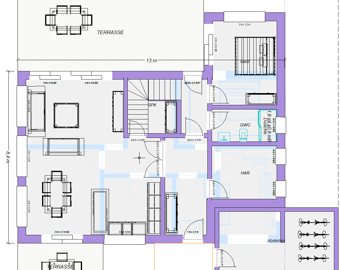

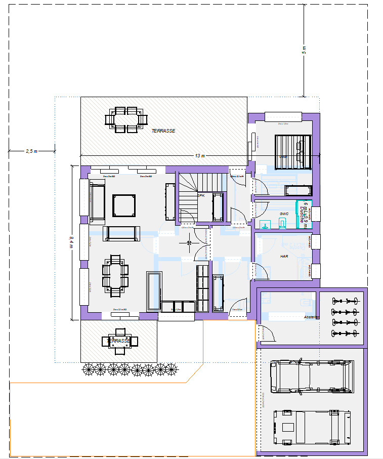

The carport is planned as a double carport on the south side adjoining the recess of the utility room. It is intended to be 5.5 m (18 ft) wide x 9 m (30 ft) long, including a storage room with a length of 3 m (10 ft). Is the planned width sufficient for two cars side by side assuming no SUVs? We plan to use a station wagon like a Skoda Superb and a small car such as a Mercedes A-Class or Toyota Leaf.
The carport positioning is planned as follows:
The house itself would be pushed fully to the eastern building boundary to maximize the western garden area.
The current floor plan from the architect looks like this:
We have already considered some optimizations.
Central to our considerations is adding a second recess on the north side where the living room is, measuring 1 m (3.3 ft) long and 4 m (13 ft) wide, and including a laundry room on the upper floor to house washer and dryer.
This would allow reducing the size of the utility room on the ground floor significantly. We would shorten the utility room by 0.7 m (2.3 ft), leaving about 9 m² (97 ft²). The freed-up space would benefit the guest WC, guest room, and living room.
In the kitchen, we would like to extend the pantry fully along the wall and place the kitchen before it. We have tried to mark our ideas on the floor plan:
Is the kitchen large enough for a household of 3 to 4 people? An island solution will probably be difficult to realize, right?

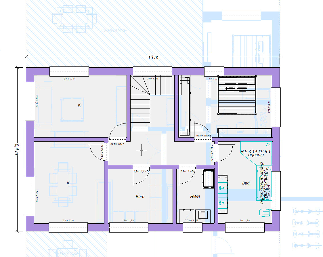

Upstairs, the gained space from the recess would be used for the laundry room. In the plan shown below, we placed the study next to the laundry room; however, we have reconsidered and now prefer to position the work corner where the storage space currently is. The work corner doesn’t need much space, primarily just a desk about 1.60 m (5.2 ft) wide. If there is room for a small cabinet, that’s nice but not essential. Where we marked the study, we would instead plan a walk-in closet. Unfortunately, we have not found a better location for the work corner. We also considered moving it near the children’s rooms, but then the child bedrooms would probably become rather small (about 12–13 m² / 130–140 ft²). These will definitely be adjusted to the same size regardless.

SandyBlack8 Jun 2022 16:36The building permit / planning permission must be obtained and the selection of materials and finishes must be completed by April 30, 2023. Anything after this date will not be considered.
SandyBlack9 Jun 2022 08:18@K a t j a We really like your floor plan with the north-facing terrace. The garden area seems quite spacious for our needs.
We’re just not entirely sure how the staircase is supposed to work. Do you enter it from the living room? Otherwise, wouldn’t you end up facing a wall upstairs?
Do you think it would be possible to move the staircase into the hallway, then relocate the utility room next to the guest bathroom and enlarge the guest bedroom with a bay window accordingly? Upstairs, the floor plan could then probably resemble the one with the south-facing terrace. Or would that not work?
After some puzzling, I keep ending up with something like this:
Maybe it’s better to leave out the hallway door on the ground floor and just have an open passage. However, in my opinion, the entire hallway then feels busy and cluttered. On the other hand, the door is probably open most of the time anyway.
The box is quite huge, and the 25K bonus is probably already maxed out or even exceeded. Trash it or keep tweaking it?
SandyBlack10 Jun 2022 16:19We find it quite promising. We could imagine making the storage room that borders the garage narrower at the front and then moving the guest bathroom, WC, and utility room forward so that they align flush with the front door. Would that make sense?
Additionally, we wonder if it would be possible to narrow the passage to the kitchen, dining, and living areas to allow a bit more space for the kitchen cabinets. We think a single passage would be sufficient. We can’t think of a situation where we would need to close the door. Or do you think the passage would then be too narrow?
Regarding the two doors shown near the stairs, perhaps a passage alone would be enough, or the door to the garden could simply be a floor-to-ceiling window. We already have a large access from the living room.
How large would the pantry be in that case, approximately? If I understand correctly, it would be the space under the stairs plus the area to the right of it, correct?
What are generally the advantages of a bay window compared to a recess? Are these purely financial considerations, or do aesthetics also play a role?
