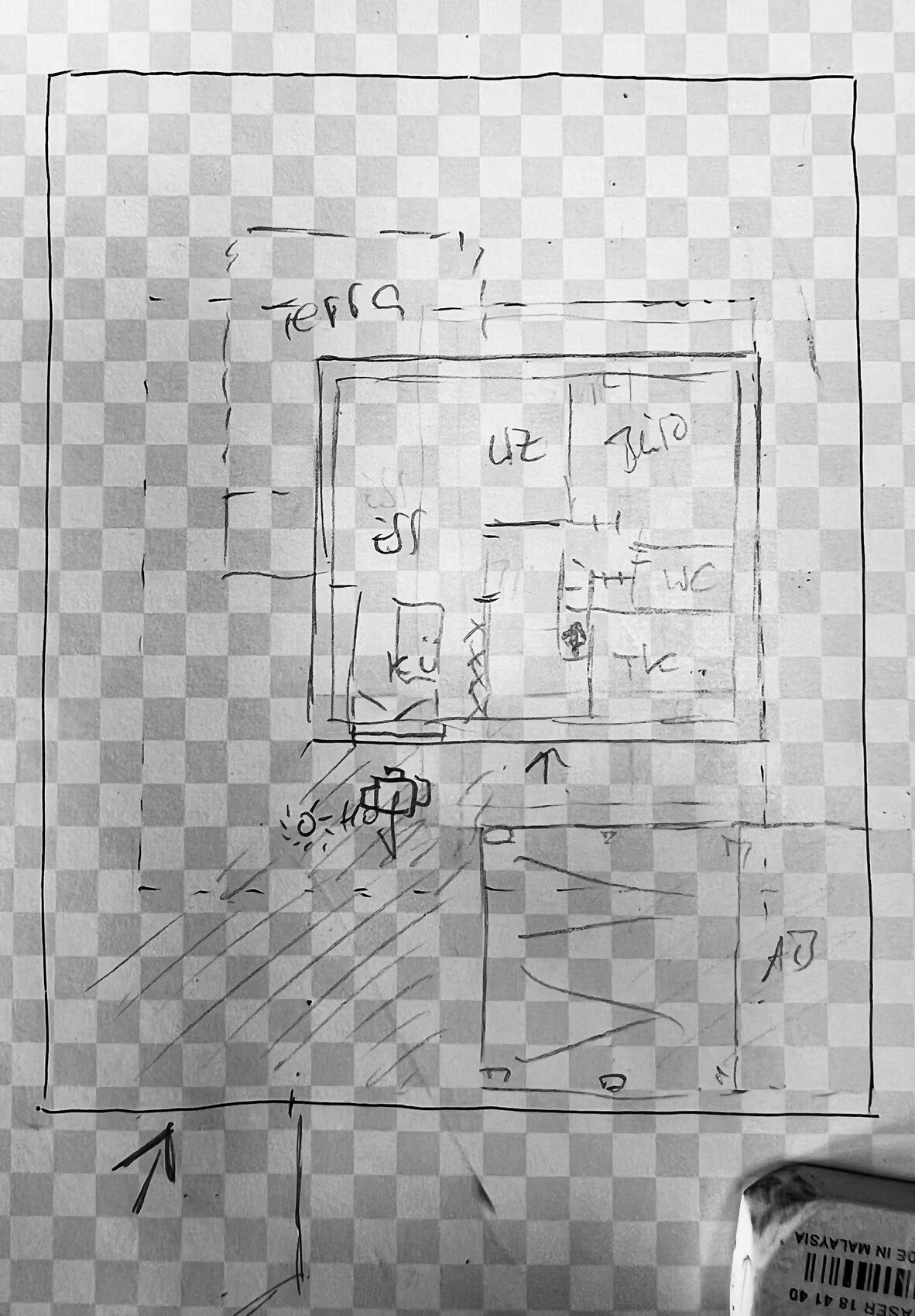

K a t j a7 Jun 2022 11:04
The "maximum height limits" were not filled in. What does the zoning plan say about this?
K a t j a7 Jun 2022 12:15
When I mark the setbacks on your lot, I end up with a building envelope of about 14.4 x 14.45 m (47.2 x 47.4 ft). Could that be correct?
K a t j a7 Jun 2022 14:12
Here is an attempt with the south terrace:
Floor plan of a house with terrace, garden, living and dining area, as well as a garage for two cars.
Floor plan of a house with living room, kitchen, dining area, bathroom, bedroom, hallway, and staircase.

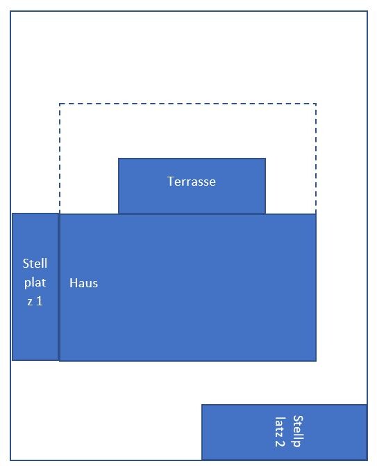

What do you think about the following arrangement:
Floor plan shows house with terrace and parking as blue areas on the plot.
This should be the largest possible continuous garden area. However, we have no real idea how big or long the shadow of the house on the north side really will be. Since we’re building two stories, the house will be relatively tall. Is the shadow really only around 4 meters (about 13 feet)? From the west, there would still be some evening sun, even if the neighboring property is developed. So the question is whether this layout would actually provide sufficient sunlight for us... With children, we’d prefer that they play in the shade anyway 😉. Possibly, we’d also get morning sun from the east for breakfast. I’ve attached the sun path diagram. At least some light could come into the house from the south. Maybe a small sunny courtyard could even be realized. Parking space 1 would probably be designed as a carport with storage, and parking space 2 as a garage with storage. What do you think about this?
