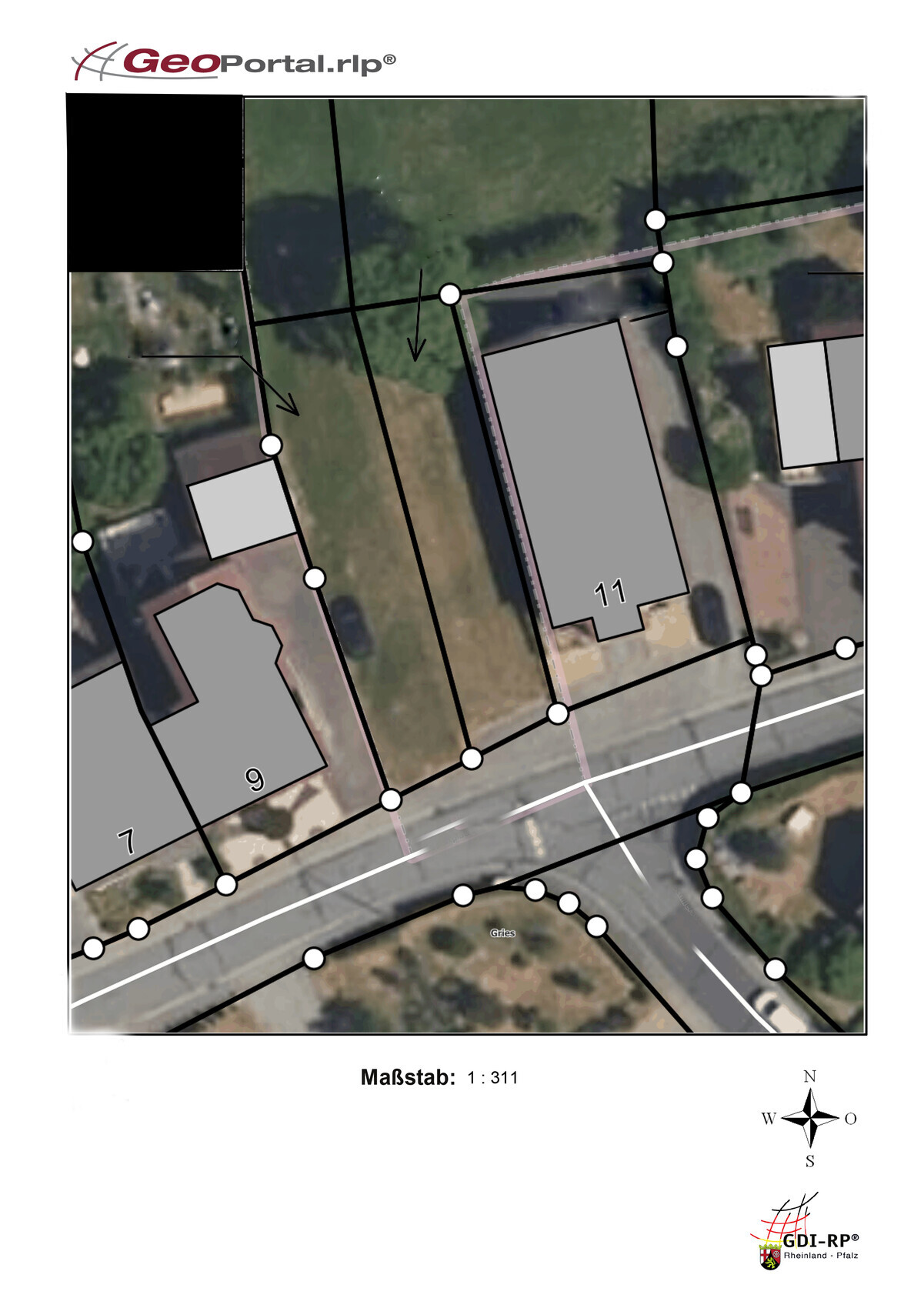

Hebel100023 Sep 2025 08:21Hello everyone,
we are planning to start building our house next year and have already put some thought into the floor plan. You can find a first draft attached.
The plot has already been purchased (Rhineland-Palatinate). Although it is not ideally shaped, the location on the edge of a field and the attractive price convinced us. The garden faces northwest, but in the evenings there is still enough sunlight because next door there is only a hedge about 1.5 m (5 feet) high and a low garage (house #9) – we tested this on site.
We want to position the house towards the rear, facing the field edge, since this area is secluded and offers a nice view due to the gentle slope of the plot. Because of the narrow width of the plot, the possible exterior width of the house is about 7–7.30 m (23–24 feet). The required 3 m (10 feet) setback from the neighbors is observed. Only the neighbor at house number 11 does not maintain this distance, but according to the local municipality, this has no impact on our building permit/planning permission.
At the same time, we are having floor plan proposals prepared by various providers and are looking forward to the results. So far, we have contacted the following companies:

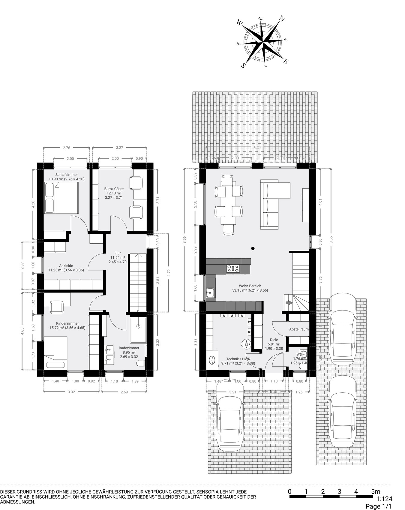

Notes BEFORE the floor plan:
- The selection of providers ranges across very different “leagues.” It’s roughly like comparing Audi and Dacia at the same time.
- The §34 regulation makes things a bit more complicated (for example: Are brick façades even allowed if there are none in the neighborhood?). I would recommend a different approach here: work with an architect to create a preliminary design and submit a building inquiry (building permit / planning permission inquiry). Only after that is approved should you sign the construction contract. Otherwise, it can happen that the building authority ultimately says, “The house design does not correspond to the neighboring buildings.”
- Also, the budget should be clearly considered here. Including brick façades in the price expectations will be tight. (We had a development plan requiring brick façades and had to take care of that. It is noticeably more expensive than a plaster façade.)
The floor plan itself:
The plot imposes quite a few conditions. I noticed a few things, although much is also dictated by the shape of the house, which is set by the plot.
- There are hardly any windows facing east. Is there a reason for this?
- Depending on the situation with children and guests, the staircase in the living room could be disruptive. I would consider the following: move the staircase forward to where the storage room currently is, and position the storage under the stairs (and extend it if needed). This way, there would be no “through traffic” in the living room anymore. It would also be possible to plan some type of door (regular, sliding, or similar) between the living room and hallway for more privacy if there is more traffic.
- Bathroom: Is there no bathtub planned, or is the shower and bathtub combined?
- The walk-in closet is quite large. It doesn’t need that much “dance floor” space in the middle. I would consider slightly reducing it and instead enlarging the children’s room marginally towards the top of the plan. (For example: 80cm (cabinet + 20cm clearance) + 100cm (window) + 80cm (cabinet + 20cm clearance) would very likely be sufficient for the walk-in closet and would give the children’s room 27cm (about 11 inches) more space—enough room for bookshelves behind the door or similar.)
Overall, I really like the plan given the constraints imposed by the plot. The only thing that would drive me crazy (warning: very subjective!) is the staircase in the living-dining area.
Hebel1000 schrieb:
§34Is a two-story house allowed?What does the neighboring development look like?
Papierturm schrieb:
- There are hardly any windows facing east. Is there a reason for that?Probably because of the neighbor. What does the neighbor have there?Basically, it should be feasible. Unfortunately, I can't judge the dimensions well enough to tell if a lot is planned too tightly.
You could still refine the upper floor since the dressing room for the ballroom takes up a lot of space. The bedroom is probably much too narrow since a bed around 2.20 m (7 ft 3 in) long won't fit snugly against the wall. Then you wouldn't have a passageway to the window or the other side of the bed.
The facade design on the north side might also look off.
In my opinion, a width of 6.20 m (20 ft 4 in) is too narrow to fit a dining table and sofa area side by side. Also, anyone sitting or relaxing probably wouldn’t enjoy seeing the front door directly from there.
A suggestion: place the living area opposite the stairs and locate the kitchen by the terrace to improve the overall layout.
Marvinius201623 Sep 2025 23:03A plot that is 13 to 14 meters (43 to 46 feet) wide is actually too narrow for a proper building project. You often end up with a kind of townhouse floor plan, even though it is supposed to be a detached single-family house. Tip: Don’t buy anything less than 18 meters (59 feet) wide.

Marvinius2016 schrieb:
Tip: Don’t buy anything less than 18m (59 feet) wideWell, that’s a bit late now. I also find that quite patronizing.I think the floor plan is pretty good. The staircase in the living area would have bothered me too. Maybe separate it off; it doesn’t have to remain open on the left side. Moving it toward the storage room would probably cause issues with the bathroom upstairs.
Upstairs, you just have to be careful that there is enough headroom despite the pitched roof.
By the way, I also have a house 7m (23 feet) wide and live very comfortably in it.
