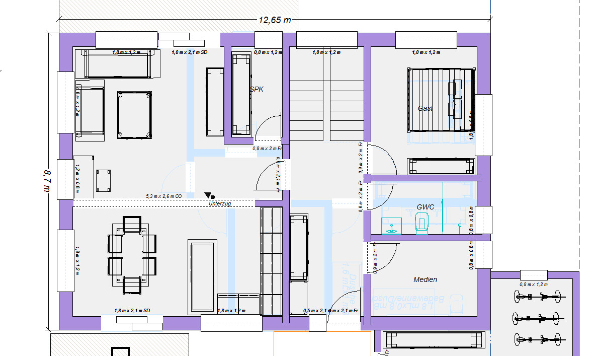

The current floor plan from the architect looks like this:
We have already considered some optimizations.
Central to our considerations is adding a second recess on the north side where the living room is, measuring 1 m (3.3 ft) long and 4 m (13 ft) wide, and including a laundry room on the upper floor to house washer and dryer.
This would allow reducing the size of the utility room on the ground floor significantly. We would shorten the utility room by 0.7 m (2.3 ft), leaving about 9 m² (97 ft²). The freed-up space would benefit the guest WC, guest room, and living room.
In the kitchen, we would like to extend the pantry fully along the wall and place the kitchen before it. We have tried to mark our ideas on the floor plan:
Is the kitchen large enough for a household of 3 to 4 people? An island solution will probably be difficult to realize, right?
Upstairs, the gained space from the recess would be used for the laundry room. In the plan shown below, we placed the study next to the laundry room; however, we have reconsidered and now prefer to position the work corner where the storage space currently is. The work corner doesn’t need much space, primarily just a desk about 1.60 m (5.2 ft) wide. If there is room for a small cabinet, that’s nice but not essential. Where we marked the study, we would instead plan a walk-in closet. Unfortunately, we have not found a better location for the work corner. We also considered moving it near the children’s rooms, but then the child bedrooms would probably become rather small (about 12–13 m² / 130–140 ft²). These will definitely be adjusted to the same size regardless.
Maybe you have some ideas.
The windows on the ground and upper floor are not finalized yet; these are currently placeholders.
We welcome all comments 🙂.

I was thinking something along these lines:
Usually, people don’t like sitting with their back to the door. I would also try to keep the walking paths generously clear. But ultimately, you can arrange it however you prefer.
By the way, I suspect that a load-bearing beam might be necessary. Nowadays, this can usually be planned well and concealed. The question is how willing or capable the company is to do this, and whether it even bothers you. So think carefully about whether this is a deal-breaker.
SandyBlack14 Jun 2022 06:48A beam beneath the ceiling wouldn’t bother us. On the contrary – if made of wood, it can actually look really attractive.
But we will definitely bring it up. Thanks for the tip!
Benutzer 100114 Jun 2022 07:07@K a t j a
It's always fascinating how well you handle the floor plans. Thank you.
Regarding the stairs, we have a half-turn staircase, and the children manage it very well. I think it saves at least 70-80cm (28-31 inches) in depth compared to a staircase with a landing. If that space were available, I would definitely choose a staircase with a landing, as I find it more aesthetically pleasing.
SandyBlack14 Jun 2022 09:19The development plan does not specify anything regarding this – therefore, I assume so.
