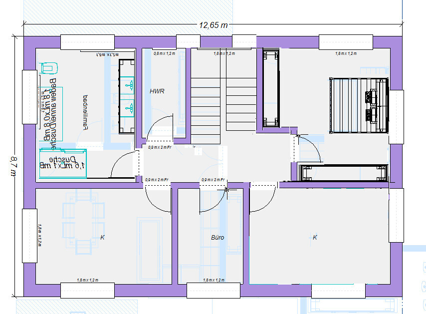

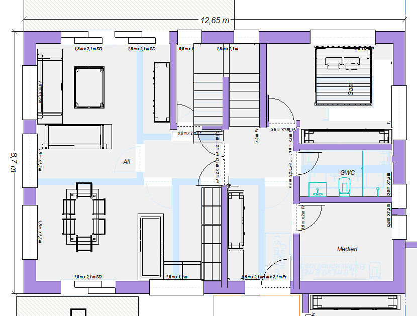

The current floor plan from the architect looks like this:
We have already considered some optimizations.
Central to our considerations is adding a second recess on the north side where the living room is, measuring 1 m (3.3 ft) long and 4 m (13 ft) wide, and including a laundry room on the upper floor to house washer and dryer.
This would allow reducing the size of the utility room on the ground floor significantly. We would shorten the utility room by 0.7 m (2.3 ft), leaving about 9 m² (97 ft²). The freed-up space would benefit the guest WC, guest room, and living room.
In the kitchen, we would like to extend the pantry fully along the wall and place the kitchen before it. We have tried to mark our ideas on the floor plan:
Is the kitchen large enough for a household of 3 to 4 people? An island solution will probably be difficult to realize, right?
Upstairs, the gained space from the recess would be used for the laundry room. In the plan shown below, we placed the study next to the laundry room; however, we have reconsidered and now prefer to position the work corner where the storage space currently is. The work corner doesn’t need much space, primarily just a desk about 1.60 m (5.2 ft) wide. If there is room for a small cabinet, that’s nice but not essential. Where we marked the study, we would instead plan a walk-in closet. Unfortunately, we have not found a better location for the work corner. We also considered moving it near the children’s rooms, but then the child bedrooms would probably become rather small (about 12–13 m² / 130–140 ft²). These will definitely be adjusted to the same size regardless.
Maybe you have some ideas.
The windows on the ground and upper floor are not finalized yet; these are currently placeholders.
We welcome all comments 🙂.

Yes, more rooms mean more light switches, power outlets, etc. This should not be underestimated. A large room is cheaper than three smaller ones, even if their combined floor area is the same.
The structural engineer will probably still frown a little at the last floor plan. Most likely, they will add a beam or something similar in the living room.
Let’s wait and see what the architect comes up with. In the end, we’ll combine everything, mix it up thoroughly, and see what remains. 😀 😉 🙂
SandyBlack11 Jun 2022 20:31I will definitely do that. I expect that we will also receive feedback from our architect next week.
SandyBlack schrieb:
So far, we like the floor plan best.I also find it well done. Compliments to @K a t j a SandyBlack schrieb:
The staircase with landing is great. Would there be any reason not to include a storage room under the stairs?The stairs could also be integrated into the pantry. SandyBlack schrieb:
We also need to check if the utility room on the ground floor can be that small.SandyBlack schrieb:
On the upper floor, the utility room and office are even larger than we need. However, we might be missing enough space in the bedroom for our bed plus bedside tables.As a suggestion, here is Katja’s floor plan with a small modification to address the points mentioned above. The downside is that the window near the stairs cannot be as large anymore, and the corridors are no longer perfectly symmetrical. The children’s rooms now both face south. Regarding the stairs, the question is whether it really needs to be a staircase with landing or if a regular spiral staircase (but generously sized) would also work. Personally, I prefer the latter because it feels smoother, and you can essentially walk up it without looking. With the staircase with landing, I always have to watch for when the landing comes and when the steps continue again. I actually have the bathroom drainage running through the living room, enclosed within a wall. I don’t hear any noise at all. It’s probably a matter of insulation and workmanship. And yes, having the children's room and bedroom not next to each other is definitely the ideal solution, but even here, a proper wall and a wardrobe in front can make a big difference.
