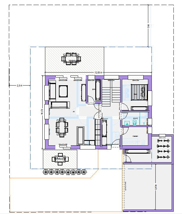

The carport is planned as a double carport on the south side adjoining the recess of the utility room. It is intended to be 5.5 m (18 ft) wide x 9 m (30 ft) long, including a storage room with a length of 3 m (10 ft). Is the planned width sufficient for two cars side by side assuming no SUVs? We plan to use a station wagon like a Skoda Superb and a small car such as a Mercedes A-Class or Toyota Leaf.
The carport positioning is planned as follows:
The house itself would be pushed fully to the eastern building boundary to maximize the western garden area.

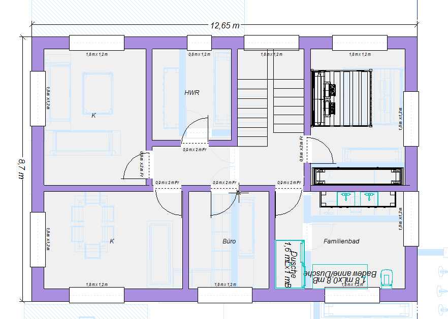

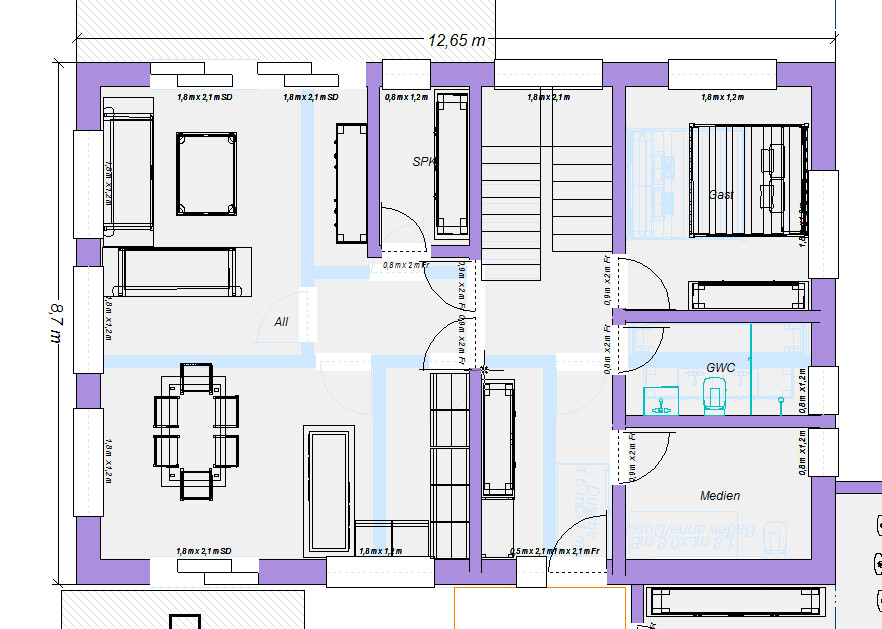

The current floor plan from the architect looks like this:
We have already considered some optimizations.
Central to our considerations is adding a second recess on the north side where the living room is, measuring 1 m (3.3 ft) long and 4 m (13 ft) wide, and including a laundry room on the upper floor to house washer and dryer.
This would allow reducing the size of the utility room on the ground floor significantly. We would shorten the utility room by 0.7 m (2.3 ft), leaving about 9 m² (97 ft²). The freed-up space would benefit the guest WC, guest room, and living room.
In the kitchen, we would like to extend the pantry fully along the wall and place the kitchen before it. We have tried to mark our ideas on the floor plan:
Is the kitchen large enough for a household of 3 to 4 people? An island solution will probably be difficult to realize, right?
Upstairs, the gained space from the recess would be used for the laundry room. In the plan shown below, we placed the study next to the laundry room; however, we have reconsidered and now prefer to position the work corner where the storage space currently is. The work corner doesn’t need much space, primarily just a desk about 1.60 m (5.2 ft) wide. If there is room for a small cabinet, that’s nice but not essential. Where we marked the study, we would instead plan a walk-in closet. Unfortunately, we have not found a better location for the work corner. We also considered moving it near the children’s rooms, but then the child bedrooms would probably become rather small (about 12–13 m² / 130–140 ft²). These will definitely be adjusted to the same size regardless.
Maybe you have some ideas.

SandyBlack11 Jun 2022 17:25So far, we like the floor plan best 🙂
The landing staircase is great. Would there be any objection to having a storage space under the stairs? Are the dimensions for landing staircases standardized? We need to check if our supplier offers a landing staircase with those dimensions.
Regarding the utility room on the ground floor, we also need to confirm whether it can be that small. The utility room upstairs is quite large, but I suspect all the technical equipment needs to be located on the ground floor.
If necessary, it might also be possible to extend the house by 30 cm (12 inches).
Upstairs, the utility room and the office are even larger than we need. However, we probably lack enough space in the bedroom for our bed and bedside tables. Our bed is 2.20 meters (7 feet 3 inches) wide, and our current bedside tables are 0.73 meters (29 inches) wide—though narrower ones are certainly available. But I think we would need about 3.20 meters (10 feet 6 inches) to fit the bed and bedside tables comfortably. That might already be possible if the house length is adjusted to 9 meters (30 feet) because of the technical room anyway.
I also like it very much!
However, something else occurred to me while reading (I’ll skip looking for the exact quote). If you sign a contract for about 110 sqm (1,184 sq ft) and are told that additional square meters cost a certain amount (I believe it was around €2,000), the main contractor is obviously referring to the same level of house features, for example, a house with 3 rooms and 7 windows. If you then plan for over 60 sqm (645 sq ft) more and end up with 2-3 additional rooms, each requiring its own windows, separate heating circuits, electrical installations, etc., the stated additional cost might not be accurate.
If I were you, I would check with the main contractor early on.
SandyBlack11 Jun 2022 18:16I think we were unclear about what we signed with the general contractor (GC), because you write that we would be planning over 60 sqm (650 sq ft) more. The mentioned 110 sqm (1,185 sq ft) that we signed with the GC always referred to the footprint – not the living area. Based purely on the area, Katja’s design would therefore almost break even. The approximately 2,000 euros more also referred to per square meter of footprint. The number of windows could of course vary and lead to additional costs. But if, for example, we lowered the knee wall from 2.80 meters (9 ft 2 in) to 1.80 meters (6 ft), we could save several thousand euros again. Due to the north orientation, I think this would make sense anyway.
But in any case, we will seek a meeting with our GC next week.
