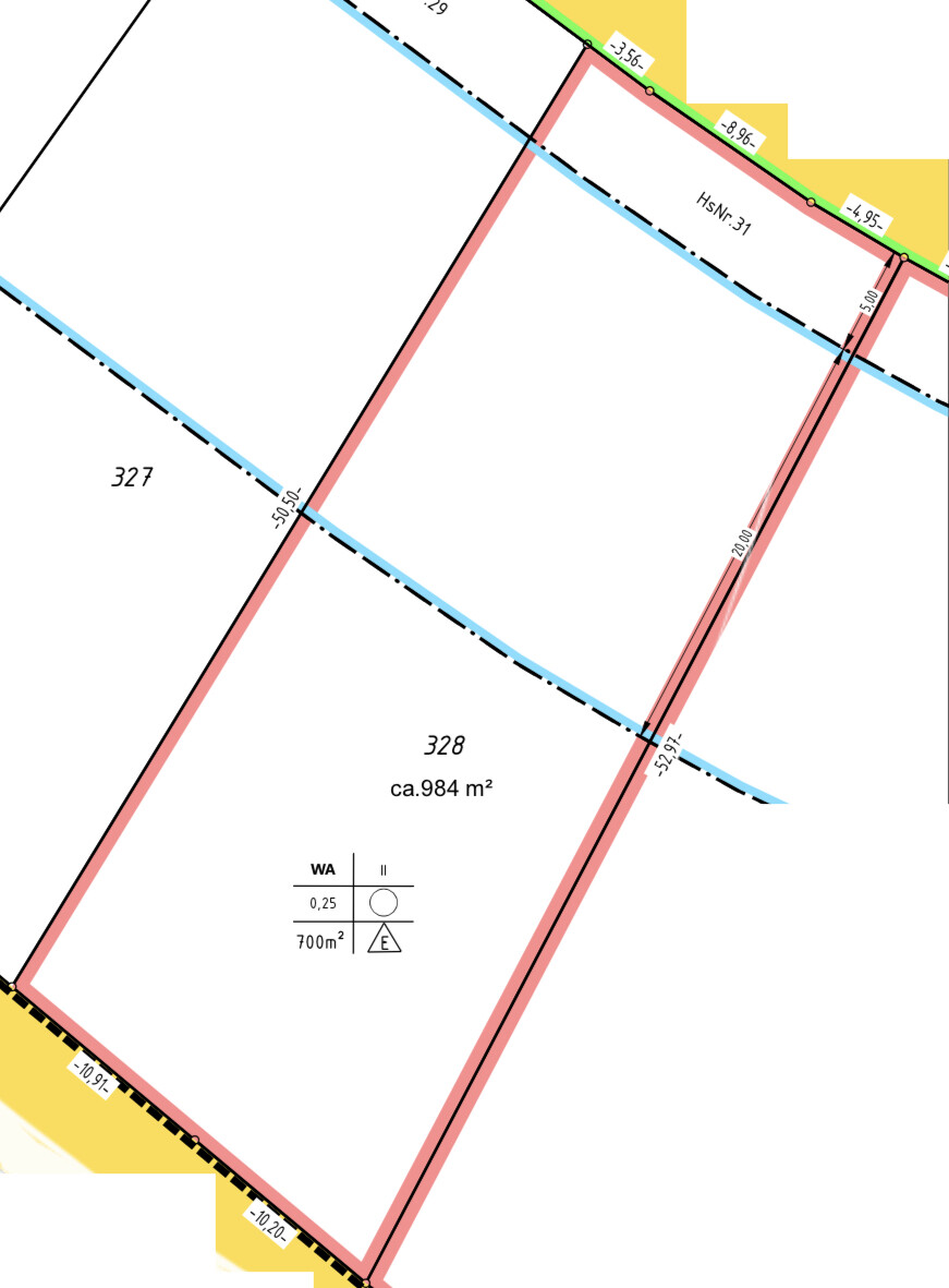

I don’t see anything that looks like a plot of land or a building envelope, neither crooked nor "simplified rectangular" (whatever that might mean).
ChristianZ6
25 May 2019 16:46
I don’t see anything that looks like a plot of land or building envelope, neither angled nor “simplified rectangular” (whatever that might mean).
Plot 328: outlined in red, approx. 984 m² (10,590 sq ft); adjacent to 327/31, blue curve (watercourse).

The building envelope continues over the neighboring plots, right? Please show the site plan WITH the building envelope.
ChristianZ6 schrieb:
I would like a double carport next to the house, but then the house can only be 9m (30 ft) wide, and so far I haven’t found a floor plan that meets the requirements.
… so there is a boundary development possible on the plot edge. That should be achievable.

Regarding the plot/building area.
The blue area marks the building zone. It has a width of 18 m (59 feet) at the front. Subtract about 6 m (20 feet) for a double carport in the edge development. On the other side, subtract 3 m (10 feet). That leaves 9 m (30 feet) for the house, as mentioned. But perhaps it is possible to make it wider again behind the carport in a sensible way.
