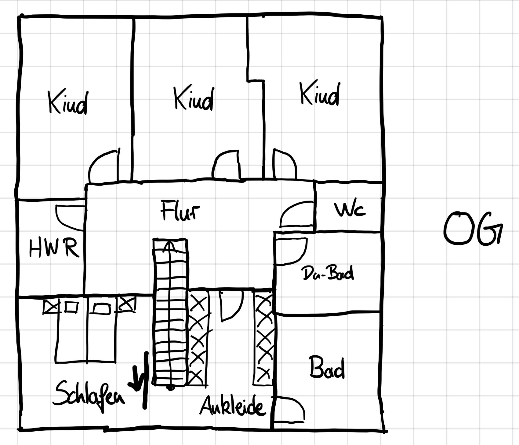

ChristianZ6
28 May 2019 12:23
Yosan schrieb:
Will the shower bathroom also have a toilet, or just a sink and shower? And will the toilet room also have a sink?
The toilet room will definitely have a sink, yes.
Whether the shower bathroom will also have a toilet, I honestly don’t know. Maybe it would be better to add a bathtub instead.
Edit: Regardless of that, I’m not even sure anymore if a separate toilet is necessary. There is also a shower bathroom downstairs...

J
j.bautsch
28 May 2019 14:02
I would suggest adding a door between the bedroom and the walk-in closet to create a quiet sleeping area, for example as a sliding door:
Floor plan upper floor: three children's rooms upstairs, hallway, utility room, WC, shower bath, sleeping area, walk-in closet, bathroom.
28 May 2019 14:03
ChristianZ6 schrieb:
Edit: setting aside the fact that I’m no longer sure if a separate toilet is really necessary. There’s also a shower bathroom downstairs...
That’s not what I meant. I was thinking of separating the toilet from the children’s bathroom... In my opinion, the kids can figure out the practical details of who uses the bathroom, when, and how. Being overly prudish can be excessive.
Anyway, there’s a lot of open space in the upper floor hallway... Also, you might want to reconsider the shower layout on the ground floor and definitely swap the toilet with the cloakroom so that the toilet can have a window.
However, I don’t see a clear, consistent plan in your considerations anymore. Have you visited any home exhibitions yet?
ChristianZ6
28 May 2019 14:58
Prudishness can be taken too far.
A lot of open space in the upstairs hallway...
Yes, and it’s dark. Maybe the wall to the utility room and kids’ bathroom could be made of glass blocks or similar to let in daylight (of course, not transparent).
Reconsider the shower on the ground floor.
I find it quite practical. Either as an option (a third shower for five people), guests have their “own” shower, or if someone is elderly or ill, they can sleep and shower downstairs.
Definitely swap the toilet with the cloakroom so the toilet can have a window.
Very good!
But I don’t see any clear thread in your thoughts anymore.
Yes, that’s right. In the end, I’m currently just in the trial phase: drawing, reviewing, discarding, redrawing, collecting feedback, revising, etc. Honestly, I don’t find that so bad.
Yosan
28 May 2019 15:02
Please, please no glass blocks... they are just so terrible
