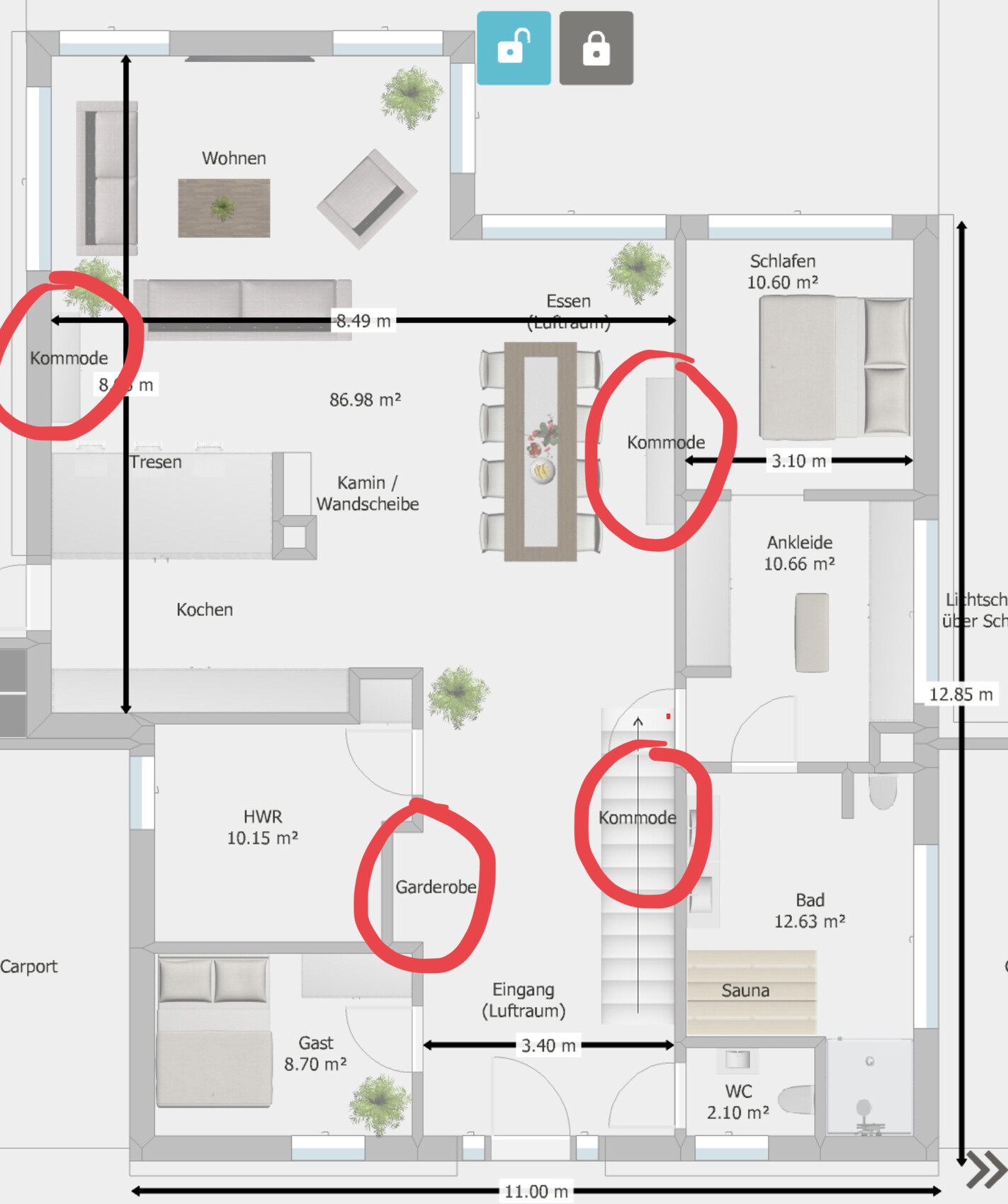

I’ve marked something on the floor plan. Should that be enough potential storage space?

So placing it on the right wall next to the dressing room should work. On the left exterior wall, it looks like it might be too tight with drawers/doors from the island and/or the sofa.
The wardrobe area is meant to be used as such, right?
Under the stairs, it’s hard for me to estimate how much space will actually remain next to the door.

The drawing shows the sofa is 1.50m (5 feet) away from the counter and 1.10m (3.6 feet) from the wall. Not a lot of space, but definitely enough room for a small chest of drawers.
Yosan schrieb:
Under the stairs, it’s hard for me to estimate how much space actually remains next to the door.
The staircase is 4.30m (14 feet) long. Only 60cm (24 inches) are taken up by the door, so there should be enough space left.
Otherwise, maybe removing a window on either side of the TV could create more storage space.
But honestly, do you really need that much storage in the living/dining area? I can’t quite understand it.
Kitchen storage definitely won’t be a problem (all lower cabinets will be tall units, total width over 4m (13 feet)) plus the 3m (10 feet) kitchen island.

Of course, you still need wall space to accommodate, for example, bookshelves, dressers, a children's play kitchen, a small child’s table with chairs, and a toy chest. In your case, this is quite limited in the room of over 80m² (860ft²).
