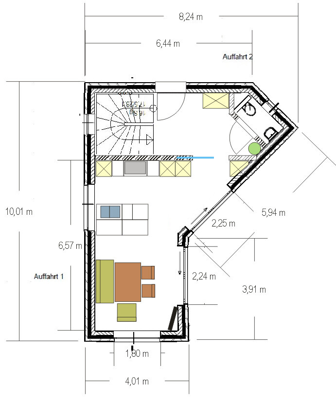

The planning of the kitchen including living area + windows (size, number, placement). Kitchen/living area should be open and cozy.

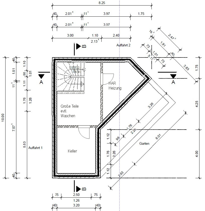

Detailed floor plan of a house with living area and garden
2D floor plan of a house with bathroom, living area and stairs, dimension lines
Basement floor plan with walls, doors, stairs and dimension lines.

I would have used the staircase as a room divider.
The delivery service doesn't need a lake view.
Upstairs, a window is missing on the sloped ceiling.

I also wanted to separate the hallway with a half-height wall, where a shoe rack could fit and there would be a shelf surface.
Where exactly and how is the staircase supposed to divide the room?
In the last design, I included a Velux window in the slope on the south side, but those are quite expensive, so I removed it again.
I think my idea of an open-plan kitchen is very minimalist. A counter where four people can sit is enough for me, so a bench and 2–3 stools opposite would feel cozy enough. It’s not that the bench has to replace a sofa for watching TV.
23 Dec 2018 21:20
So, when you say open-plan kitchen, you don’t mean a large dining table for 12 with an island, but rather a counter where your guests or you can sit.
Basically, a standing-height table with a bench and 2–3 stools. Or what do you mean by that...
Melanie L. schrieb:
a counter where 4 people can sit is enough for me, so a bench and opposite that 2–3 stools would feel cozy enough. It’s not like the bench has to replace a sofa for watching TV.
And for this minimal setup, you’re planning 20/25,000?
And regarding the sofa? Kerstin’s question seems to be causing some hesitation here: do you need a lounge sofa or not?
Watching TV and how that fits in terms of space haven’t been mentioned yet. TV is fine, but for cooking? Relaxing?
I always find such projects good and interesting, but with the typical family’s words, “and in the open living area, we’d like a corner where the child can play and I can iron,” I would have absolutely nothing to do with that 😉

@Melanie L. here’s how I would do it 😉.
Basement ... heating room towards the street side .. and you can already see the staircase has shifted.
Floor plan of a basement with heating room, stairs, and garden area
On the ground floor, an entrance area with a wardrobe closet, a toilet above the heating room, a small decorative niche, and a partition wall with a glass sliding door separating the living area.
2D floor plan of a house with living room, kitchen, and spiral staircase
Kitchen with the cooktop integrated into the tall cabinet wall and a nice preparation island. Tall cabinets from left to right: raised dishwasher, cooktop space, oven tall cabinet, and finally fridge. In the right corner, possibly a custom unit for decoration or rarely used items.
Then a dining area with a modern kitchen sofa and kitchen armchair, table approx. 100x150cm (40x60 inches), TV located at the bottom right corner of the plan.
I would make the terrace access wider than 176cm (70 inches), otherwise the sliding door won’t function well.

Has the site development now been clarified? Where do you get water and wastewater from, and where is the entrance to the property?
kbt09
23 Dec 2018 21:54
kbt09 schrieb:
From which direction will the house be connected to utilities? From the east, the right side of the site plan?
@ypg ... I had asked the same question before 😉 Based on the road layout, I assumed the right side of the plan:
that’s why I positioned the technical room on the right, so that the connections are not built over ... for example, by the labeled driveway.
