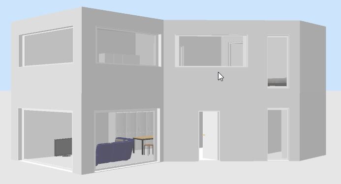

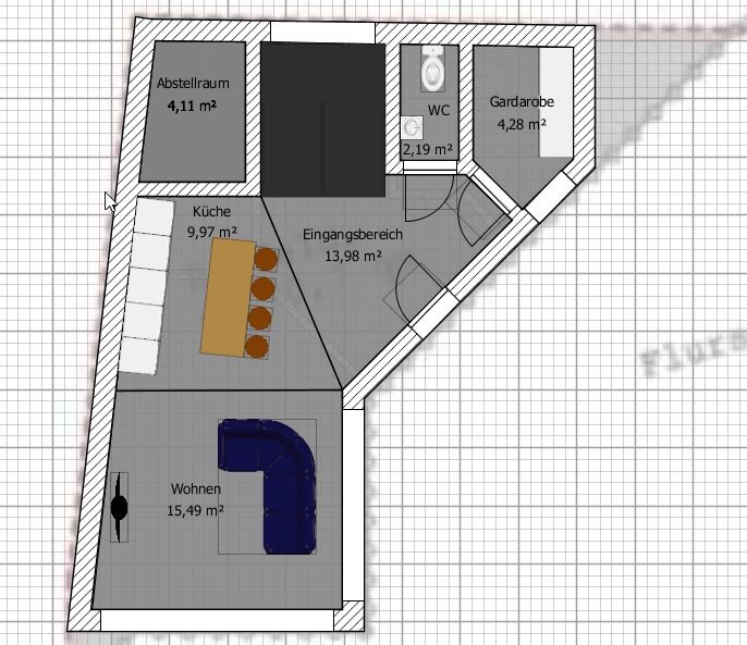

I wouldn’t do it entirely without room dividers either.
I took about half an hour to think it over.
This is roughly how I would try to realize it.
Important rooms should always face south to take advantage of the sun. Windows should also face the sun.
Since money is not an issue for you, I didn’t exactly skimp on window area.
Southeast view. These are the window areas.
Fewer windows on the east side.
Small kitchen with a small island that is also used for dining (although I would rather eat on the sofa). Stove and refrigerator along the wall. Dishwasher and sink integrated into the island. Everything unnecessary goes into the storage/utility room.
A cloakroom would be important to me so that shoes and jackets aren’t scattered everywhere.
Living room and the view clearly facing south.
There isn’t much to say about the upper floor; it’s self-explanatory. The guest room could be a bit larger, but then the large and inviting window would have to be smaller.
I didn’t consider the basement level. I would place the garage on the north side so the southern part of the property remains free for barbecue, garden, etc.
If we knew what your priorities were, it might be possible to tailor the design better to your needs.
For me, the living room and bedroom are the most important, hence their prominence.
I hope I was able to help or at least provide another perspective.
