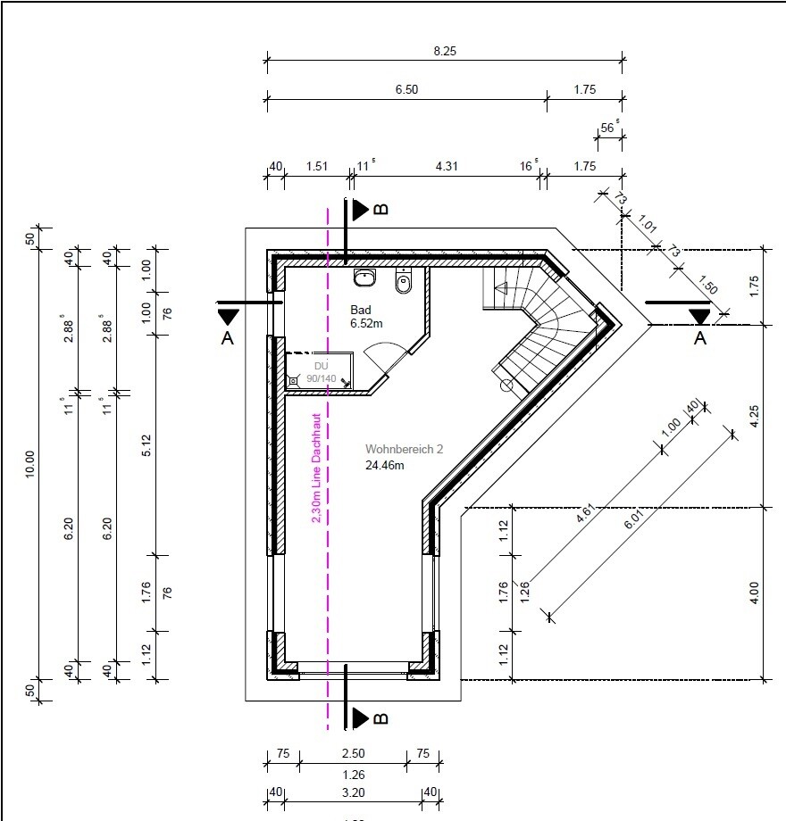

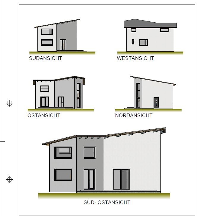

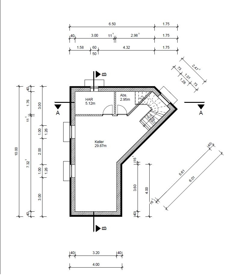

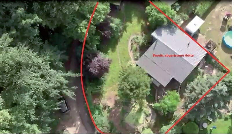

I purchased a plot of land mid-year, where a roughly built wooden cabin once stood. I have already demolished and removed it.
By early December, I was almost finished with the planning, and last week I showed the plans to my family at a pre-Christmas gathering. Naturally, not all 12 adults agreed with my views. Unfortunately, I’m already mentally fixed on my plans, and it’s difficult for me to rethink everything from scratch now. I’m hoping to find ideas and inspiration in this forum.

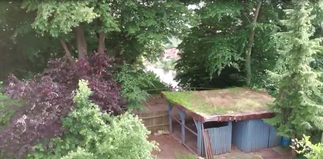

The view of the lakes is unique; in summer we flew a drone over the area, and in winter you naturally have an even clearer view of the lakes!
I’ve completed the questionnaire to the best of my knowledge.

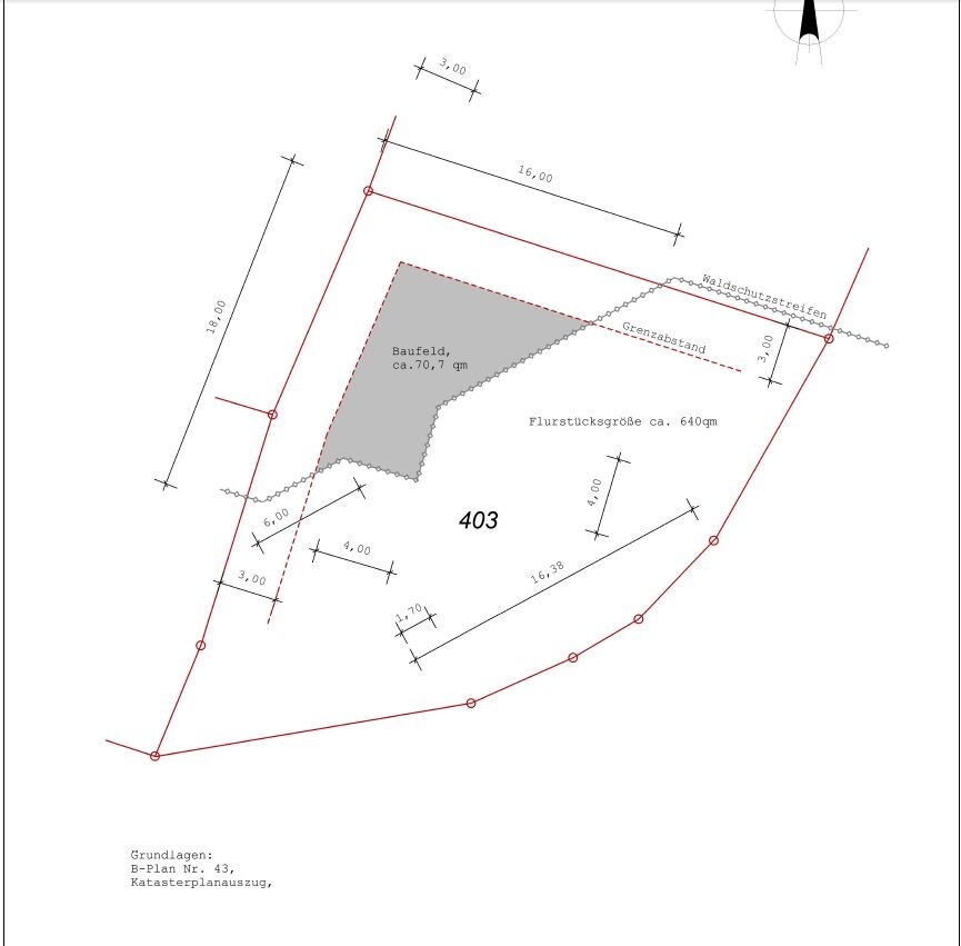

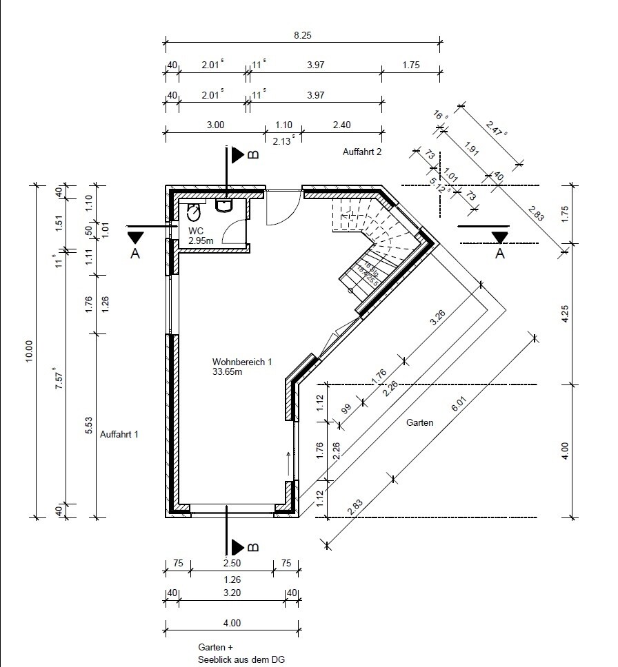

- Plot size: 640sqm (6889 sq ft)
- Slope: none
- Plot ratio (site coverage): 0.09
- Floor area ratio: 0.13
- Building envelope, building line and boundary: 3m (10ft) from neighboring plots, and the forest protection strip must be observed; 55sqm (592 sq ft) building footprint; parking space (carport only, no garage) outside the buildable area 20sqm (215 sq ft)
- Edge development: see site plan
- Number of parking spaces: 1
- Number of stories: 1.5

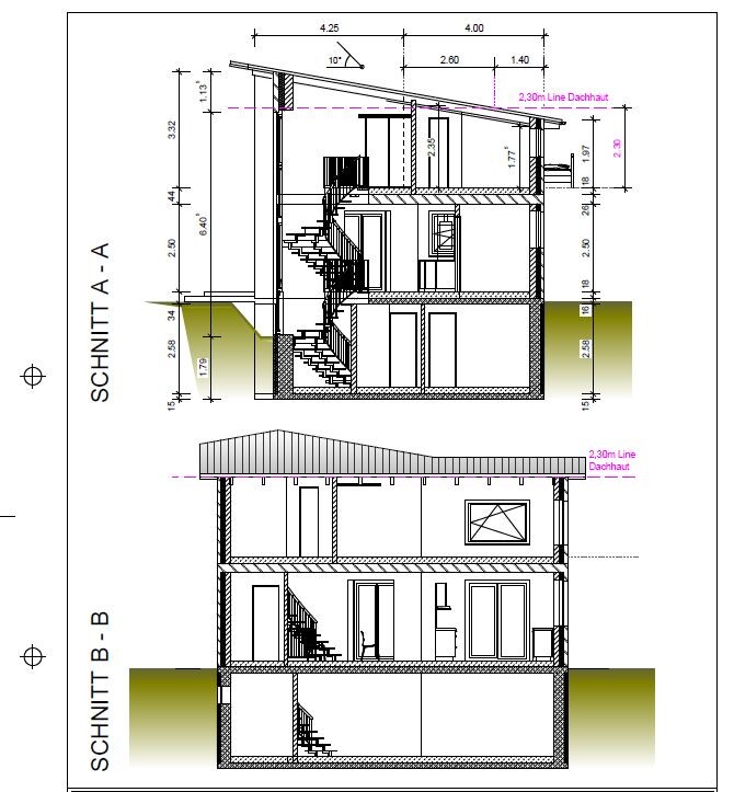

- Roof type: gable roof or shed roof; neighbors have built flat roofs as well. Considering the number of stories, the ceiling height had to be lowered to 2.30m (7 ft 7 in) at one third of the height.
- Maximum heights / limits: 8m (26 ft)
- Other specifications: building plinth must not exceed 0.35m (14 in)

- Basement, stories: basement + 1.5 stories

- Other wishes: an open kitchen/living area is desirable (for info: I budgeted 20-25 thousand euros for the kitchen). It would be a plus but not a must to fit a TV somewhere on the ground floor. The floor-to-ceiling windows will all be sliding doors as I prefer level access to my terrace. This terrace will extend a bit further south than currently shown on the plan. On the upper floor, I plan a bay window seating area; on the ground floor, that would also be welcome.

- Standard design from planner: no, due to the restricted building field; the maximum buildable footprint is 55sqm (592 sq ft), with 1.5 stories

Thanks for the tip. As you can see, I am also planning for a higher amount. But the total construction cost is not really "the problem." Please don’t worry so much about my money—I can handle that myself, or rather my financial advisor can. :-)
Is this going to be a weekend house? And why are there no interior walls yet— is that part of the planning still missing?
I’m not quite sure yet how you plan to proceed from here.
The price should be reasonable since there is no garage or exterior work included, and the (holiday) house is a tiny house.
This will be a single-person house, a permanent residence. I am very comfortable with the number of square meters, as I currently have much less space in a smaller townhouse without a garden.
Where would you recommend placing the walls?
As mentioned, price is not an issue. If anyone has specific design ideas, that would be very helpful.
