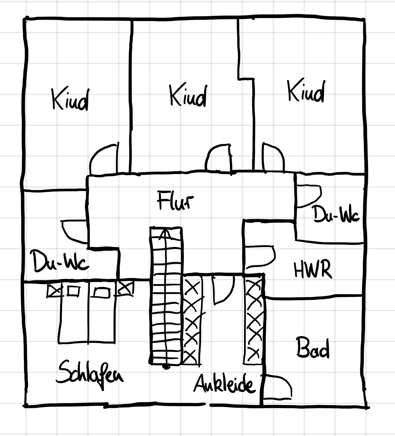

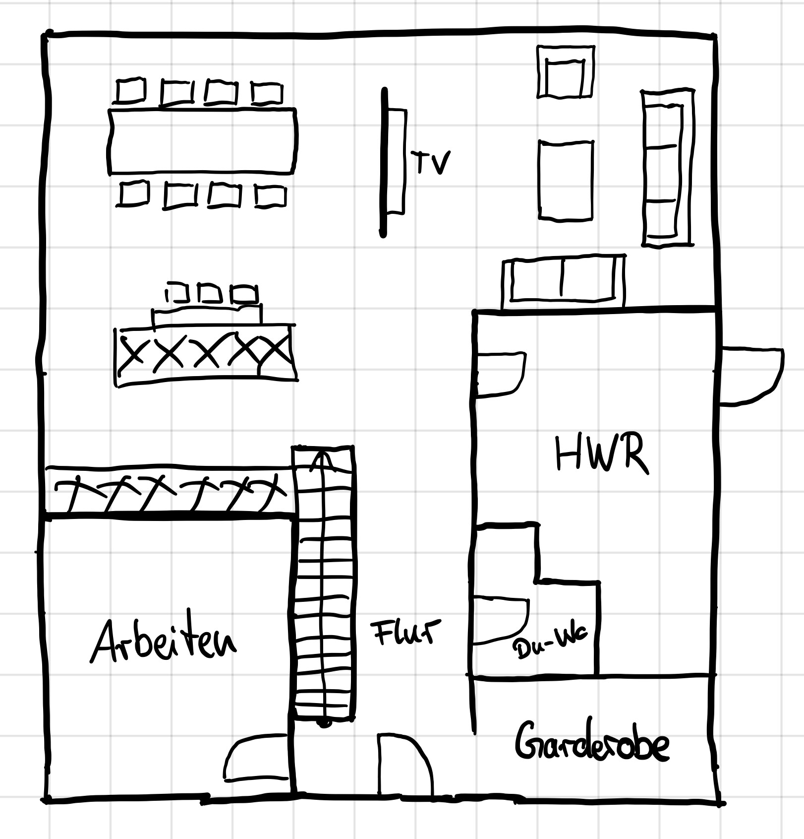

We are in the process of planning a house for our family. We already have two children (5 and 1.5 years old), and our third child is due in November.
We have put a lot of thought into the floor plans and now have a design we are very happy with. However, since you eventually become blind to your own creations and we have no experience in house construction, I’m hoping to get some great suggestions here.

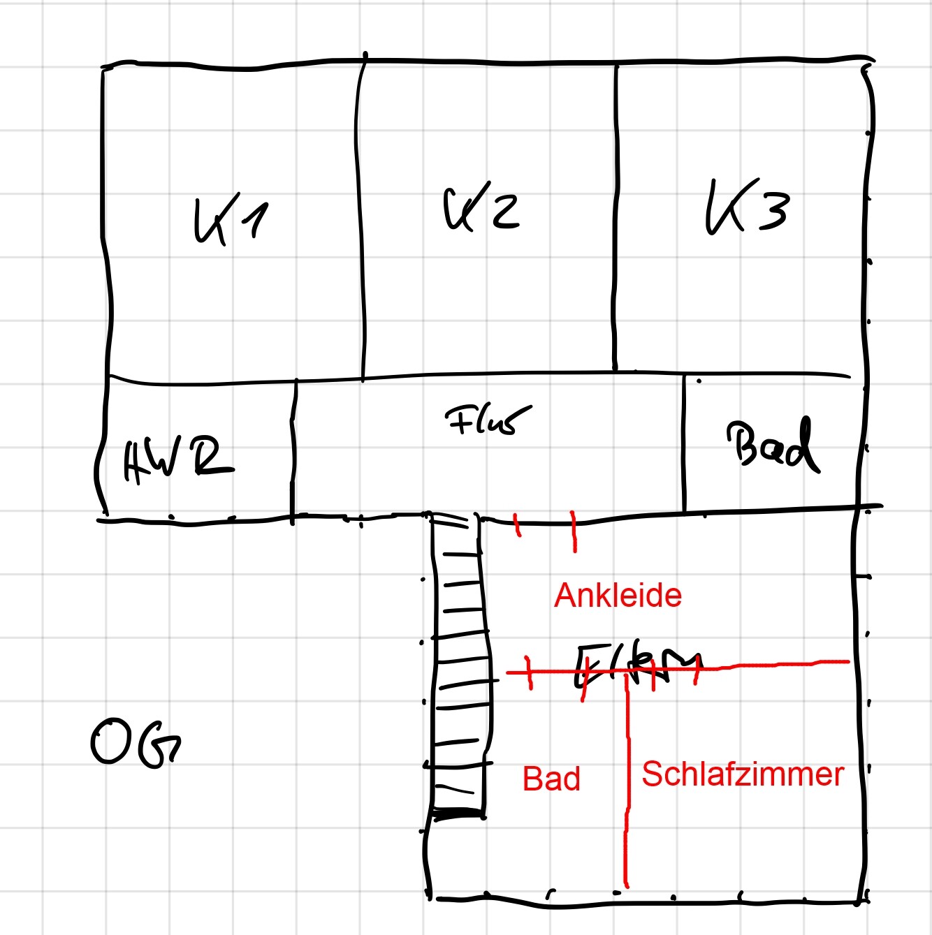

ChristianZ6 schrieb:
And you loosen it up by
moving the upper floor wall a few centimeters (how many) away from the staircase, creating a kind of small open space? No. One is an open space, the other is a stairwell opening.
I am referring to a closed stairwell opening, which you drew and which feels cramped. The other is a hallway on the upper floor with a railing. The first is also built, but usually only when every square meter needs to be used upstairs.
Flared pants and platform shoes have become fashionable again among people who didn't experience them originally in the 1970s; the same goes for mezzanines and galleries, except those were trendy in the 1980s. In the 1990s, two new suit trend colors appeared: blackberry (which is making a comeback as a wall color) and mint (hopefully not).
Leave the mezzanine as a gimmick in the attic.
ChristianZ628 May 2019 02:12ChristianZ6 schrieb:
Attached are 2 ideas.And a third option: maybe the shower fits into the recess behind the stairs...
ChristianZ628 May 2019 08:16Yes, that should work as well, thanks!
