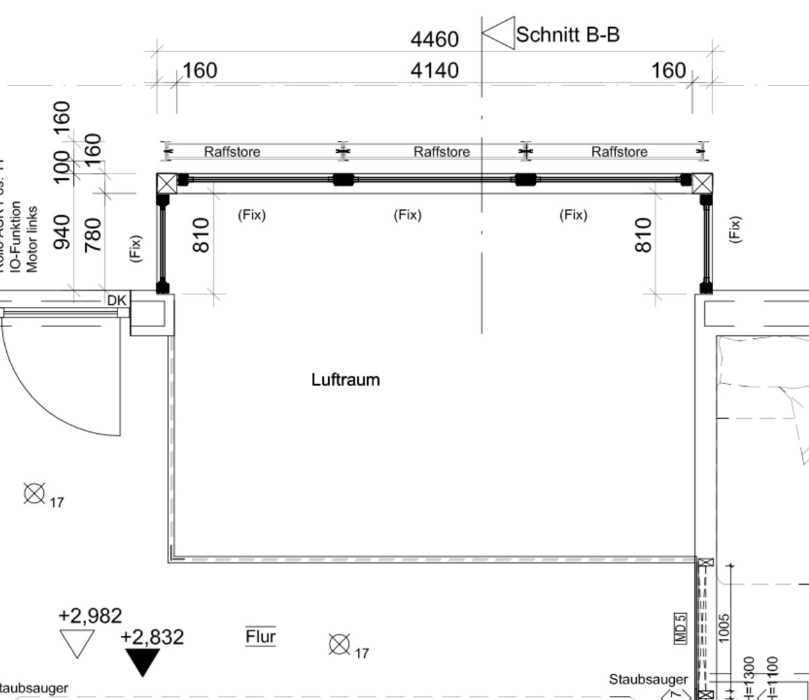

Hello!
We have an open space of about 12 square meters (130 square feet) in the house and would like to combine comfort with functionality by installing a net similar to those used on catamarans (see picture). However, one of the long sides borders the conservatory, so the net cannot be attached there. We are considering a metal frame to which the net would be fastened, with the frame only screwed into the remaining opening area (timber frame construction).
Has anyone already done something like this? One company gave us only a standard response regarding mounting, and we are still waiting for a reply from another company. Any tips or advice would be greatly appreciated!

I find the idea very interesting and think it’s a pity that most comments here are just opposing it instead of providing helpful advice.
Concerns are of course useful as well! But I assume you have already done enough research beforehand?
Personally, I would also talk to a metalworker who can build the frame for you. The mounting on the other sides (not the conservatory side) must also be checked for sufficient load-bearing capacity.
Try to find reference projects nearby through the internet.
